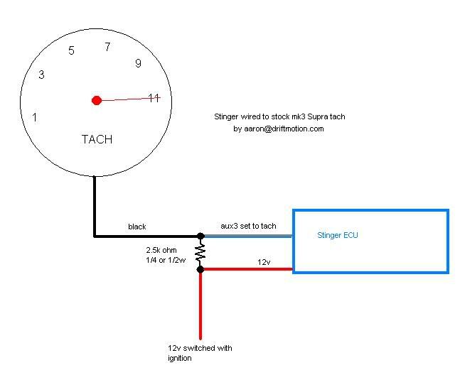

bigaaron;1052474 said:
Hey Aaron,
What's the purpose of the resistor?

IJ.;1142579 said:
That's a pullup/down Mark.
I thought going on my brief play with the Stinger SW yesterday it had onboard resistors that you can switch?
I thought so too, I'll have to dig around to find the correct answer.
