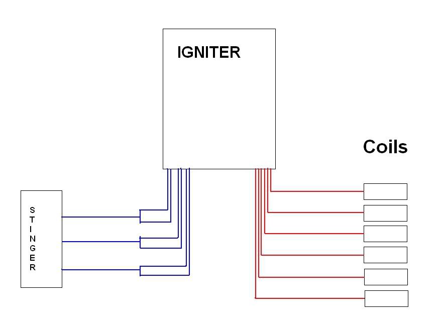

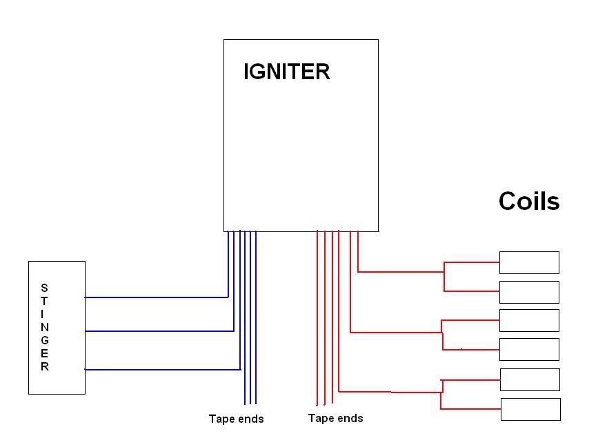

Which way do I wire up a 1jz igniter? Do I tie the coils together for wasted spark before or after the igniter?
Before:
After:
