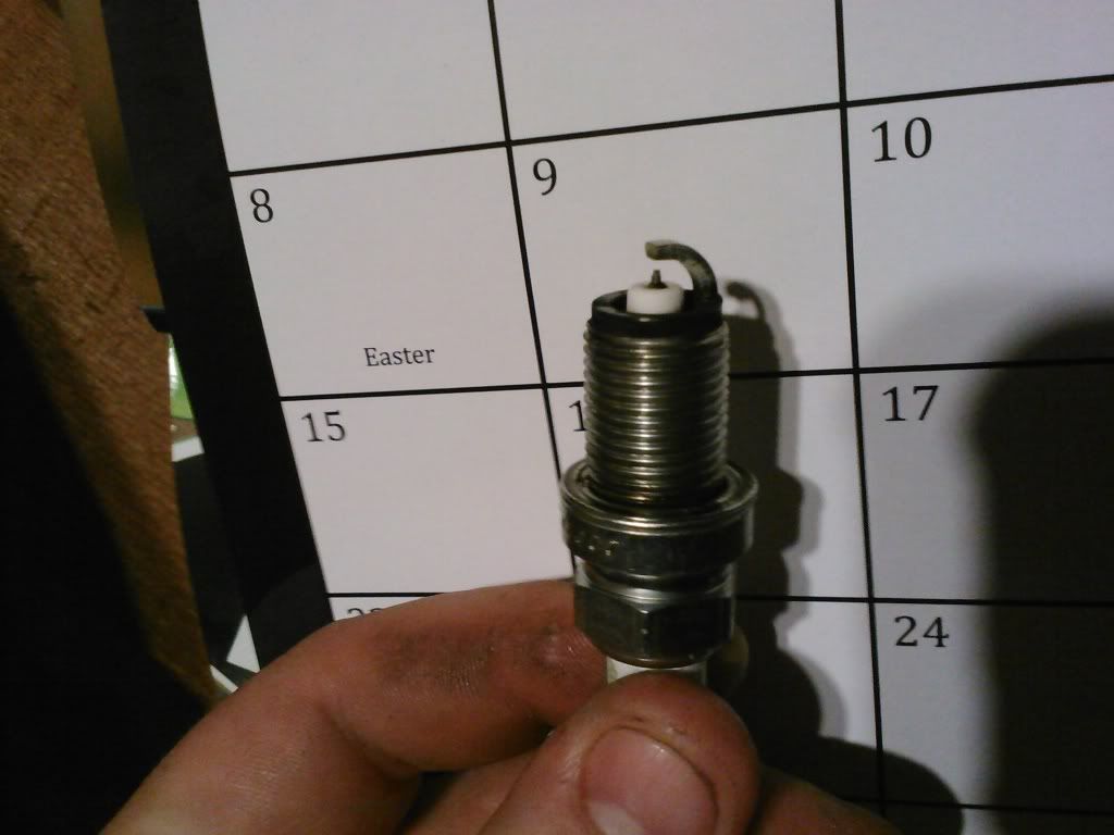

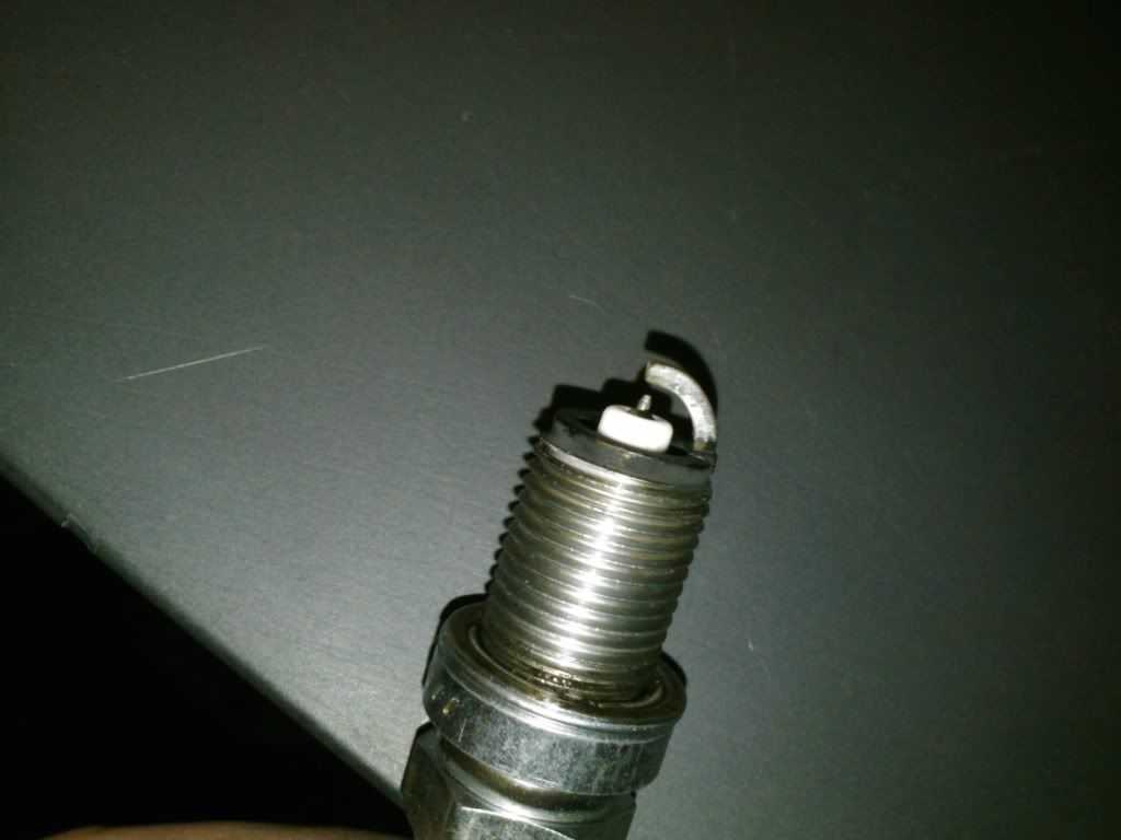

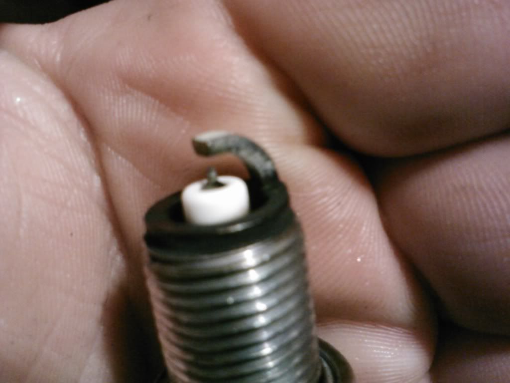

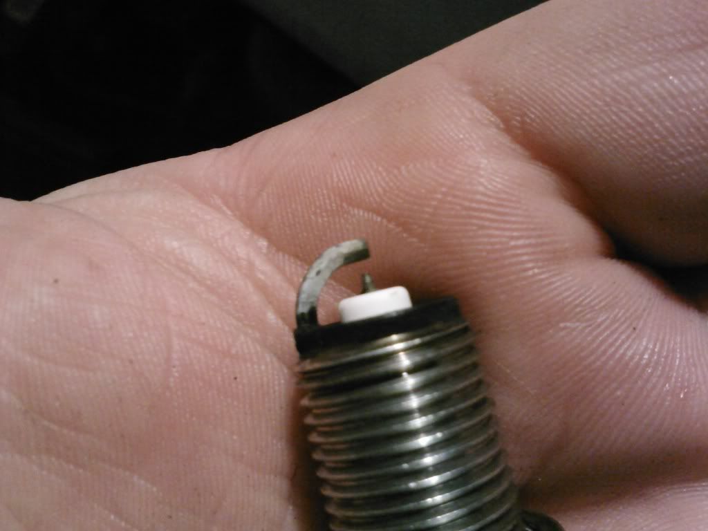

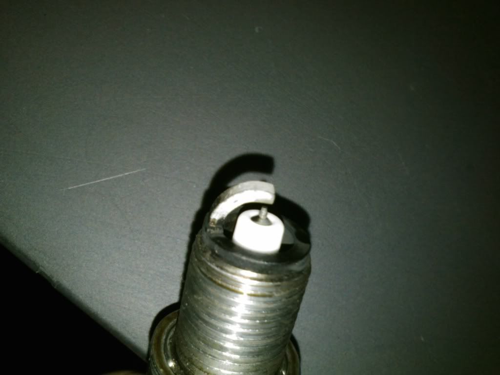

Might be due to the flash but looks like its running a little hot (white) to me. I would say that cylinder is not pulling oil. From what I have seen turbo seals are a pretty common issue, has anyone been behind you when in boost to see if it smokes during?
