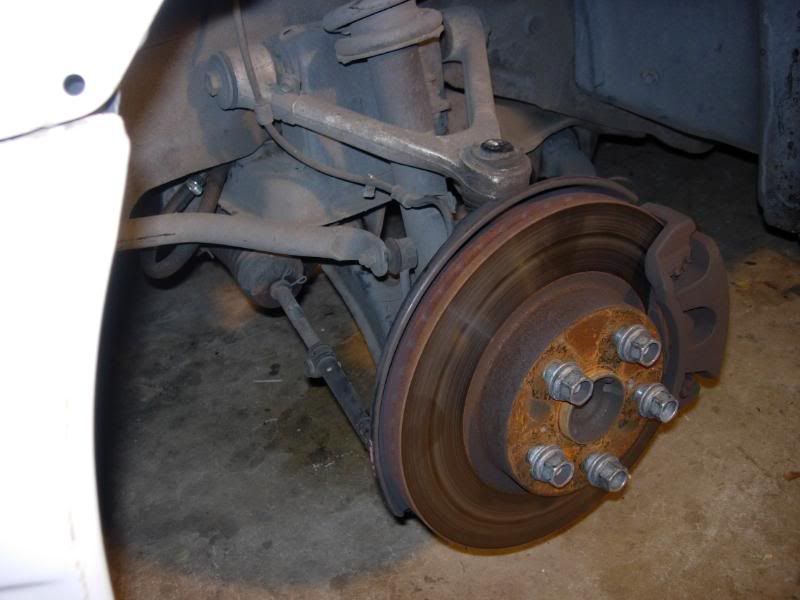

Step one, obviously, remove the wheel.

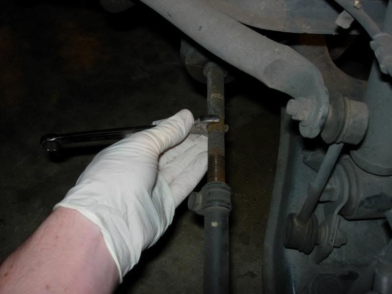

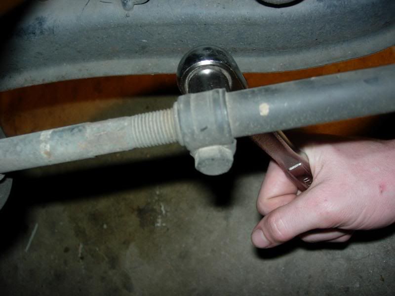

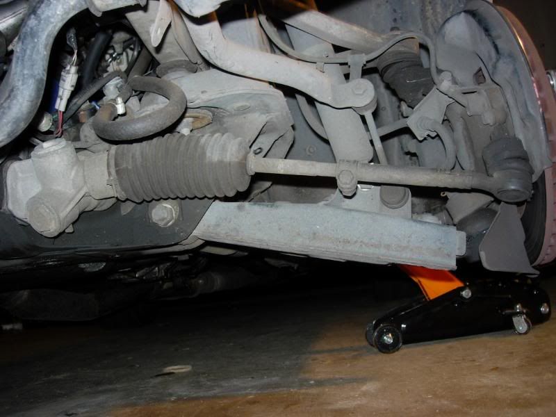

Loosen the clamp on the outer tie rod sleeve

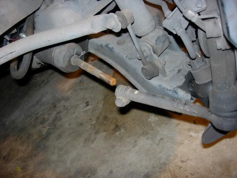

Unscrew the inner tie rod from the outer tie rod

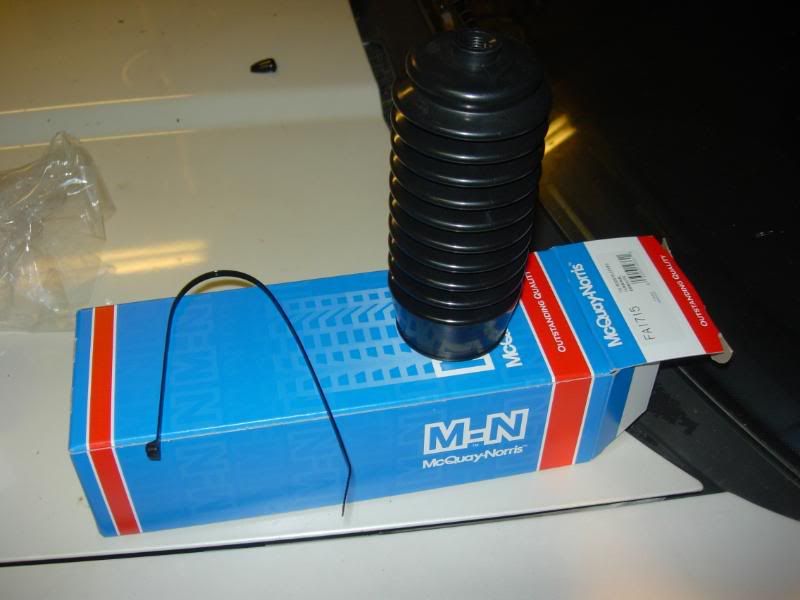

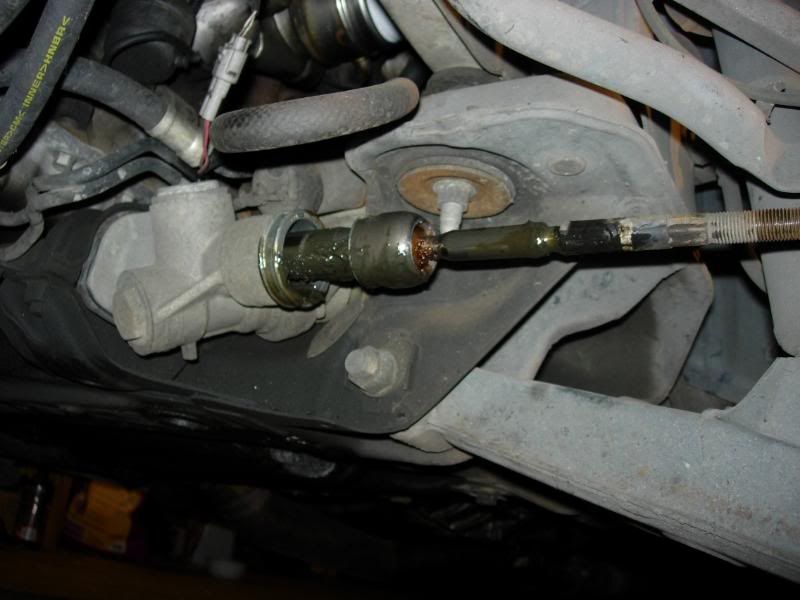

Remove the dust boot

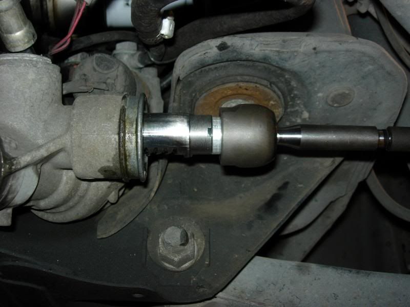

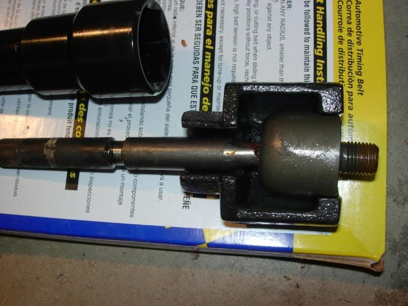

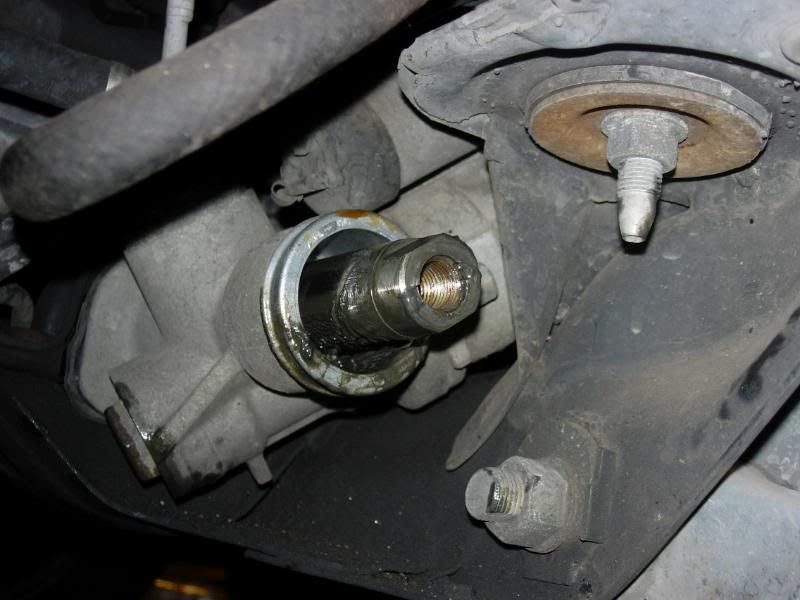

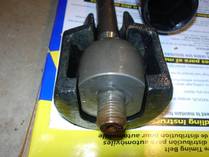

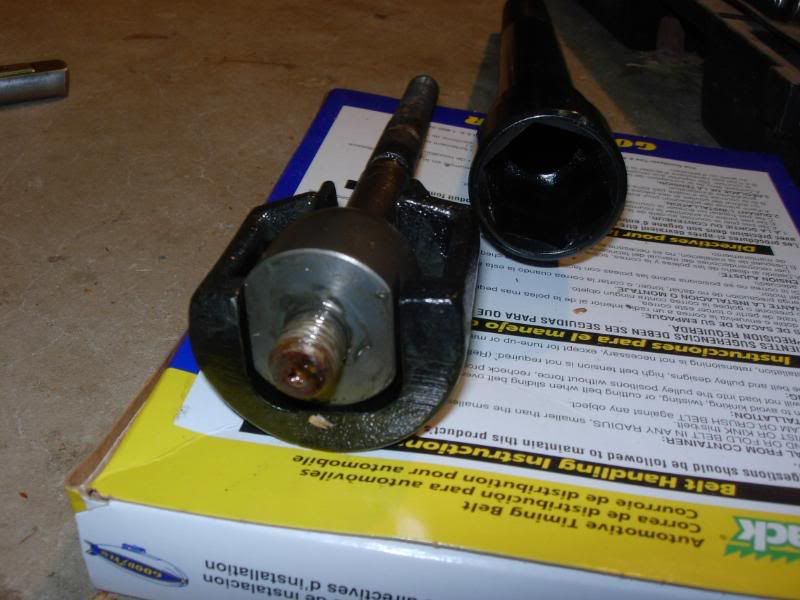

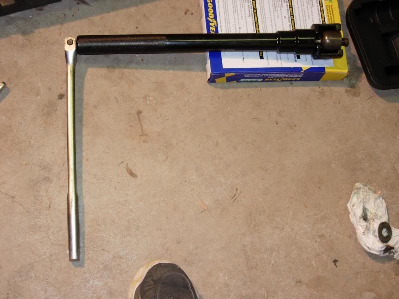

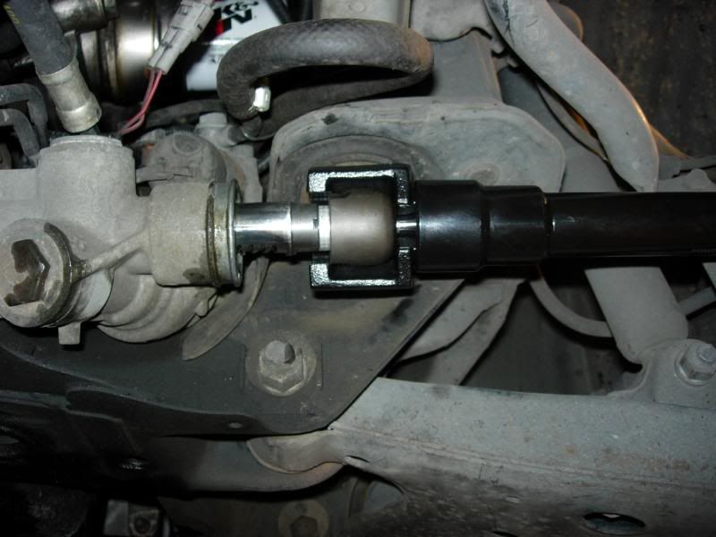

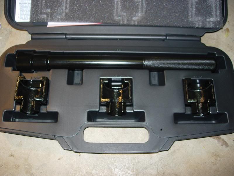

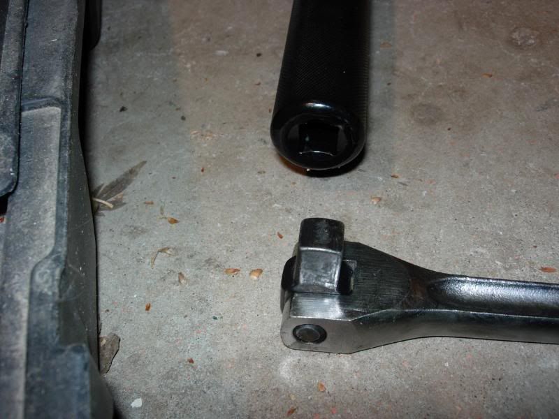

Using our special tool, remove the inner tie rod from the rack

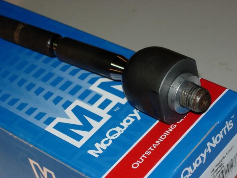

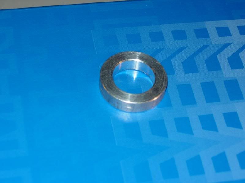

Thuroughly clean the tie rod. Brake cleaner and a towel works great! Notice how the old tie rod almost looks like new? Install the spacer over the threads of the tie rod.

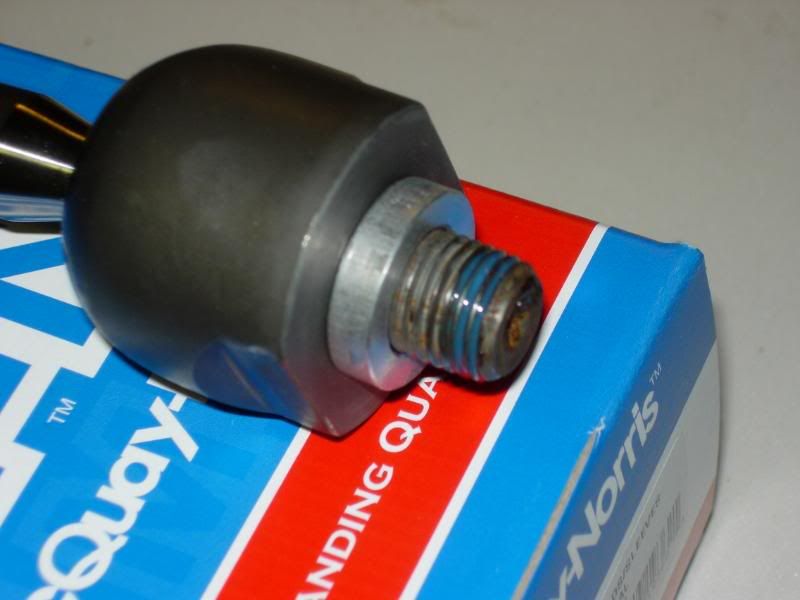

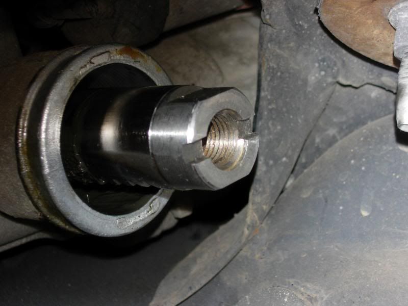

Thuroughly clean the threaded portion of the steering rock. Apply thread locker to the tie rod end. (I used medium strength with a breaking point of ~115lbs on a 3/8" fastener.) Reinstall the tie rod end in to the rack and tighten with tool.

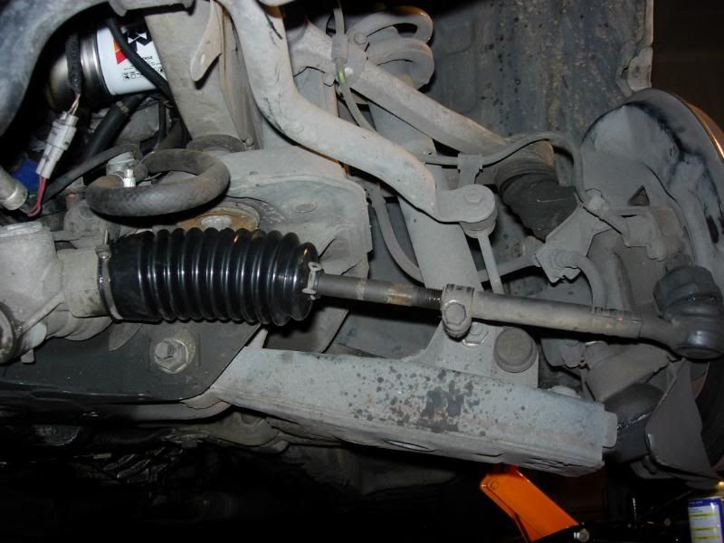

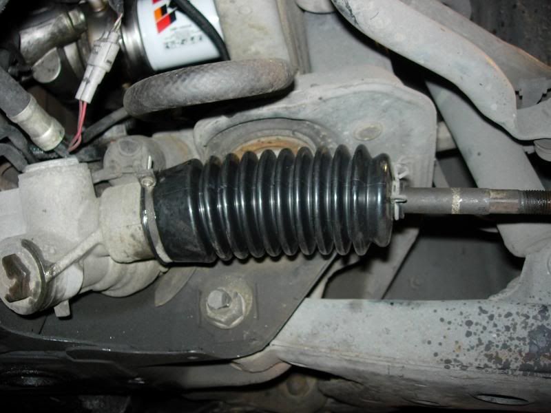

Install dust boot. I bought new ones as the old ones were dry and rotting.
Thread the inner tie rod end back into the outer tie rod and adjust the toe angle. (I applied a small amount of WD40 to the tie rod adjusting threads to help prevent them from rusting stuck in the future.) While making sure the steering wheel stays straight, line the front wheels up with the rear. This gets the alignment close enough for a test drive to better adjust it yourself or to take it to a shop.

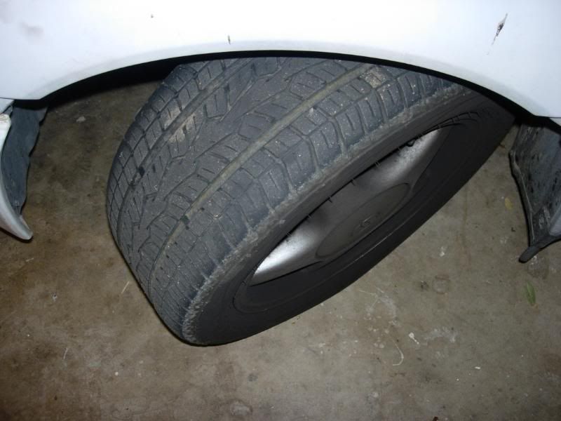

Before:

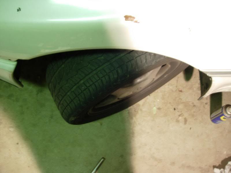

After:
Sorry about the quality of the last two pics...
Hope that helps guys! Thanks to Wiisass for providing the MKIII community with another awesome mod, and thanks to Kragen for a kick ass tool!
