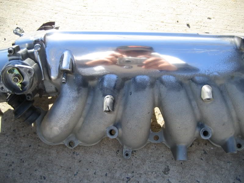

Here's a new look.
1. Polished thermostat housing
2. Polished (Semi) Intake manifold
3. Painted center taillight trim (What was white)
4. Polished throttle contraption
5. Polished tranny cable contraption (Don't know the name, but it looks cool hahaha)
6. Deleted cruise control (Line was cut anyway)
7. Painted strut bar side pieces black
[Note all this work was in one day, so NO COMPLAINING!! (please!)]

Hey if he can get it looking anything like mine, than you won't have to worry about it being better than Jay's! As far as being better than mine, well them tiny little hands are really gonna have to work hard, but he was there when I was putting the finishing touches on mine, so he definately knows how! And shoot, I stopped at 2000, he has 4000 now, so I don't think you will have anything to worry about. As long as that texture on the IM doesn't get to him. Haha. Haven't worked on mine since we were at Jay's, still got to finish the back part.
The throttle body on the other hand I did do, but I need some different polish, it doesn't shine like the IM.

Here's how I'm polishing the parts, if you're interested (I'll send you a PM), I'm polishing parts for nearly the same cost it would be for me to polish it.
1. Clean parts with engine degreaser if needed
2. Start out removing paint and aluminum texture with a rough grit (60-80) until smoother and paint is gone
3. Take medium grit steel wool to the surface until the rough scratches are out
4. Sand with 220, 400, 800, 1,000, 2,000, 800, 1,000, and 2,000 in that EXACT order. If still not like a mirror, repeat the 800, 1000, and 2,000
5. Take polish to it with a buffing wheel, dremel, or by hand.
This process can take around 20-200 hours depending on what you want, and how you want it to look. Just that one piece of the manifold took WELL OVER 35 hours.
