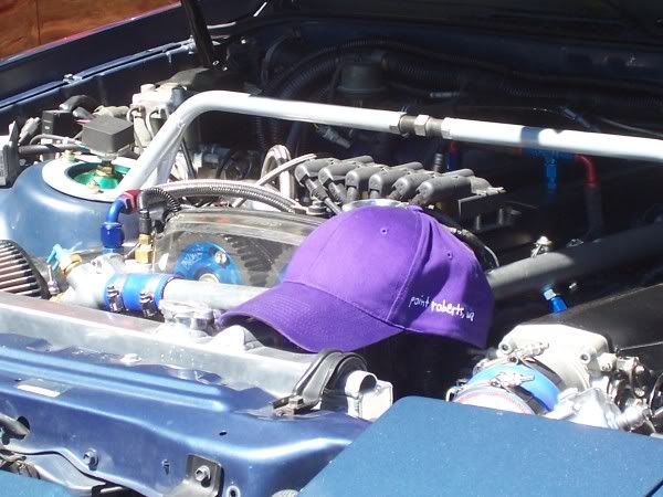

This is what duane should of done with the barney hat and block woot woot
Who owns this engine????
