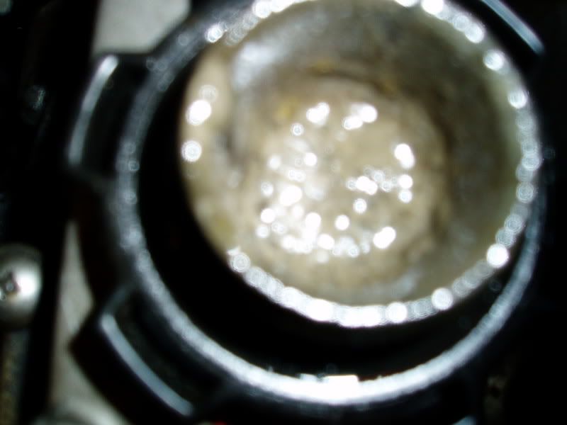

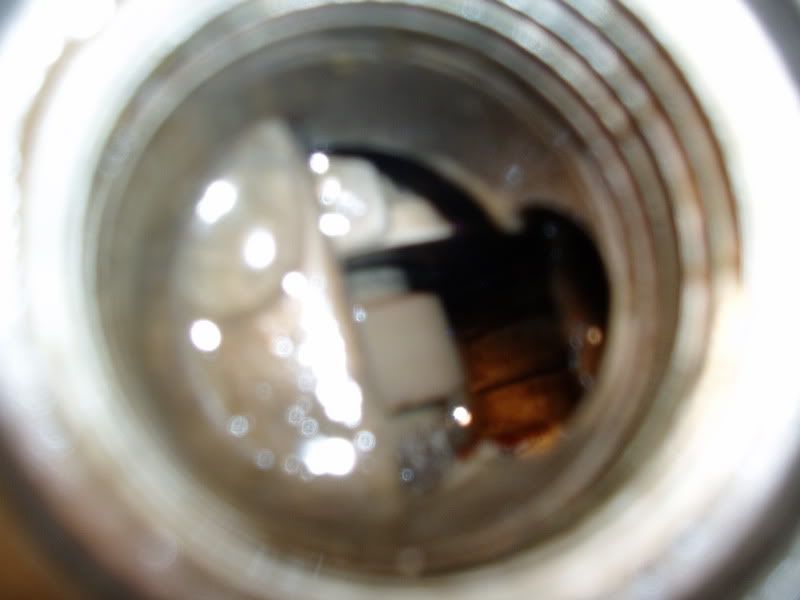

Well I suspected that I had a BHG. The car was overheating and losing coolant, constant steam from the exhaust, although not much. So I parked the car and today I did a compression test and I was expecting to see a large difference in the compression #'s but the numbers came out like this
1 -- 160
2 -- 150
3 -- 150
4 -- 155
5 -- 140
6 -- 160
But when I took the oil cap off it was milky in the top of the cap and on the part of the cam that I could see.
Here is a pic of the cap. (sorry the pic is crap but you get the idea)
Here is one of the cam lobe.
But the thing I found strange was that it was milky when I took the oil cap off but it was fine when I check my oil with the dipstick? Is that normal. So my question which I'm pretty certain I know the answer to is do I have a blown headgasket or is there anything else that it could be?

That concerns me... Pull the head... Its time for an MHG and ARPs....
If I do end up having to do the HG job, which is pretty clear that I will have to do it will have to be stock toyota gasket with ARP headstuds as I don't have the resources or the funds to pull the engine and get the block prepped properly for a MHG.

head gaskets blow in all sorts of ways. I never did a compression check on my #6 when it blew, but I know it still had to have been good, as the engine functioned with full power like nothing was wrong.

Get a cometic mhg, they are pretty forgiving... make sure the head is straight, clean the block surface, cometics will hold... And you can get one for a good price...

I would definately remove the engine and tear it down.
Thats weird. It looks a lot like condinsation (sp?). I have an oil spill under my car right in the garage now that looks milky.
It was a very wet day today and I slide under my car to unbolt the engine mounts, and I noticed it all milky.
Anyway, that much water in your system is a pretty bad thing.
