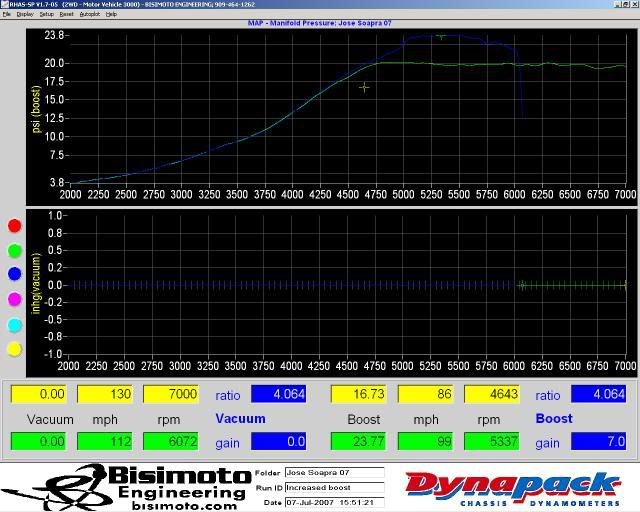

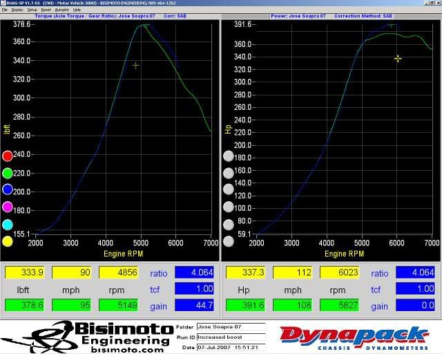

The new engine is low on compression on No. 6. I dynoed the car with a little AFC tunning and here is what I got...
I was going to shoot for 25 PSI but the fuel started to lean out. Mods are, 440cc injectors, Stock head and stock block, stock fuel rail with DM AFPR, MK4 Fuel pump and HKS Twins. the car feels great, but I need to adjust the boost crontroller to get better boost response.( I hate the Profec B II! ) I guess These numbers are not bad numbers for junkyard engines! I want to Dyno again with C16 and turn the boost up some more! :naughty:
Here are some high res pics of the dyno sheets.
