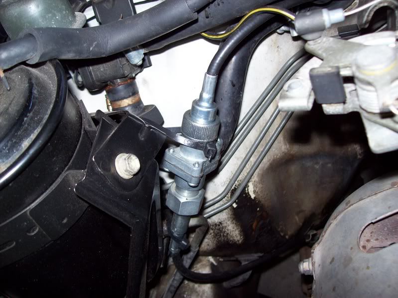

Since Toyota trannies don't have replaceable driven gears for the cable like American stuff then the ratio box is the only option. There's like a hundred or more different ratios that can be made with the gears available, so even with way different gears and tires the speedo can be made accurate. There wasn't clearance with the crossmember to mount the box directly to the transmission, so I made two new cables to locate it in the engine compartment. I'm not sure about R154 or automatics. It's best to have it as close to trans as possible to avoid the speedo pointer bouncing at low speeds. Which brings to the next point: bouncing speedo pointer.

Here's the pic of my ratio box zip-tied to the charcoal canister.
