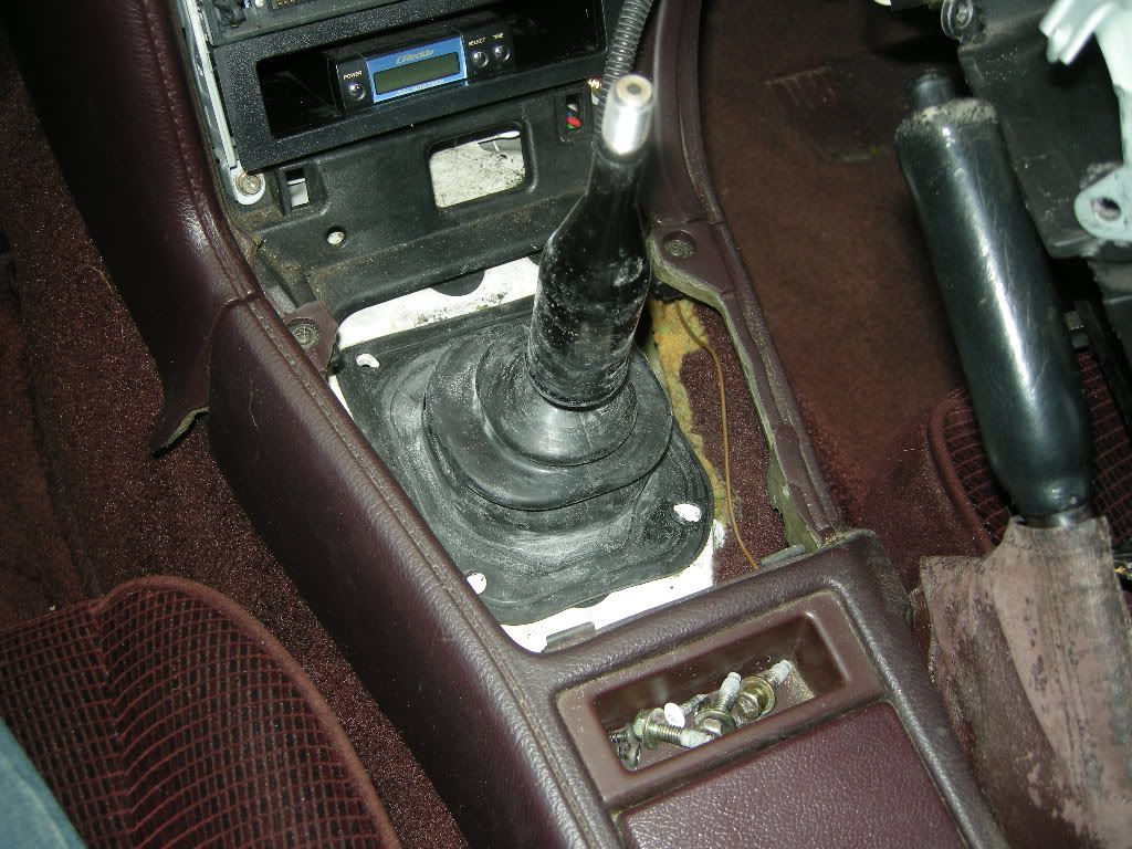

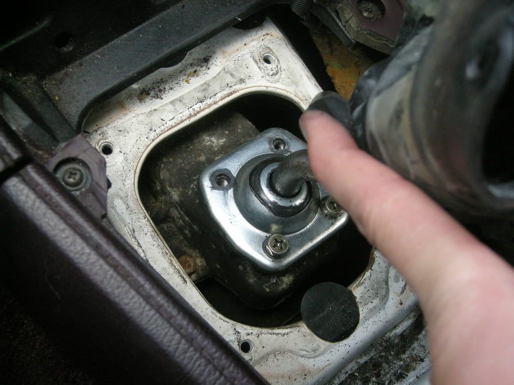

I pull the boot off to discover I only have two of the bolts holding the rubber boot-plate on. This isn't a good start. (I took this picture after I removed the two remaining bolts).
Pull up a couple more covers and I discover this. Looking at the plate shows me four holes, but there are only two bolts. The picture doesn't show it, but the two that are left have backed out so far that a half a turn removes them.:aigo:
So I fixed the problem by replacing all four bolts (and also the four holding down the boot cover) and tightening them properly and now the car shifts better than it did the day I bought it. I also made sure to use four of the same so that I don't need eight different tools the next time I have to remove them.
