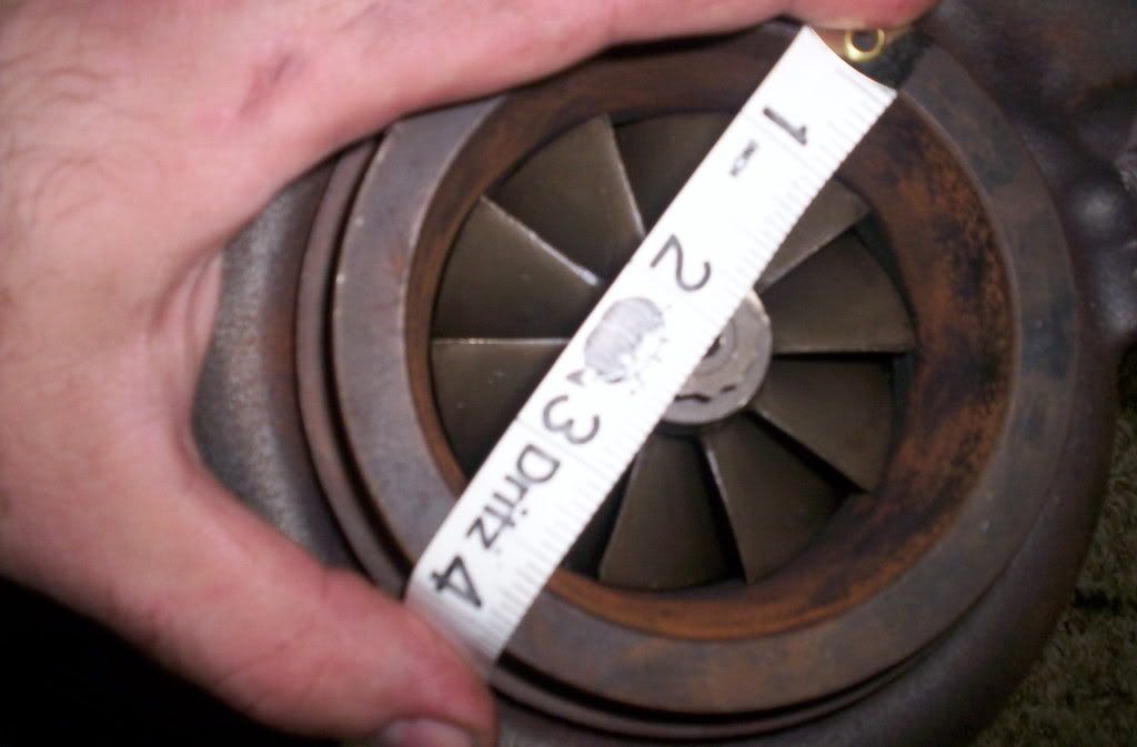

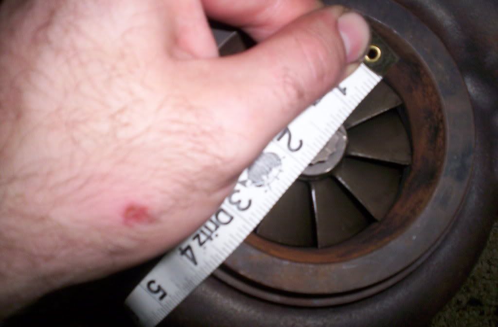

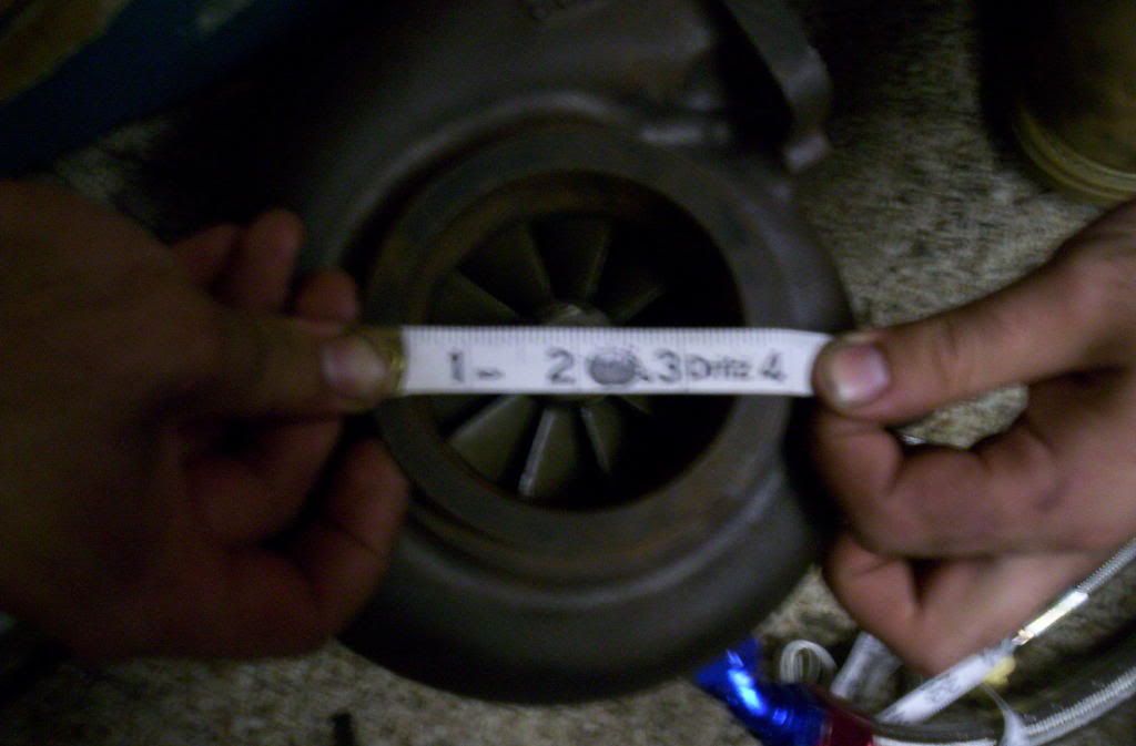

I just realized that I would have a gap from where the dp ends and where the next segment of exhaust meets. I have a gt45 turbo, it has a 4" outter diameter and a 3" inner diameter outlet
55
Are you sure it doesn't have a four inch inlet and a three inch outlet? What is on the backside where the downpipe would hook up? It's probably a 3" vband clamp, but it may not be.
55

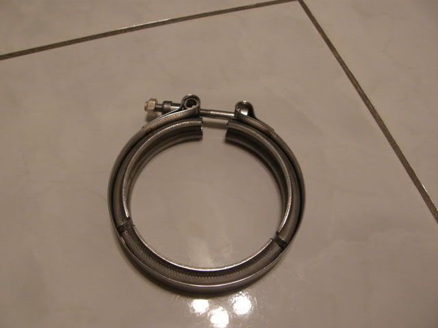

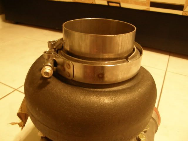

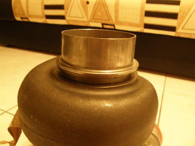

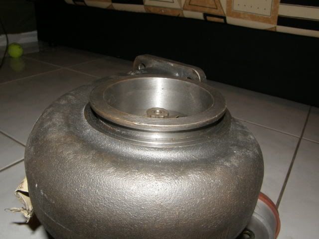

It's hard to tell from those pictures, but is that made for a 4" vband clamp? I wouldn't think so because I couldn't find one at Summitt. I wish I was more help but I can't tell what it's going to take to mount that to the downpipe. Maybe you should pm the turbocharger experts on here. You can find them on the main page on the Expert section. Good luck.

ya thats looking like a 4" v-band on that thing. you can either run a full 4" turbo back, or get a 3" downpipe and make a reducer for it

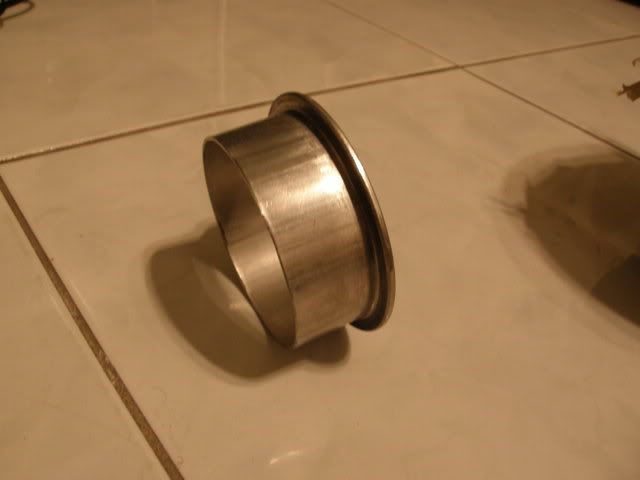

Check this out:
Blind Drifter;6302961 said:
You have the flange on the turbo
Then you need a flange for the downpipe of the same size that the turbo is
2 flanges together
Need a proper size V-band clamp
Clamp them together :)
Then just have your downpipe made off of that flange. Bolt it up to your mid pipe. It would be like running a 3" DP on a stock exhaust. It'll be fine.

No you can't, unless you change to a 3" vband on the exhaust side.
I'd sell that turbo and get a T61. You aren't going to be able to take advantage of the size of this turbo, with a 1.05 AR and 550s. You won't see full boost until 5500 RPM.
You could also buy a .85 or lower size housing and see if you can find one with a 3" vband.
