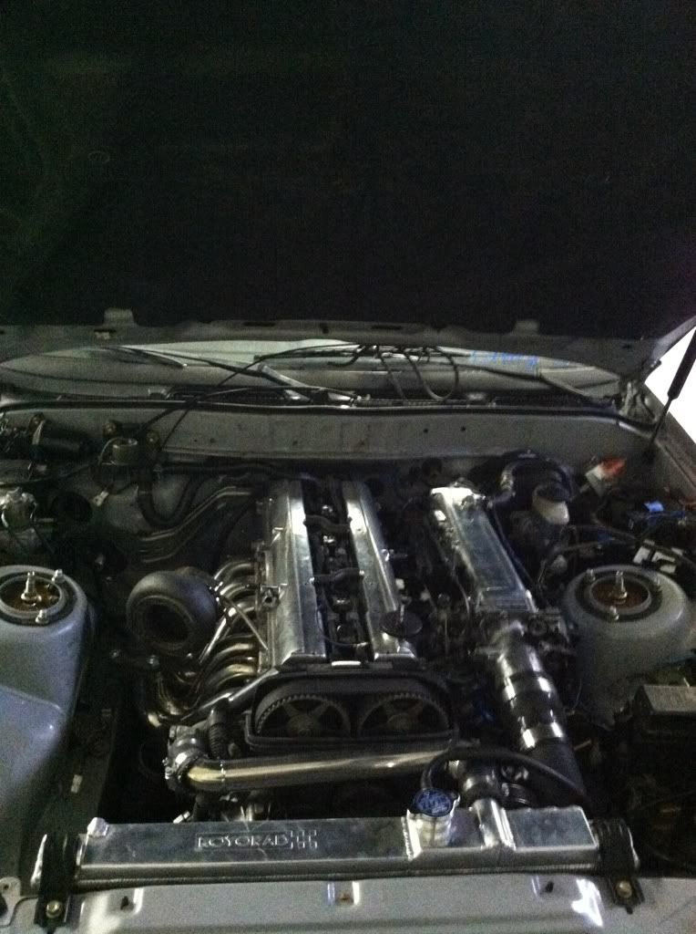

shit i have not updated this in a while..
well.. i spun #5 rod bearing and the motor is out. i have a built 2jz-gte that i dropped in yesterday
motor
- hks metal headgasket
- je pistons
- eagle rods (arp 2000 rod bolts)
- arp head studs
- arp main studs
- 76mm/ .68ar turbine housing garret (ebay) turbo "just for now"
- driftmotion t4 manifold
fuel
- aeromotive eliminator
- 12an line
- 100 micron filter
- 10an line
- 10 micron filter
- 2 - 8 line
- dual feed titan motor sports fuel rail
- 1250cc blue maxx injectors
- aeromotive fuel pump controller
Engine management
- aem ems v.1
- zeitronix wideband/data logger
polished everything..
K_SHAN
don't taze me bro!
Jul 3, 2009
357
eagle, IDAHO!

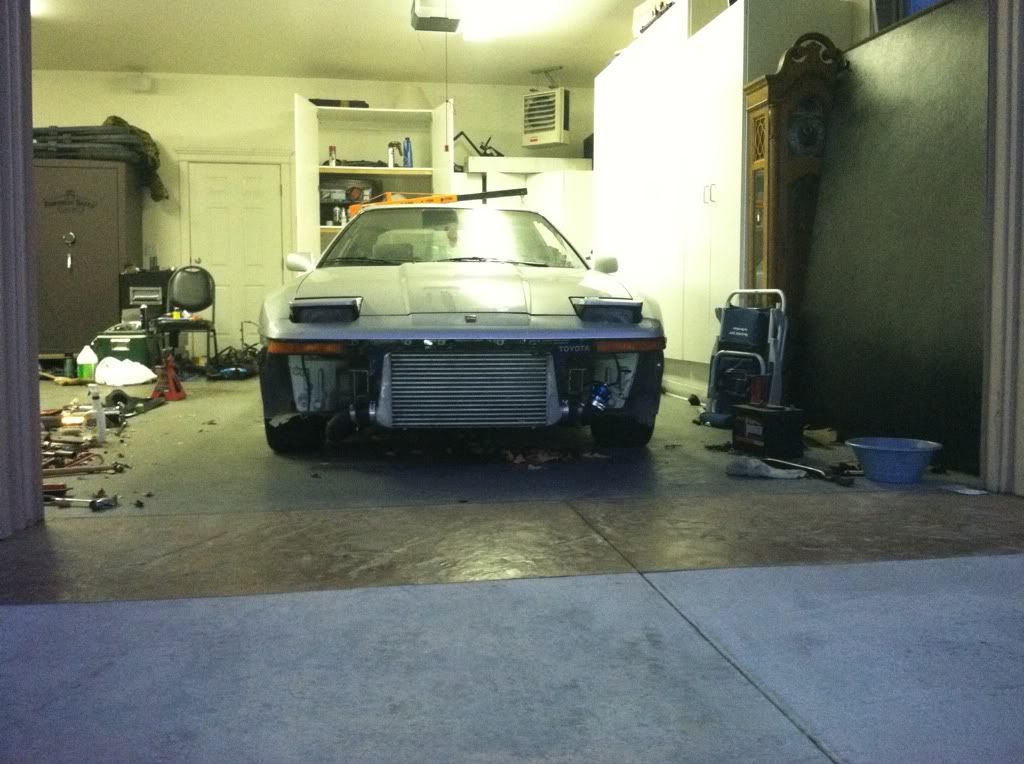

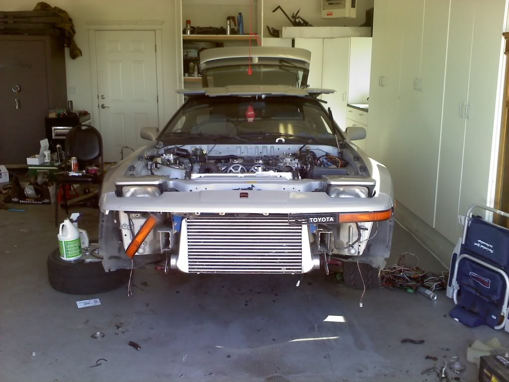

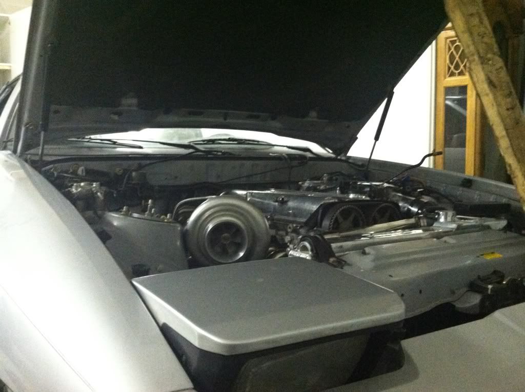

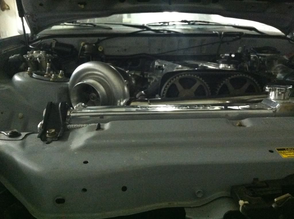

for some of you who don't know.. i took the 2jz from my white car and it is now in this car.. these are not current pictures. i just now learned how to upload from my iphone lol. so.. boom goes the dynamite.. ill get this thread up to date soon ;)
motor in and shit getting tied up..

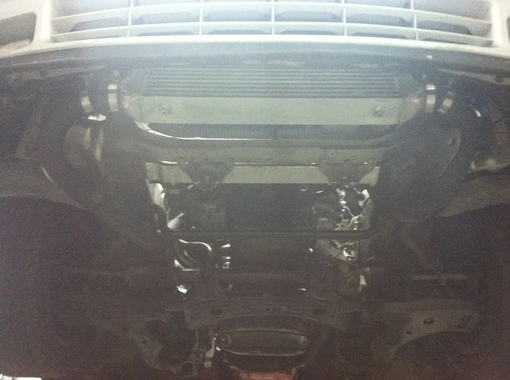

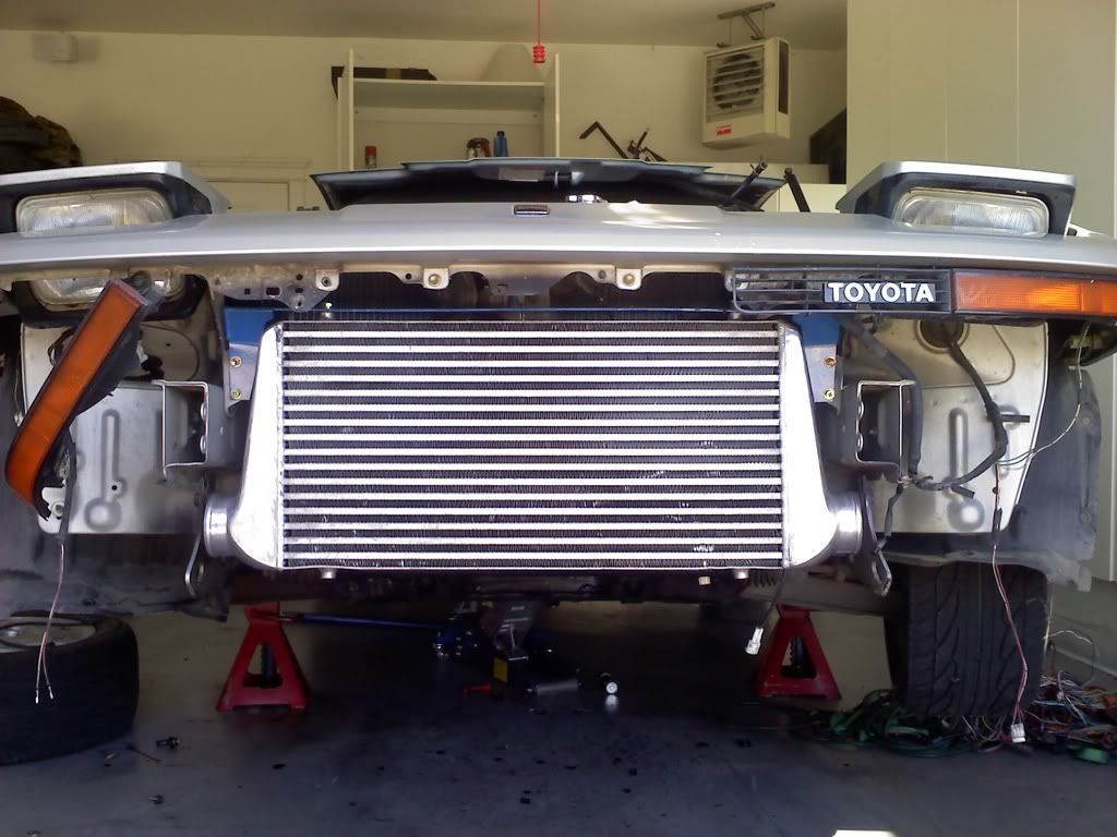

sweet ass intercooler support. powder coated and made by Jacob smith

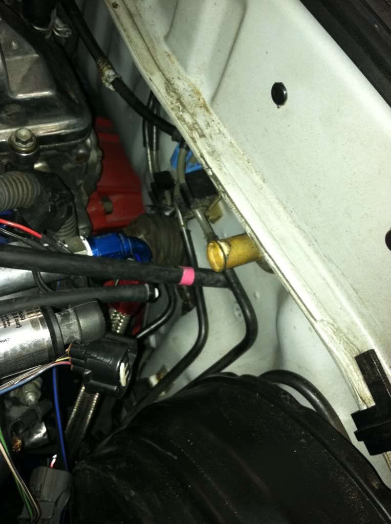

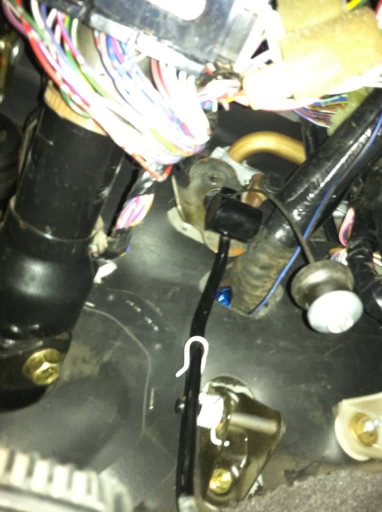

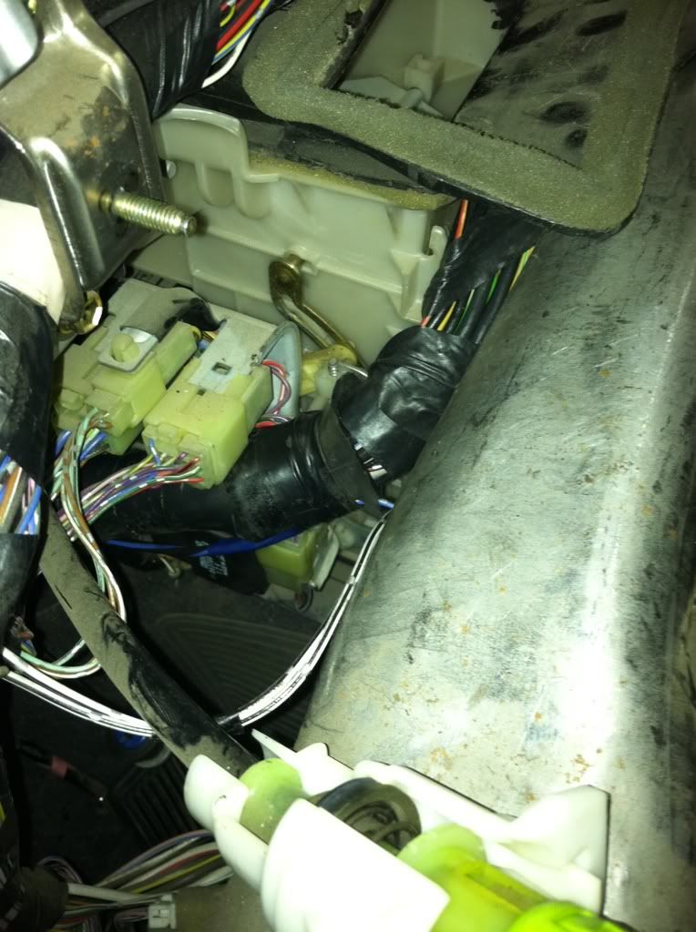

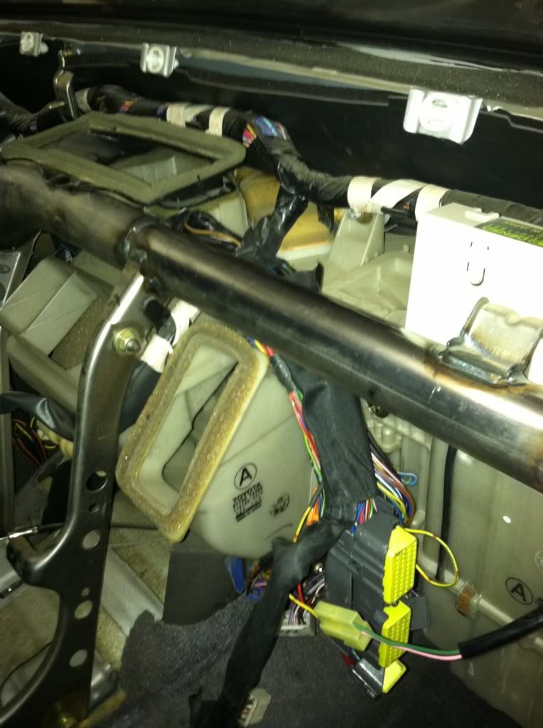

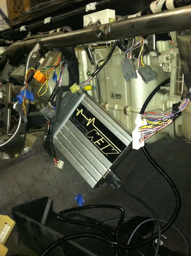

routing the engine harness.. such a bitch when using a JDM supra engine harness because its 18inches shorter.. so you can either lengthen it or.. cut a new hole and reroute it.. i chose rerouting, but it was a huge pain in the ass lol
in through the hole.. right behind the fuel rail (driver side. 1inch below and to the right of the throttle body cable
slide past the pedal linkage..
up and under the defrost vent
then finally droping down in stock location.. althought the AEM EMS does not fit since its much larger.. fuu

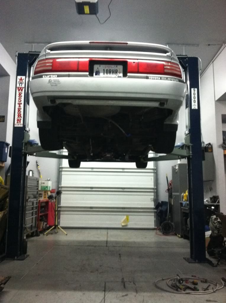

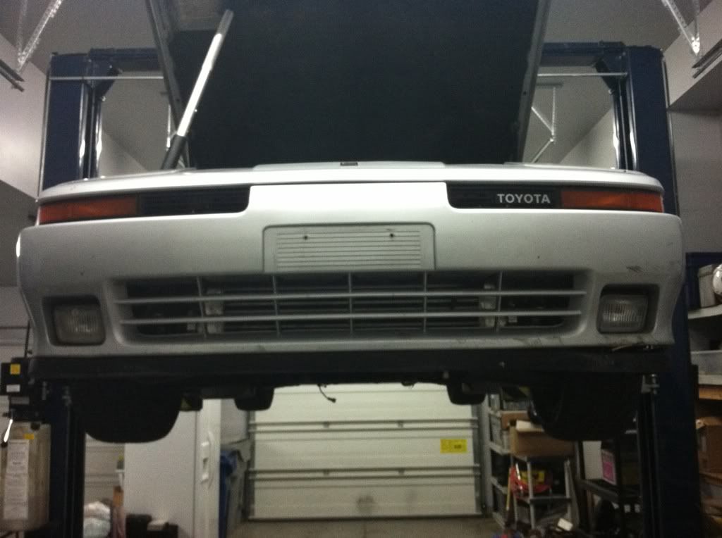

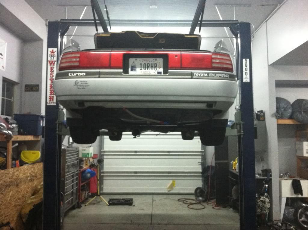

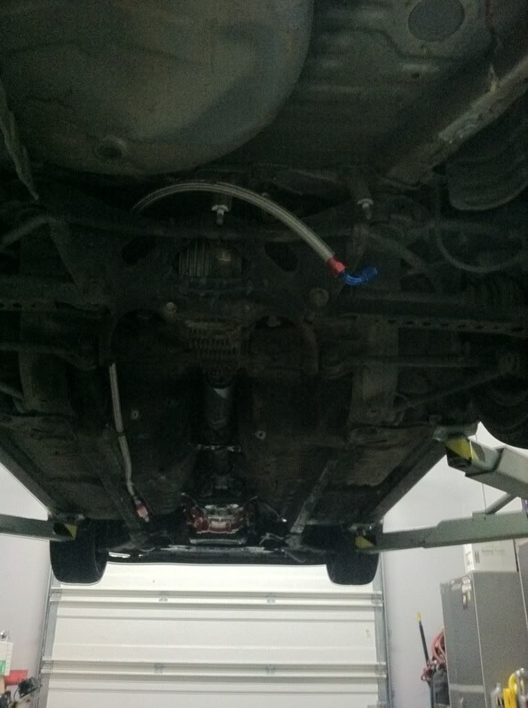

missed some pictures.. so here they are. luckily TheMadSupra has been a super nice guy and let me use his lift a couple times.
so the Occupy lifts movement was a go.

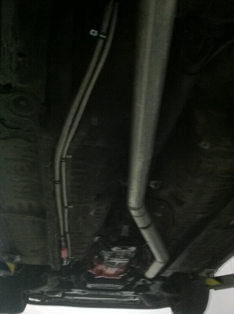

feed line.. -10an with an inline 10,100 micron filters
LOOKS stock right?
get in ma belly
ya thats not a bad idea haha

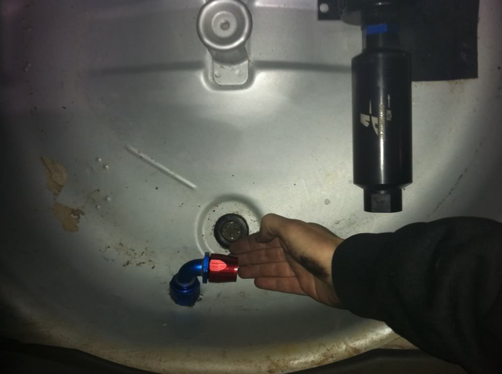

so i had a little accident with the car last night..
i was in the middle of mounting my return stainless steel return line when i heard a little crackling sound..
the line was drapped under the car and on the engine bay, so as i am mounting i tug on the line to get a little more slack. a minute or 2 later I smell a sour scent in the air and realize that something is burning. i walk to the front of the car and Smoke is Billowing out from the hood. I rush to get the car down from the lift. only to find that the Stainless steel line is arcing on the battery and vulcanizing the rubber. Lets just say its scared the shit out of me lol. luckily only thing damaged was the return line.

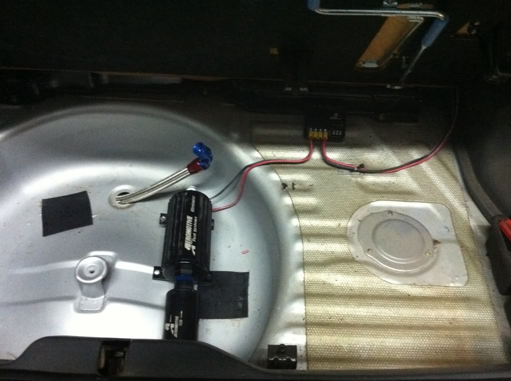

I had originally done the same mount as 2jzmk3 and UPGRADEDsupra for my fuel pump, but for this car that will be driven so much.. i just don't want to risk it hitting something
so I mounted it in the spare tire area. Aeromotive eliminator and fuel pump voltage regulator.
it will exit the pump of a elbow and then to another elbow that will be tap'd into the side of the spare tire well ( just like the one coming in )

arknotts
formerly ark86
Jan 9, 2008
461
Ohio
You think the pump will be OK sitting above the tank like that? Aeromotive says to mount it as low as possible compared to the tank/fuel level.
K_SHAN
don't taze me bro!
Jul 3, 2009
357
eagle, IDAHO!
yeah I have a few buddies who mounted them above and didn't have problems.. Only concern is it not getting cooled down. On my 87 i have it mounted to the subframe below.
so We will see lol.

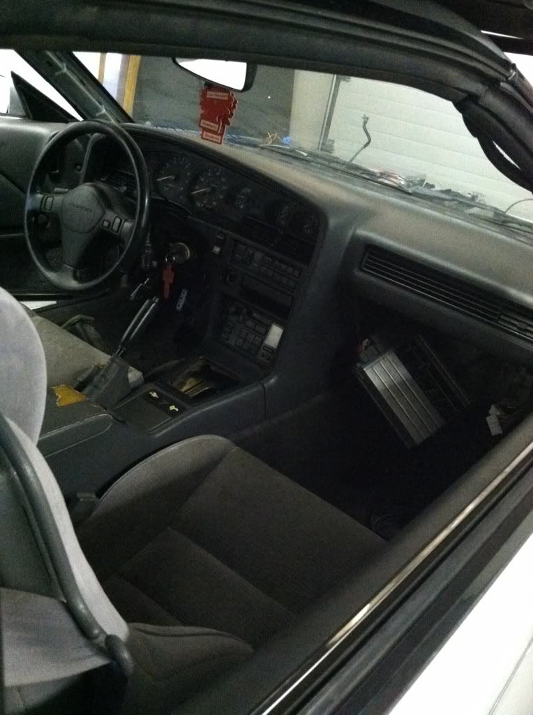

so while I have been waiting on my harness I decided to Tint my cluster.
Started off with going out and buying some 3M 35% tint, then taking my cluster cover off
Before:
Cutting the general shape out, laid it under to see the fit
After!
Final outcome assessment.. Its "ok" Since this was my first time with tint, I'm pleased with the outcome. But still have a little to learn. Good thing I have a few cluster covers sitting around lol. It will work until I make a nicer one..
