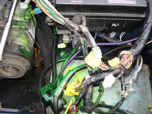

So an idea hit me at about 4am this morning while reading threw some threads on a sleepless night
Considring i did this
would it not be smart for me to completly get rid of my A/C, relocate me alternator and put in a FFIM?

well Iv been looking at what i Need to do the Na-t and noticed a how much cleaner the ffim looks so i started thinking hmm ok well what would i need to do to make one fit and saw one desin that removed the A/c and replaced it with the altanator and considiring i had already disconected my a/c accidentally i figured for a bit more i could just remove it replace it with the altanator and put in a ffim
