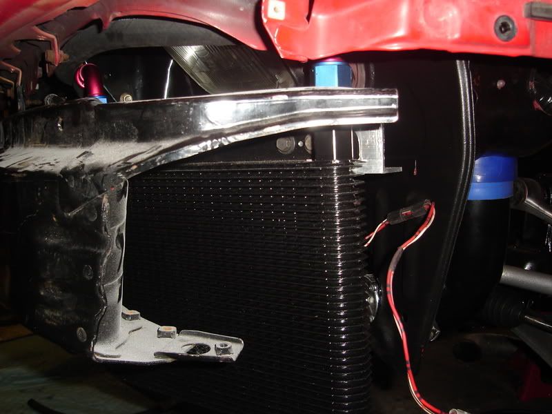

i used a b&m oil cooler because it use's an-10 line's.i just couldn't find any factory junk yard available's one's with bigger then 3/8" line's.i did squeeze it in the same spot and the hole in the greddy bumper has a bigger hole for air.i have no a/c and still didn't want it mounted between the rad and ic.

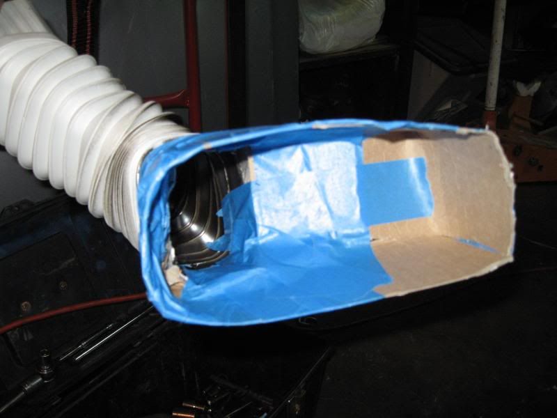

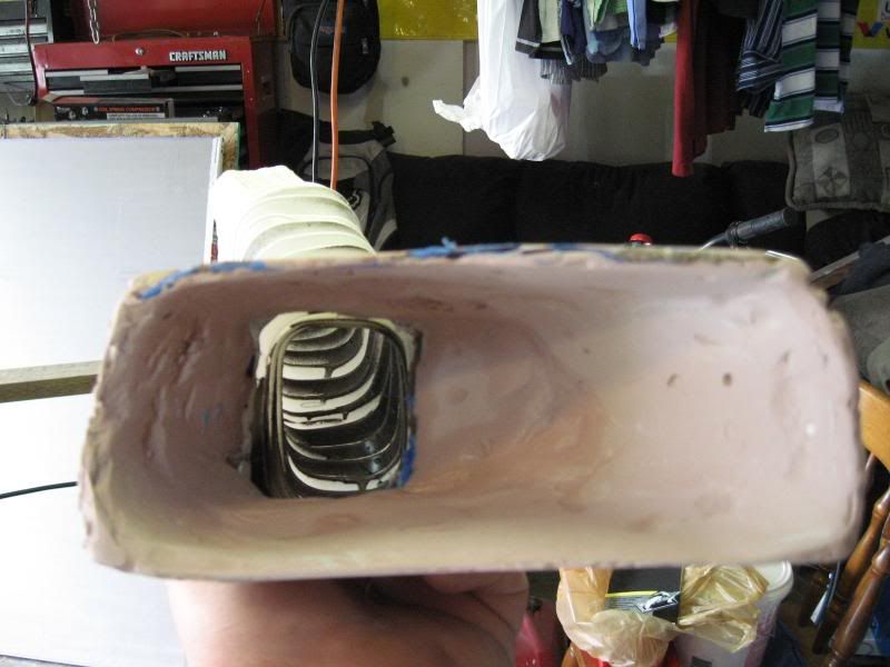

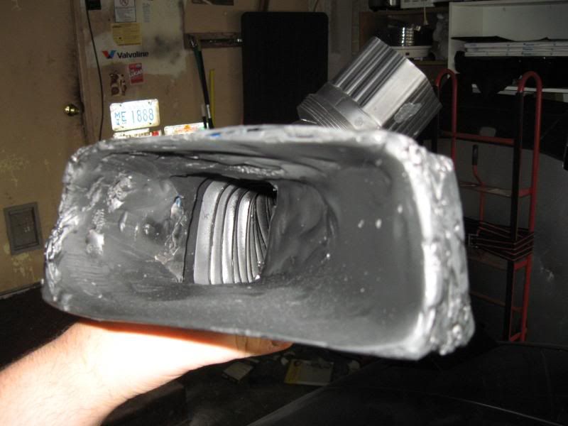

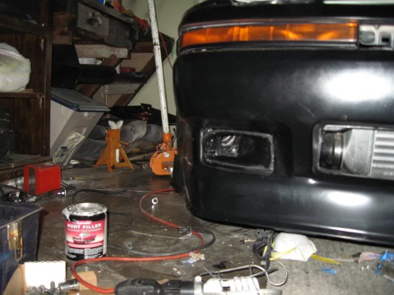

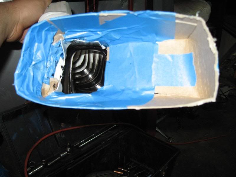

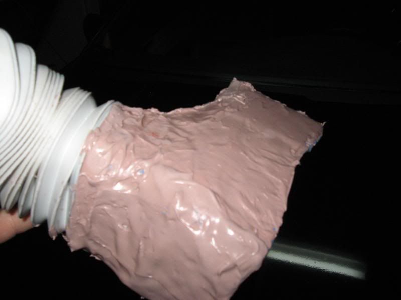

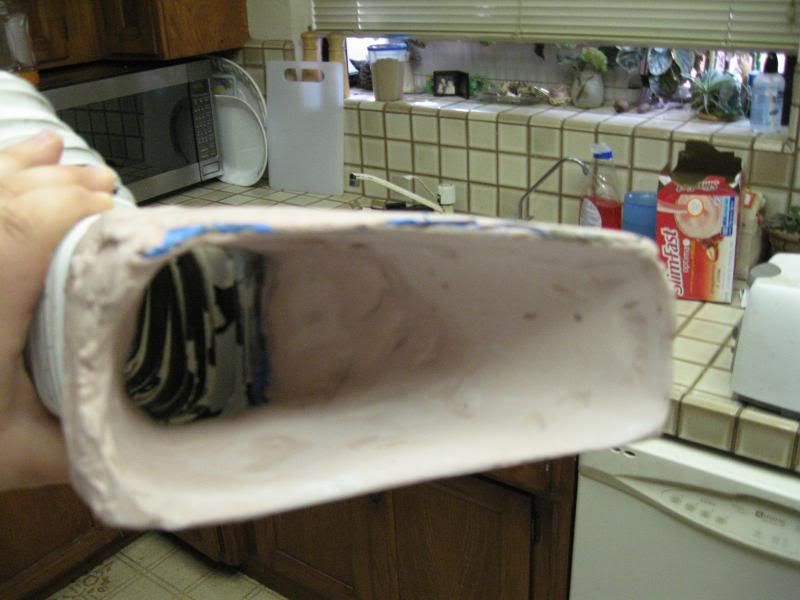

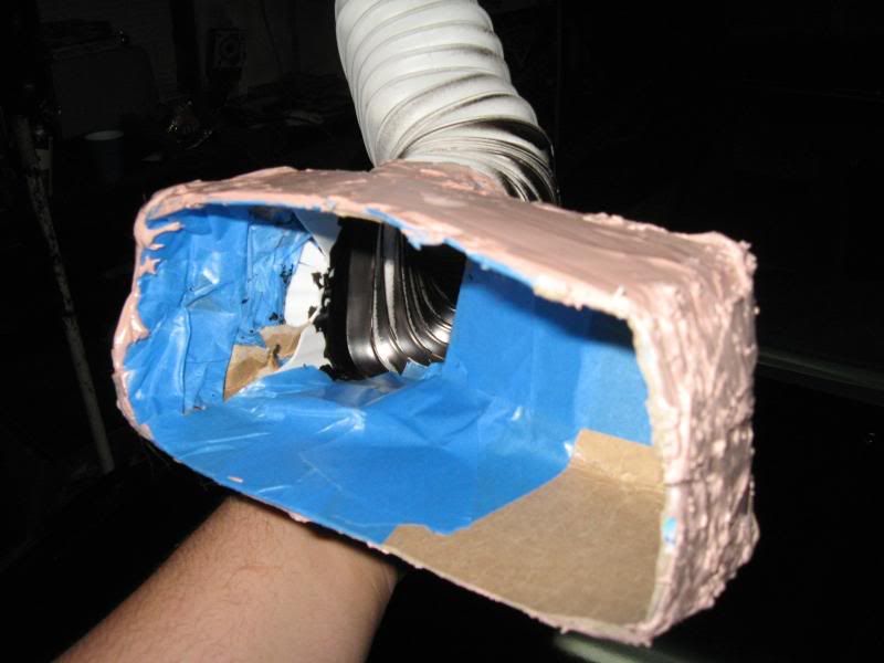

got a test fit done today... (still rough draft)
Started with card board and tape...
Then outer layer of Bondo...
Then inner....
Playin around with some paint/ fitting...

Kckazdude;999090 said:
Too much Bondo. It is most likely going to crack apart. Fiberglass would have been a better solution.
You are right!!! I just dont know how to work fiber glass... Yet:naughty:
