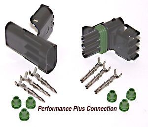

oh those are just simple gm style weather pack connectors
3 pin for gm 3 bar

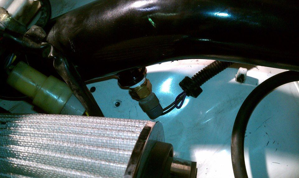

If the IAT sensor looks like this
Then simply go to your local auto parts store and ask for the sensor harness
Then you WONT need the 2 pin weather pack connector, 2 female pins and 2 gromments

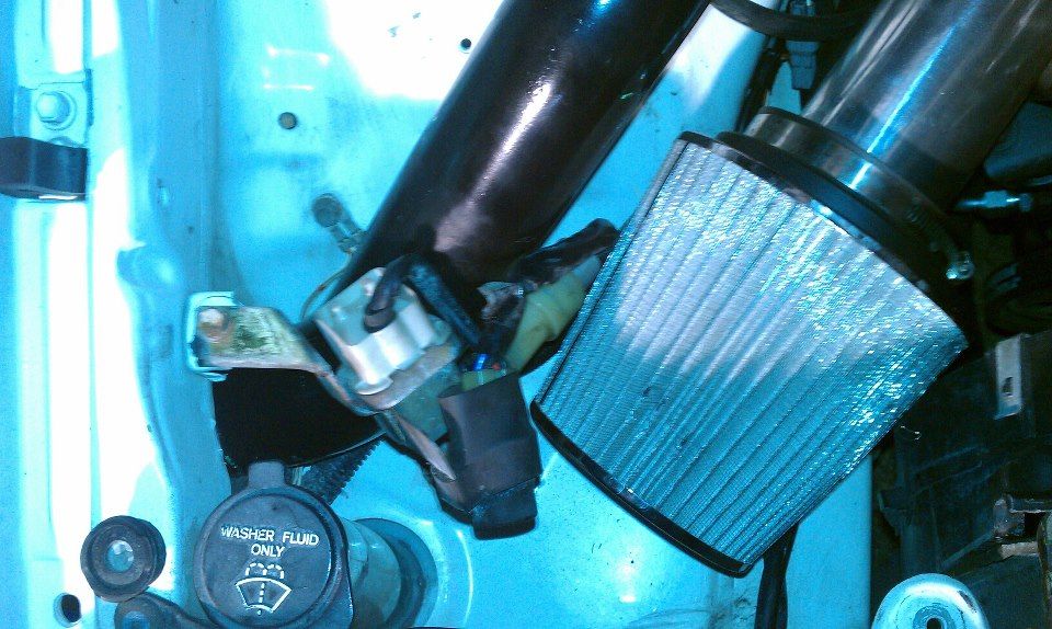

Place your IAT as far away from engine as possible but on cold side of intercooler piping
My location
Cant even see it :)
Originally i had my IAT mounted in 3000 pipe
But had major issues with heat soaking. 170 degree cruising on the highway on a 95 degree day
Relocation dropped atleast 60-70 degrees
