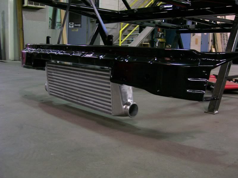

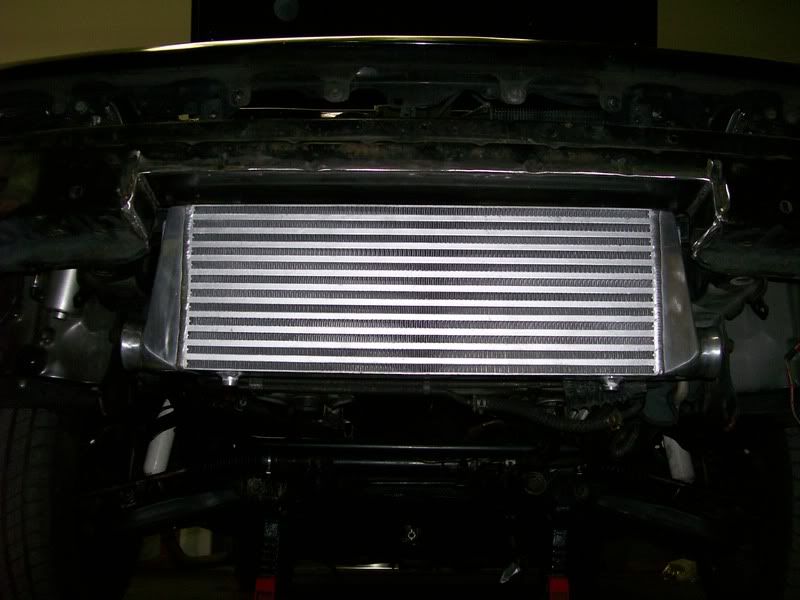

Got my FMIC mounted in the bumper and the bumper boxed back in. Have to finish one bracket and prime and paint the bumper then all back together. Having some issues with some motor work that was done so have to have a bit more done tomorrow, def not happy with the quality of the work! Got a few more things painted up today and still have a good bit more to finish up painting!
Pics:!
The front end will be very sleeper with full grill and everything. Barely see the FMIC unless you know what you are looking for!:evil:

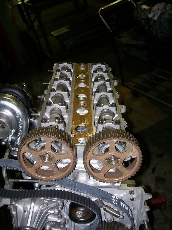

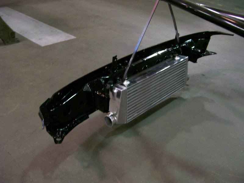

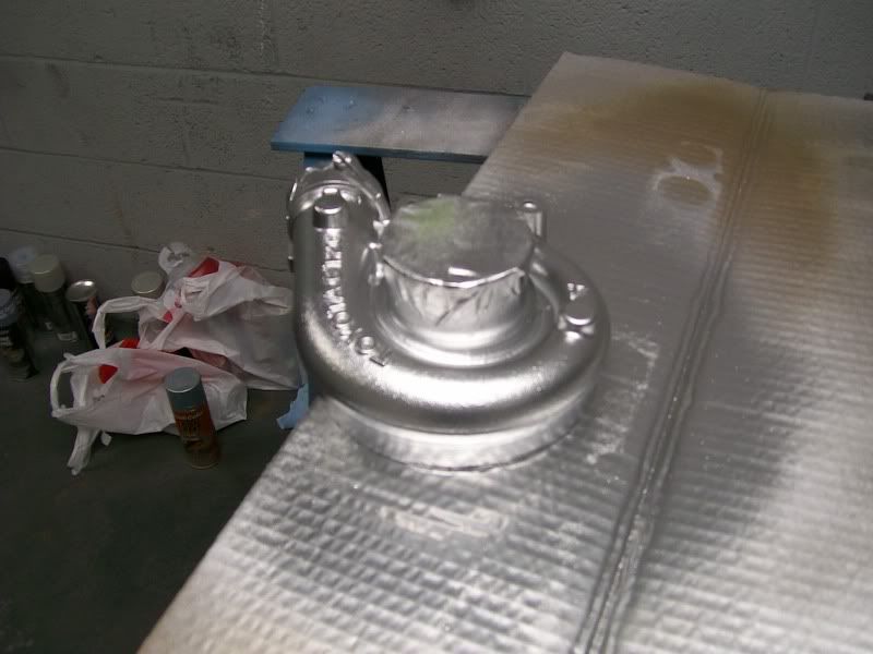

I hate all the cleaning and painting but it will all be worth it in the end. Head had to come back off and go back to the machine shop to be redone today! Very poor quality and tolerances so I made them do it right!
Finished the FMIC mounting and painting the front bumper back up....factory Toyota?:

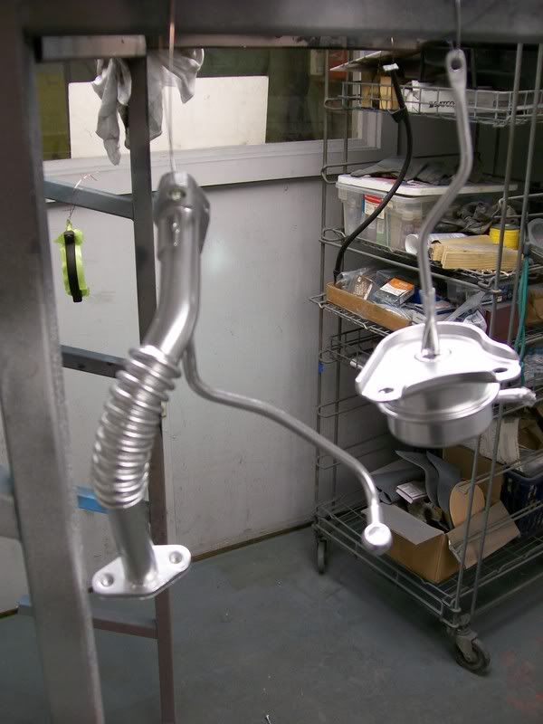

Then some other parts painted up. Did the turbo in 1200 degree paint and some of the lines around it:

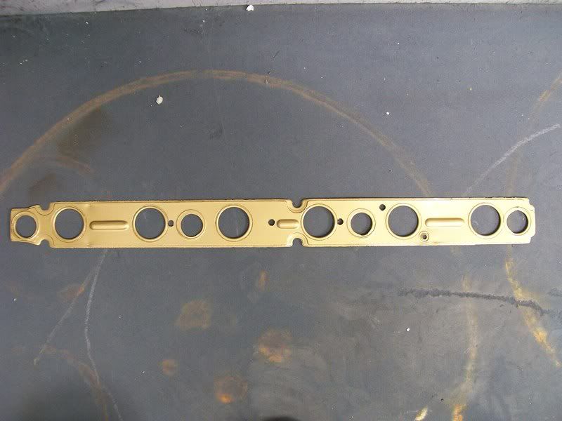

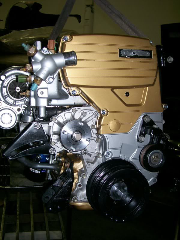

Then spark plug galley in gold:
Still to take parts to powder coater.... such a slacker...lol
Few more parts to clean and paint still but get my head back tomorrow so that will go back on and can get the motor mostly done tomorrow!

Seth, please tell me you aren't gonna' re-use those shitty Toyota hard lines for the turbo?!:icon_razz The braided ones are soooo much nicer! Well, I remember you said the CT26 is just temporary, so probably money better spent elsewhere.
Nice job so far!:thumbup:
sethron71
Authorized Vendor
Jul 19, 2005
871
Las Vegas, NV
www.SethIngham.com
Ha ha Tom,

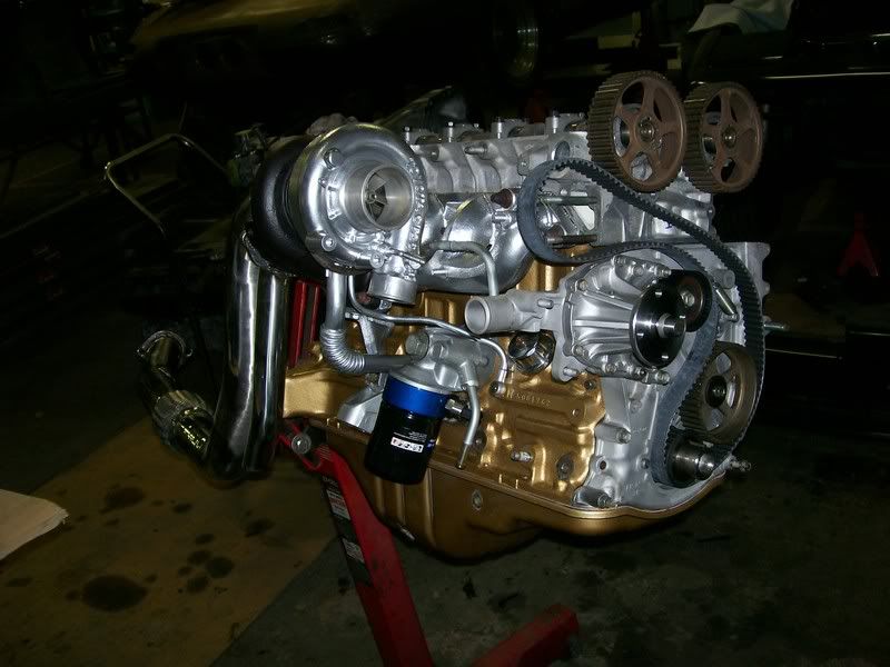

You know me... When I go GT35R and custom tubular manifold I will run full Startlite lines! But for now I am going with the shitty toyota lines.... K did a bit of mocking up tonight. Unfortunatly the whole not gonna have it long so go a bit cheaper route bit me. Went with ebay Divorced DP and it doesn't fit. Very nice piece just the divorcing tab is in the wrong place and hits the turbo. Luckily I have the tools, machines, and can TIG like crazy so I will have it fixed up quite quick and maybe improved a bit! Here are some pics:
Spark plug valley cover painted gold:
Also got my head back today as you can see it is installed again after I made them re-do my valve job...IJ said it would be ok but since I paid for it and it was outside of specs I made them re-do it plus I wanted more consistancy for tuning ease!
Thanks for looking, I am getting a bit excited, and should have it in the car this weekend!

Well not much new this weekend. I think my body hates me for being in the shop from 7AM to Midnight every night this last week as I was completely physically exhausted this weekend and lazy...lol Did work a bit today. Redid the divorcing in my DP, took about 45 mins to make a new one and improve it a bit. I may even do it again to seal off better once I hear it run and determine if it sounds too much like an exhaust leak!

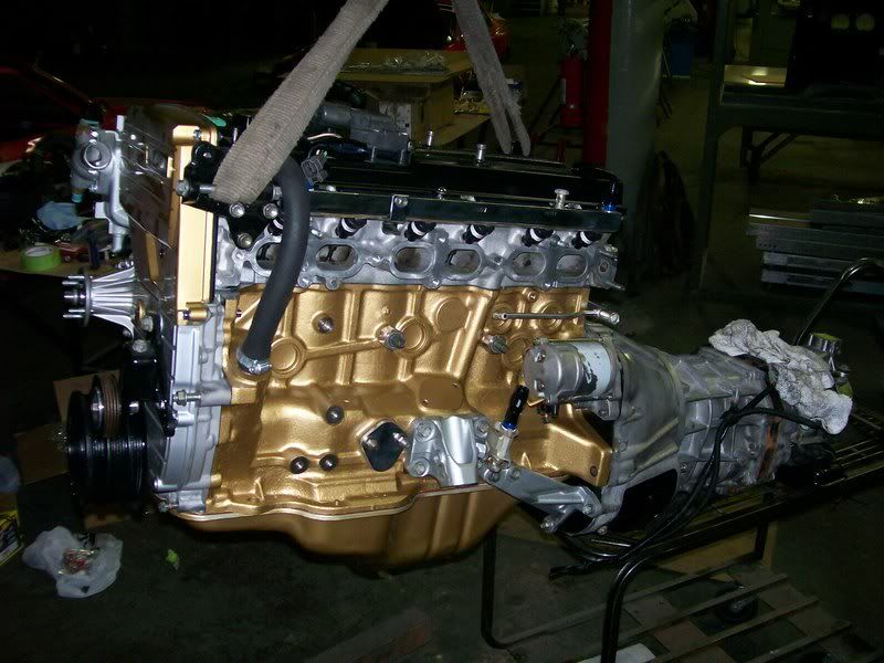

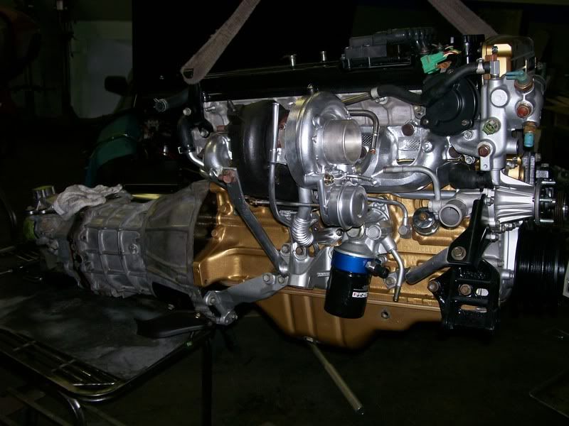

Pics!
Motor is together and will go in tomorrow. Just have to remove a few things and clean up a few things in the bay first and she goes in!
Still have to build FFIM as well. Will take a few more pics of the rest of my parts tomorrow!
