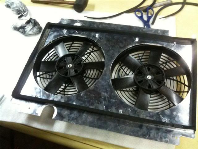

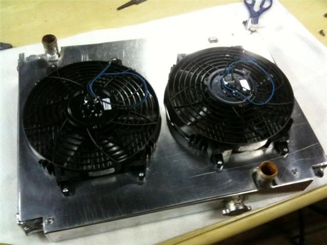

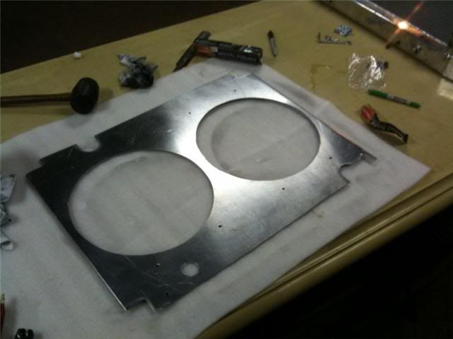

I was quoted 700 plus for the flex a lite kit so i doubt they only pull 2500 cfm. i couldnt tell you how much my fans need to run, they are twin 12 inch Davies Craig on a custom alloy shroud and 52mm thick alloy radiator.
Someone was screwing with you, then - these can be had for $350.
It's easy to tell how much they need to run - fire up the car, get it up to operating temp, then sit there with a stopwatch and time how long they are on vs how long they are off for a few minutes.

Yes thats the one mate. You're right, the place that sells them here in Adelaide (Australia) has an excellent rep and is about the only automotive place that brings in an extensive list of parts from The States so I guess they get away with it. I was just going to purchase directly from Summit but my custom arrangement ended up being far cheaper and will hopefully net the same result, they pull a crap load of air!!.
My shroud is ultra thin and doesnt look like it has a great deal of volume but its been tried and tested on a Z20 Soarer with a 2JZ + Greddy T78 which obviously produces a lot of heat and the arrangement held up nicely.
I got bad news for you and what you were told about your product
The best most expensive davis craig fans are these http://www.daviescraig.com.au/Therm...FAN_KIT__12_VOLT___PART_No__0062-details.aspx
12 volt 12" fans each fan draws a MAX CFM of 1060 draws 9 amps & cost roughly 226 each X2 that means your system pulls a total of 2120 CFM at 18amps & the two fans cost nearly 3X what the one fan I am installing cost.
I am not knocking it, your product looks great & it works for you, but I am trying to build a system using OEM parts for about ⅓ the cost performs to par of OEM & permacool suggestions & other writeups.
