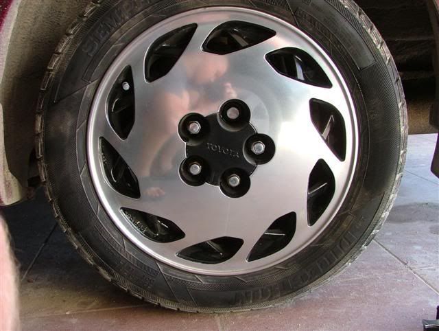

What did I: Removed paint (stripper didn't work perfectly and my blades were damaged, so I used flapper wheels or some sort to remove paint), then 400, 600, 800, 1000, 1200, 1500 sandpapers, steel wool, bigger grade polish, smaller grade polish, Mother's Meg number 85 polish. (centercaps didn't need anything actually:))
Result:
Now just need some spacers :D
