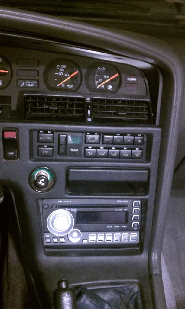

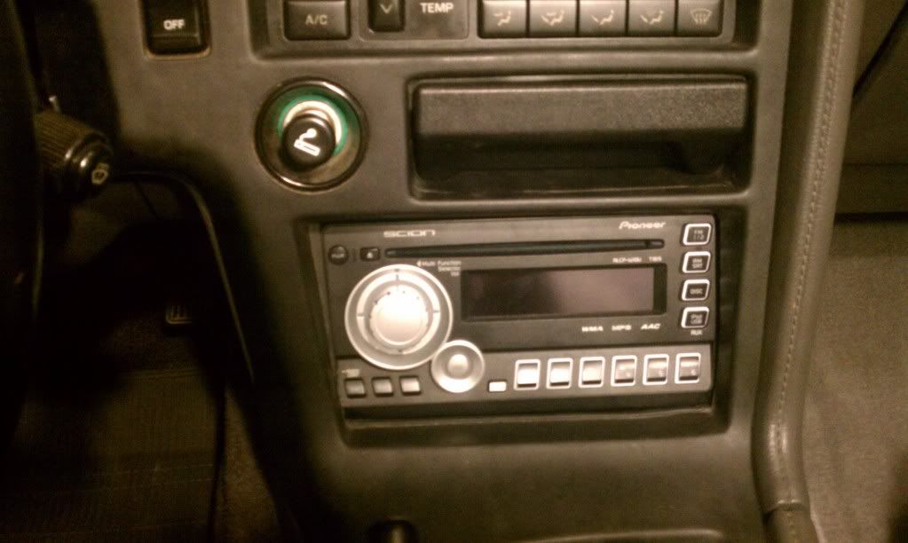

It worked. I installed one of those scion radios, and just wanted to see if it worked.
I pretty much finished the swap of the interior. Just need to install a couple of speakers and put the rear seats in. Then I'm gonna turn my attention to cleaning up the engine bay.

Damn. Looks good.
