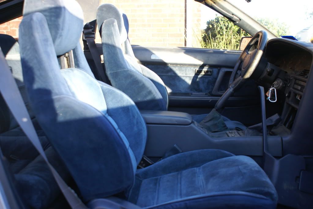

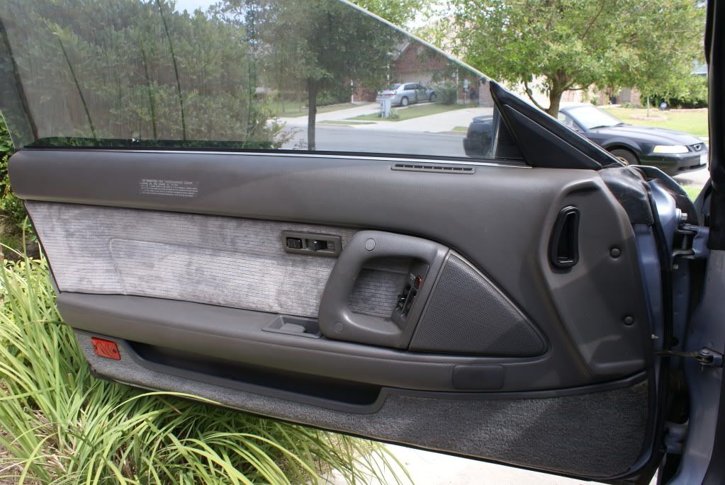

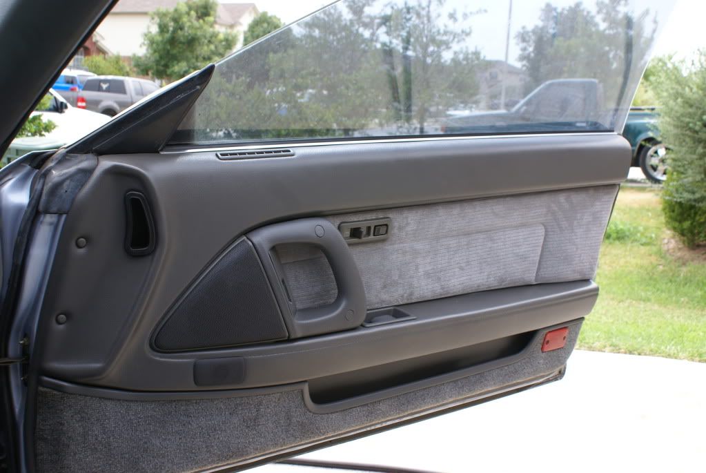

My last car was a 89 with a 1j. The engine craped out on my so I was left with a car with no engine and a great interior. So since I like the way the metro blue 87 looked on the outside but not the blue interior with the checkered seats. I decided to get the best of both worlds, and put the grey interior in my gay blue car. The colors go well together, I don't know why Toyota didn't do it. I guess the had a lot of ugly blue material to get rid of.

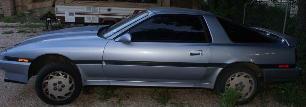

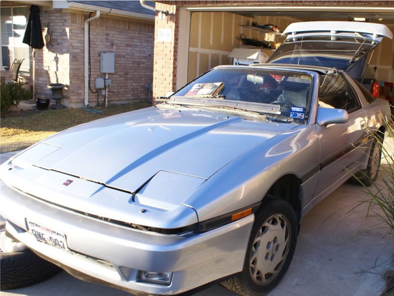

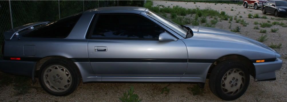

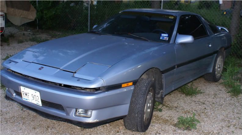

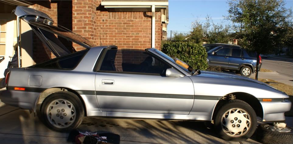

I tried selling it once but no takers ( I was kinda happy about that) this is her at home cleaned up.

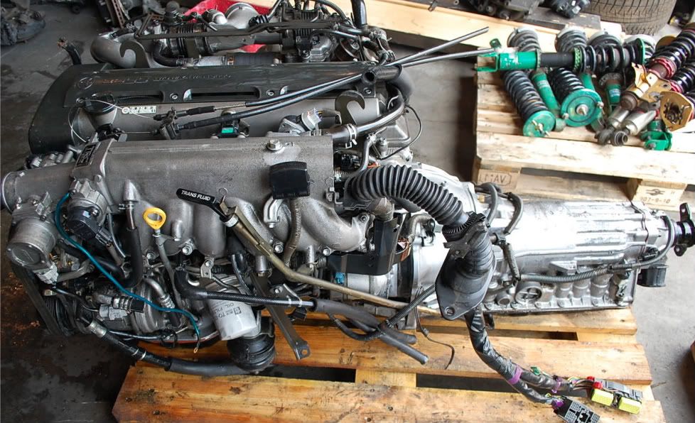

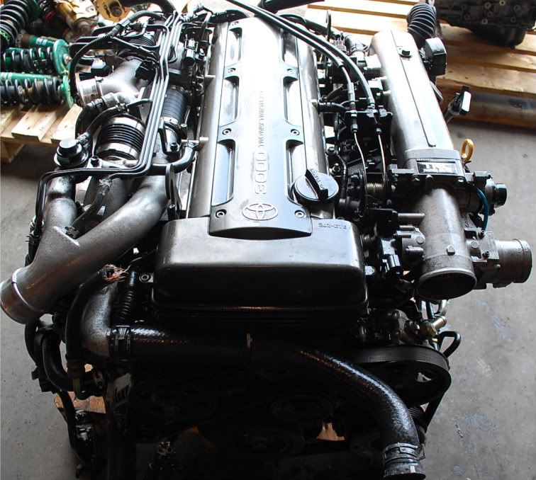

I need to get pics of it with the grey interior..... But here are some of the engine that jdmsource sent me. actual pics of the engine they will be shipping.

Looks like a nice engine from the outside. Hopefully the inside is just as clean. Cant wait to see more.
You stay with the twins or going single?

Yeah, the first thing I'm gonna do when I get it is pull off the valve covers and see what I'm working with.
Going single. I have a 67mm dm turbo from my 1j.

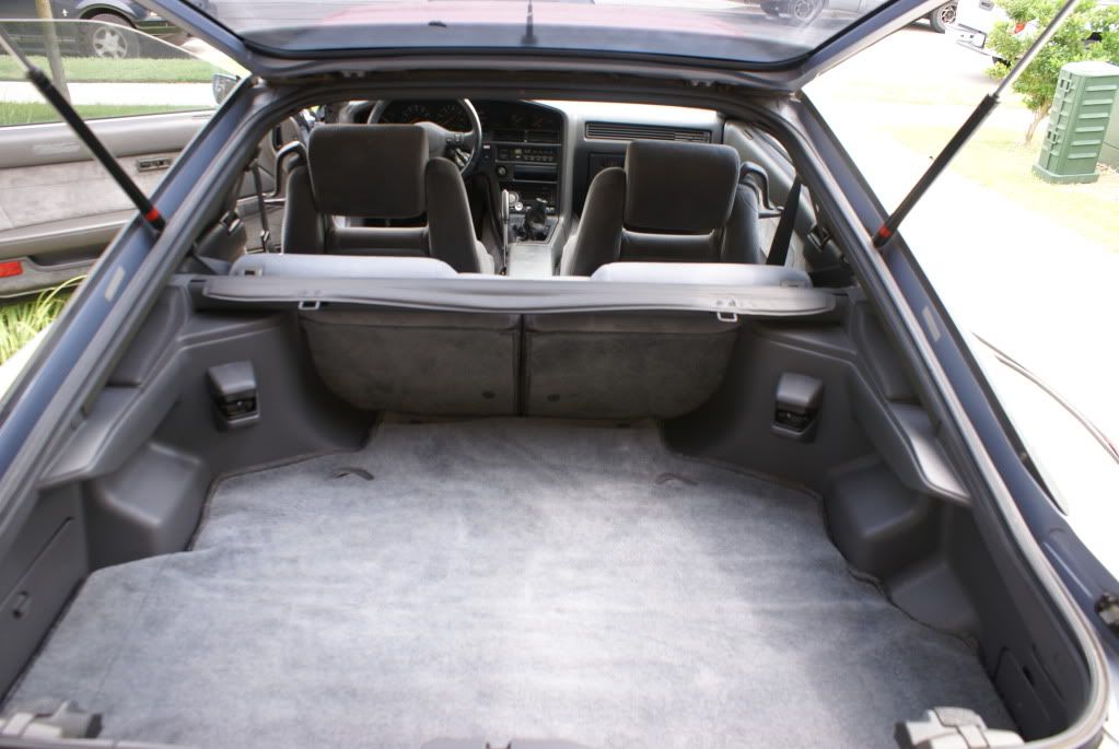

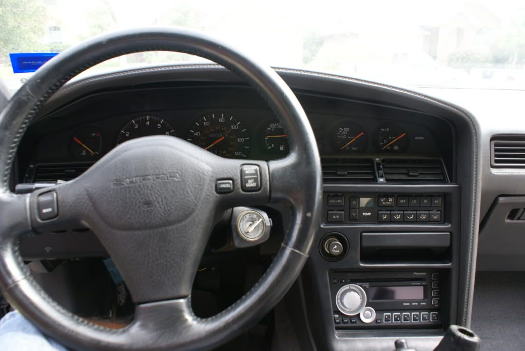

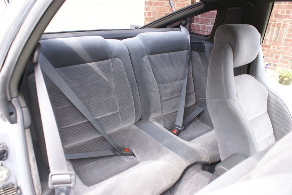

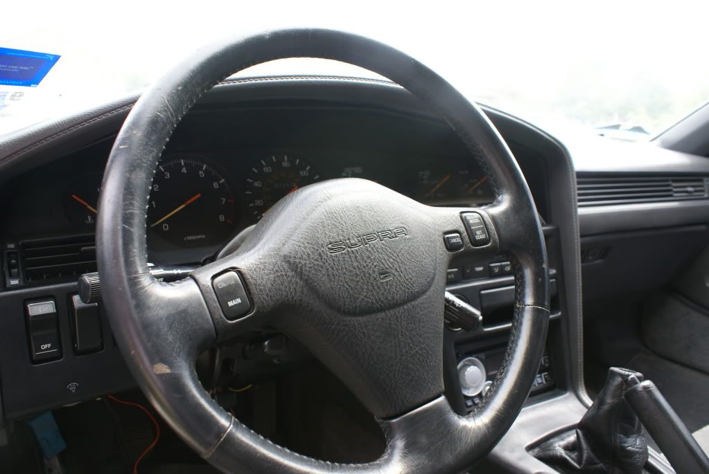

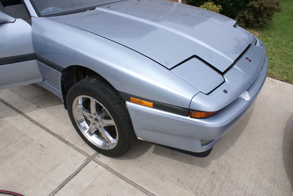

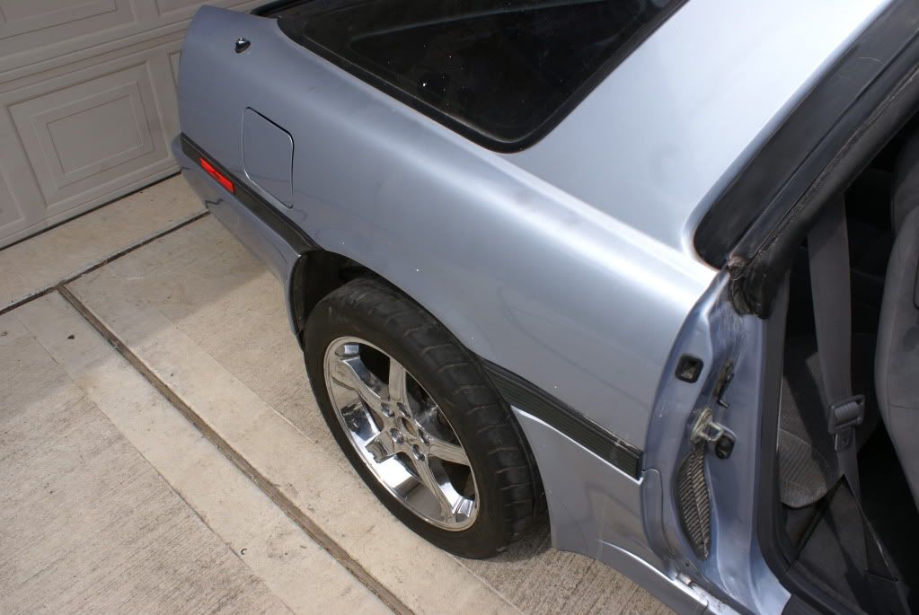

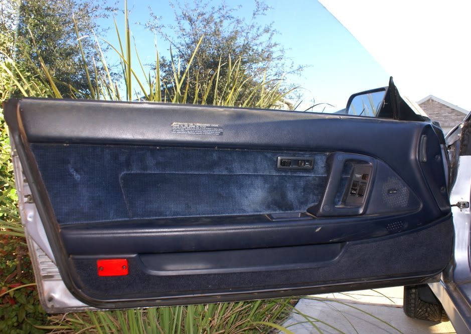

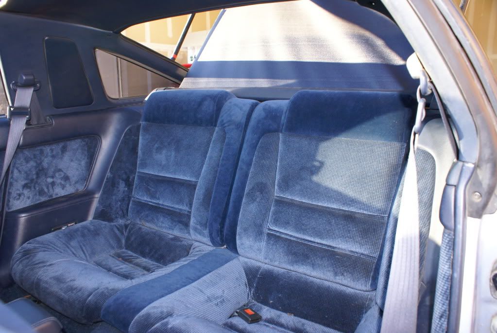

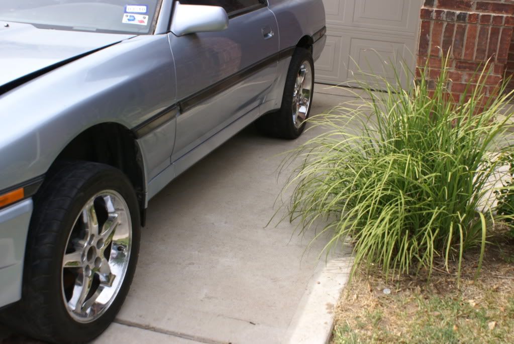

Pulled it out today and slapped the rims on, and took some pics of the interior. Rims look nice. After I get the right size tires and drop it a little is should look really nice. Here are pics.

Suprapowaz!(2);1736692 said:
Looks good. That interior color looks good with the ghey blue. I'll be following this build thread.
Thanks, you need a thread.
satx88supra;1736720 said:
Rims look nice Mike!!
Thanks, they will have to do for now. Better then the saw blades that's for sure.
S.A. supra
Feb 15, 2009
2,405
Buda, Texas
Thanks, yeah I don't know why they put all that blue in there from the factory. I was unsure if the grey would go, but it turned out looking better than I thought it would.

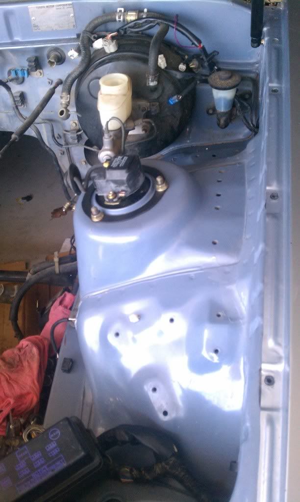

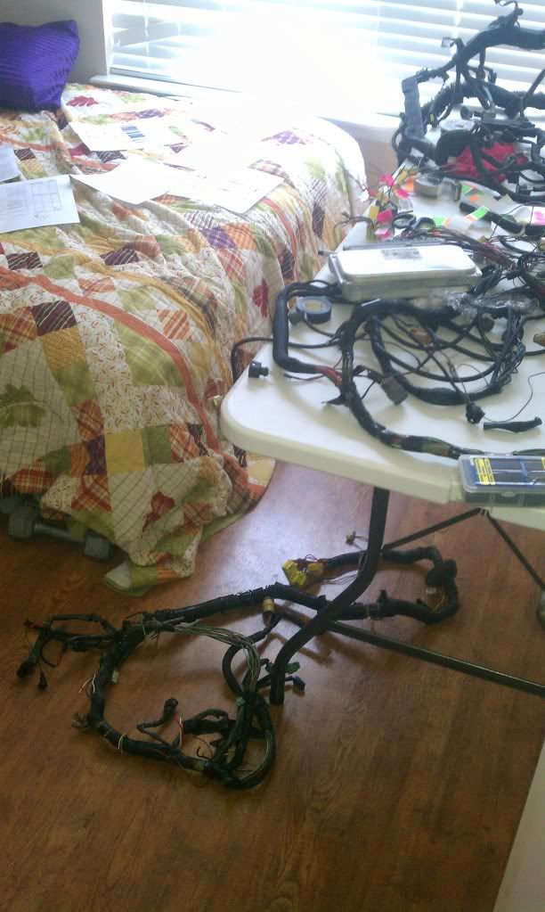

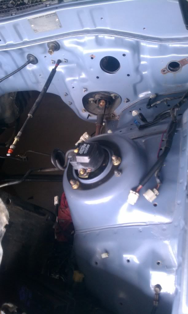

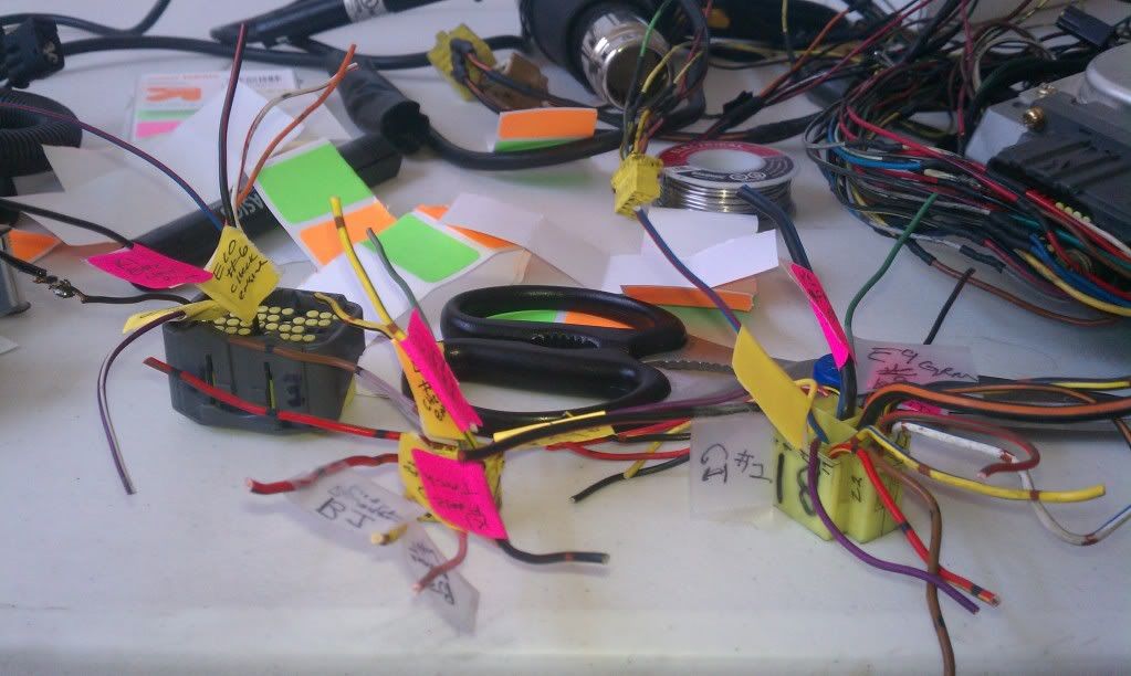

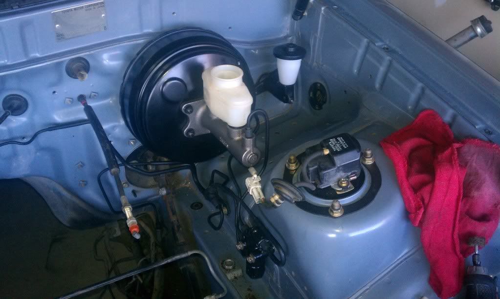

Haven't done much, cleaned up the engine bay. Painted the brake booster and installed non abs lines, new clutch cylinder, and brake master cylinder. right now I am in the process of wiring up my aristo harness to my supra. I turned my daughters room into my harness work shop. Tomorrow i will be ordering my oil pump, water pump, flywheel, bell housing and gasket set from champion Toyota. I also bought a hand held media blaster from harbor freight. i will be cleaning the parts i pull off the engine as i swap in gaskets all around. Here are some pics of my progress
Some of my harness mess.

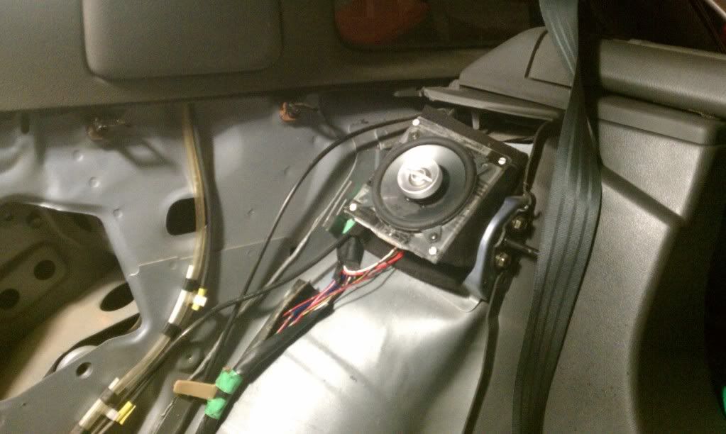

Oh yeah I did this a while back wanted more sound then just the 4 speakers that they had on the 87 model.
