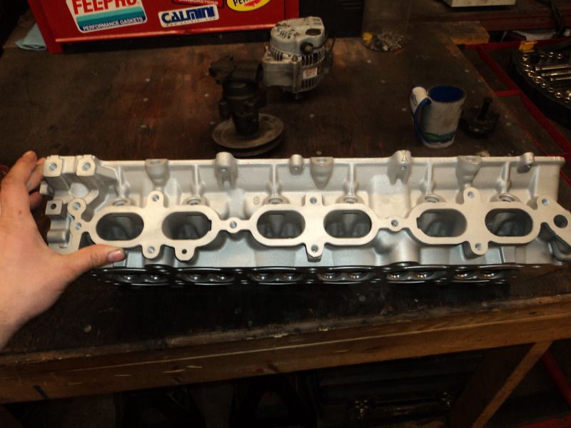

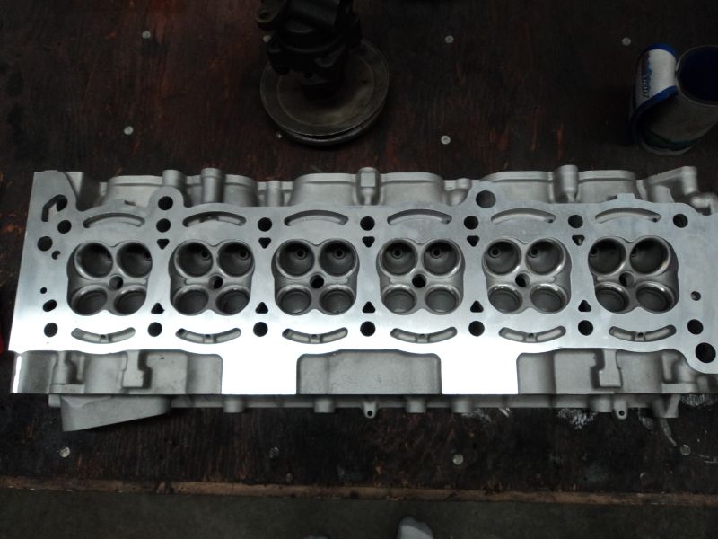

Well Since my old ported head was destroy from lean out Grrrrrrrrrrr
I got my self a new head to play with 92 casting as well
and some well pictures of group A heads porting job that I took my self
I figure I will put about 20 plus hours into this head alone and I will have to get custom pistons to boot since so much will be removed

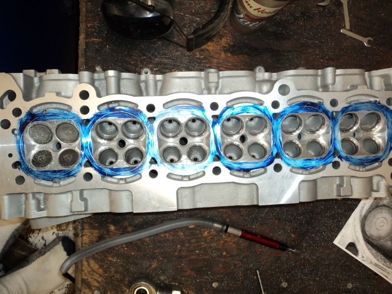

Well I got my head back but now it's time to grind grind grind
you can see how much is all ready taken out all ready and have yet to even start lol
Stay tuned

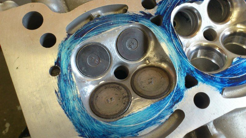

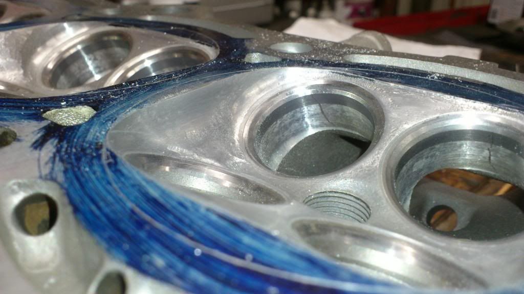

well did some work today
turning out pretty good I must say
now just have to ummm do some more fine tuning then cc the camber's and order my custom pistons :)
this time around I am going to be running solid bucket as well
still debating about getting bigger valves but we will see

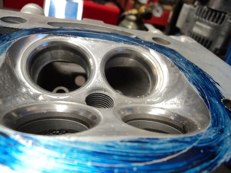

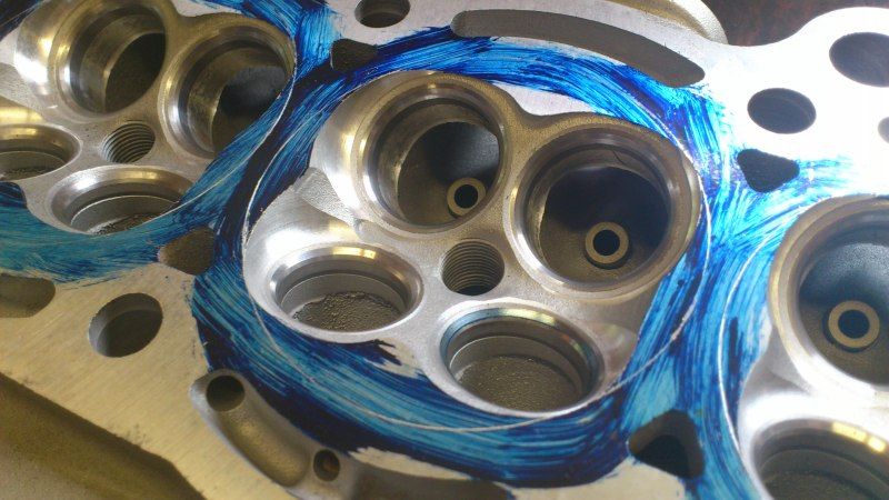

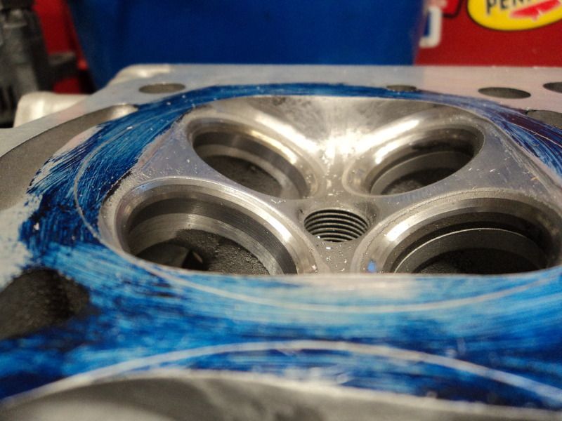

Well fished roughing the chambers now I just have to do the finale chamber cleaning and matching and I will be good to go I may knock some more off the sides but we will see
close up

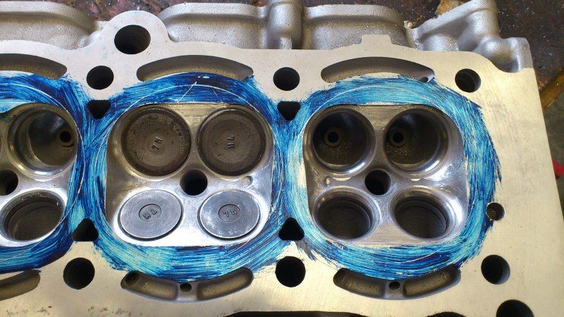

Well I whip out the big slab of meat today and started to work on one of the chamber's It's really close to being done.
All I have to do is cc it then call up JE and get me some pistons made up
the plans for the head are
stock size 2jz vavles
thermo coat the chambers
re grind my bc 272 cam's since the 2jz valve's are longer "maybe"
solid buckets
plop my old BC tie springs and retainers
