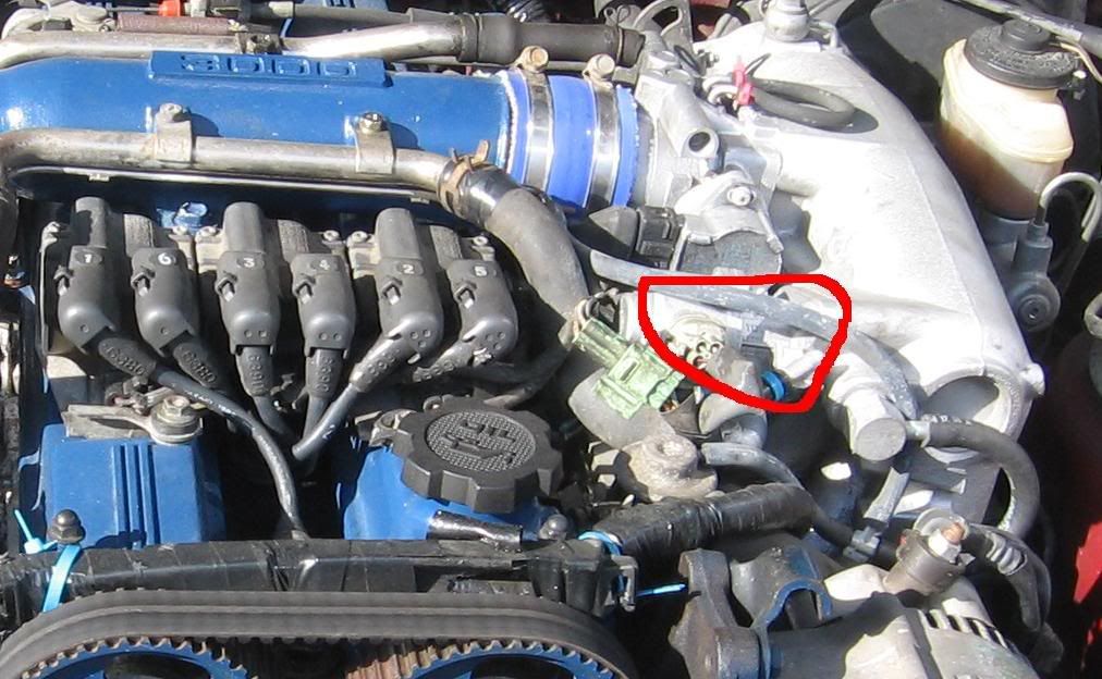

Ok well i swapped my TPS today unfortunatly the past 2 days have been a nightmare for working on my supra. Really need some help and suggestions as i am going to try again on monday. I swapped the TPS and my friend from toyota adjusted it but when i attempted to drive it i would get to 1750rpms and it would just cut all power and resume idle. i found out i had apparently broke the bottom bolt to SEE PIC not sure what it is called.
so when i go back monday i have to take off manifold and drill it out : / was my fault my guess is i cross threaded it. was very hard to get on for me atleast. anyway my car is throwing code 41 now for the TPS the one i had looked in good condition and came off a low mile car i have. i know that it couls be bad any 20yr old part can easily die but i need a list of options or things i can check to get my car running. before i swapped TPS's i could drive fine just had no boost. figured out it was due to the TPS. Swapped TPS in worse condition than when i started. When i go back monday i want to be prepared and get the job done if i know all my possible trouble areas i can knock them out. since i am getting code 41 i will start there any idea on how to fix it? need your input guys i have never boosted after my rebuild :( over a year ago so it is getting frusturating.
