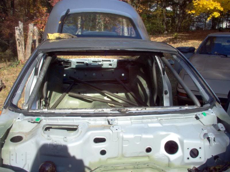

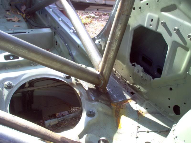

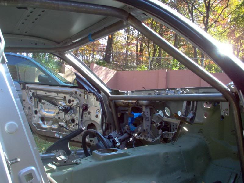

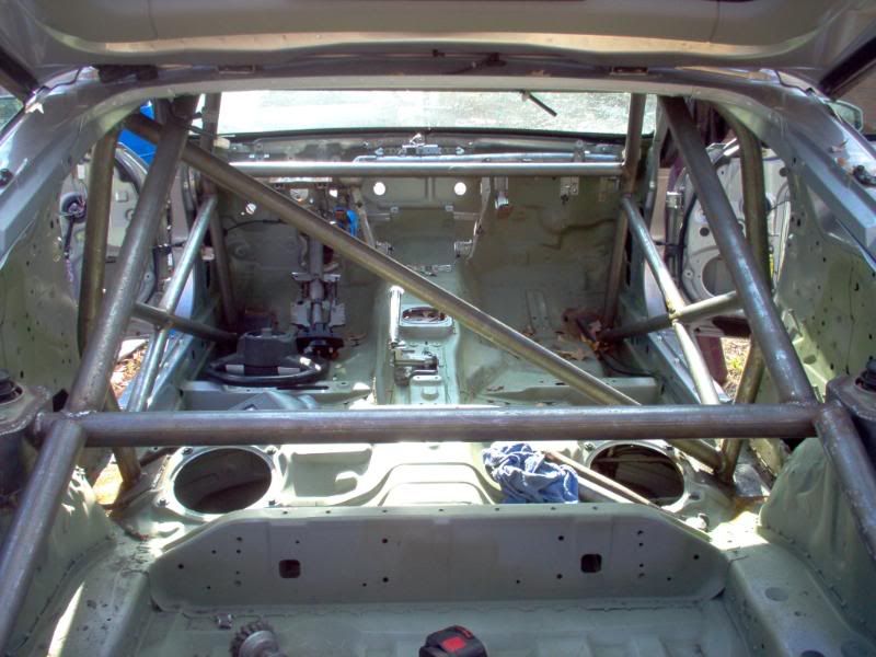

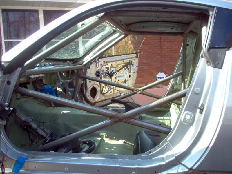

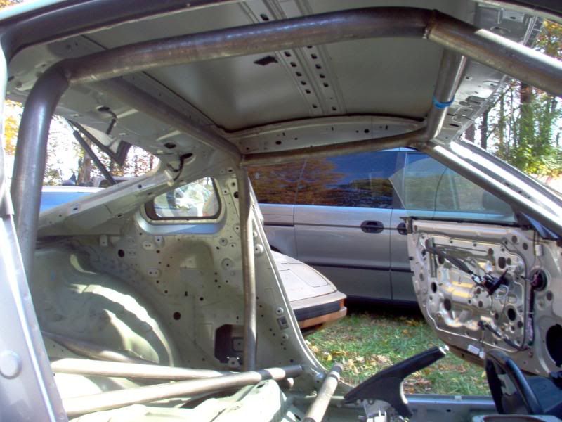

i dont know were to post this so here it is, so ok this is one of the things i do for a living, this is a rollcage i am fabricating for a customer in a 350Z from 1 5/8 mild steel .120 wall tubing; scca, nhra, nopi drft, and formula drift certified.
this cage certified nhra 8.50 when finished, as soon as i finish this i will post more pictures of the finished cage!

thanks guys, as for the tig welder i got it, but i use it only on chrome moly tubing, for mild steel it is ok with mig, the rx-7 on the background is going to be a 1/2 chassis (c/m) tubing and its been welded with the tig welder, also for my supra,,,, oops sorry i didnt have a supra but my 2jzgena-t 79 celica didnt have one yet but soon its going to have a (c/m) cage in it!

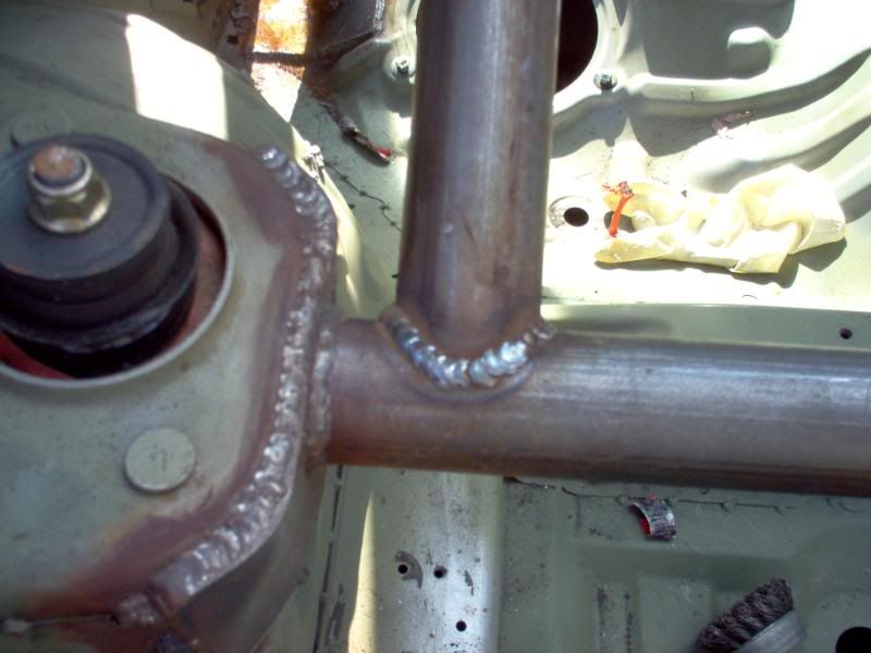

62
Are you saying you ARE a certified welder?
Not slamming you but they're some ugly ass welds if you are.
(uneven globby bad penetration and the surface rust won't be helping the integrity any, I've tested a steel cage unfortunately so have an idea how important it is to get it right)
