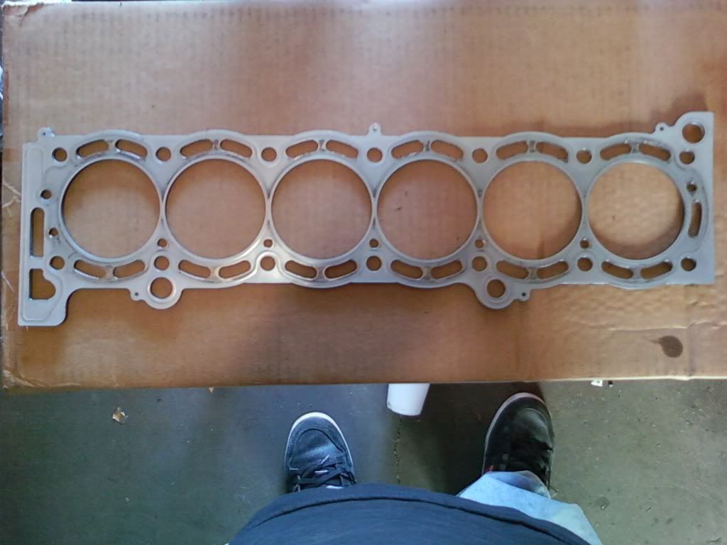

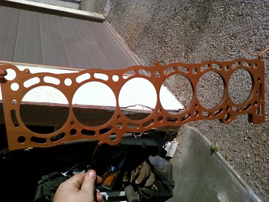

I got a 3mm gasket from a friend for free most of the viton was gone so I took the layers apart and cleaned them with acetone and put them back together then did a few cotes of copper spray on the bottom and top of the gasket then let it sit 5-10 min then set in on the block then put the head on then toured it down will I have any problems since I didn't pray between all the layers?
62
kakanator;1741674 said:
the motor is on a stand still I just have the intake on and vac lines I can still take the head off and do it over again no a prob just wanted to know if I should.
I would..
I know the way I do em works fine, can't say how yours will hold up.
62
I do mine as a tack coat, meaning as soon as you can just touch the copper and it's not runny/liquid assemble it, this needs everything being ready to go no hesitation as you only get 1 go at it.
Block with studs installed helps, drop layer one aligning it on the dowells then two and three, I use grease on the washers to hold them in the head.
(can't put the washers in once the head is down and lifting it will peel the cooper)
Lower the head onto the studs, moly lube the nuts and torque em down in 3 passes in sequence.
62
kakanator;1741695 said:
Found that out the first time I put the head on washers would not got on that is a great idea. So the rivets on the gasket don't have to be in I can just lay them down one at a time?
Yep that's how I did all of mine (reused mine 4 times each before retiring them)
kakanator
Apr 25, 2010
400
Fresno, California, United States
