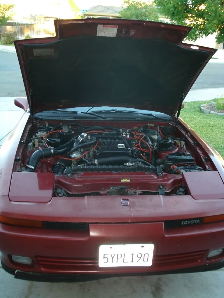

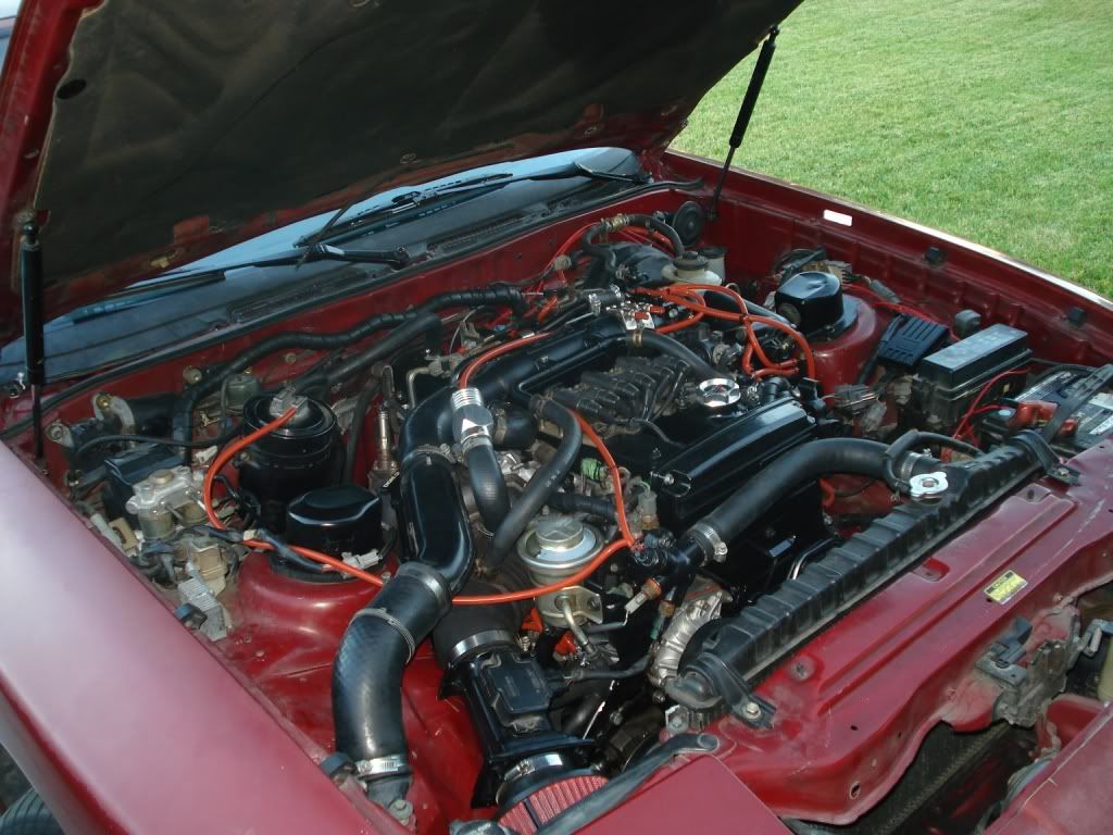

yup, gas related, but i left my return line and feed line open for the past 6 months... so most evaporated! hahahaha. now i have over a half tank and it'll run for however long i feel like. here are some new pics! and yes, im offically no longer a 'supra stick' owner... (see pics)
working hood struts FTMFW!!!!!
