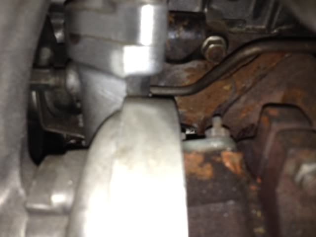

On my 1jz I do not have these coolant pipes(red arrows in pic) there are block off plates instead. After searching and reading different posts on different forums. It sounds to me like people say you can delete these pipes. Does deleting these pipes harm the turbos? Should I buy them and put them back on? Did I read incorrectly? It seems that eliminating a cooling system wouldn't be a good idea.

You are kidding I hope? Those lines are what feed coolant to your turbos, which is necessary on a water (and oil) cooled turbo. Take them off and you'll be buying new turbos a lot sooner than you'd like to be. ;)

The guys who delete those lines are probably installing oil cooled turbochargers. There's no good reason to do this with the stock turbos.

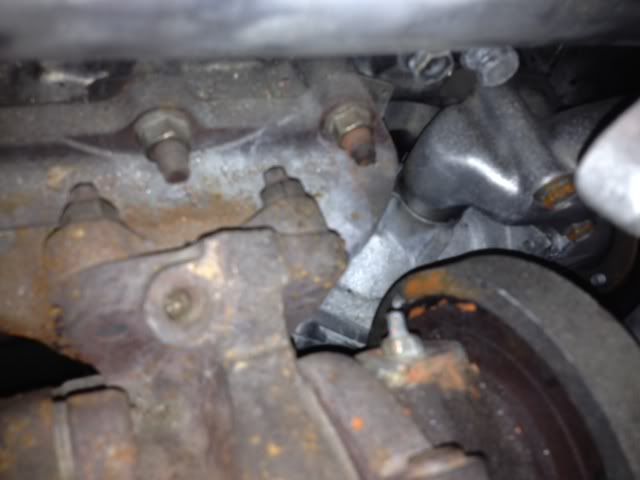

thank you for the info. I didnt think it was something that should be done. These are pics of my 1jz twins there not the best but you can see that someone before me put plates on them and used RTV silicone. Which leads me to believe the twins are probably going to be on the way out. I have found some flanges on ebay for turbo water lines. Has anyone done aftermarket lines for the stock for the stock 1jz twins? The ebay kits are the only ones i have found. Thanks

If you post a want ad in the classified section I'm sure you could buy a factory water line set from someone who's stock twins blew already. That would cost less and be less hassle than aftermarket lines.
There are lots of people with blown twins around the forums, I'm sure someone has them. I would give you the ones off mine, but I threw them away a few months back because nobody wanted them.
