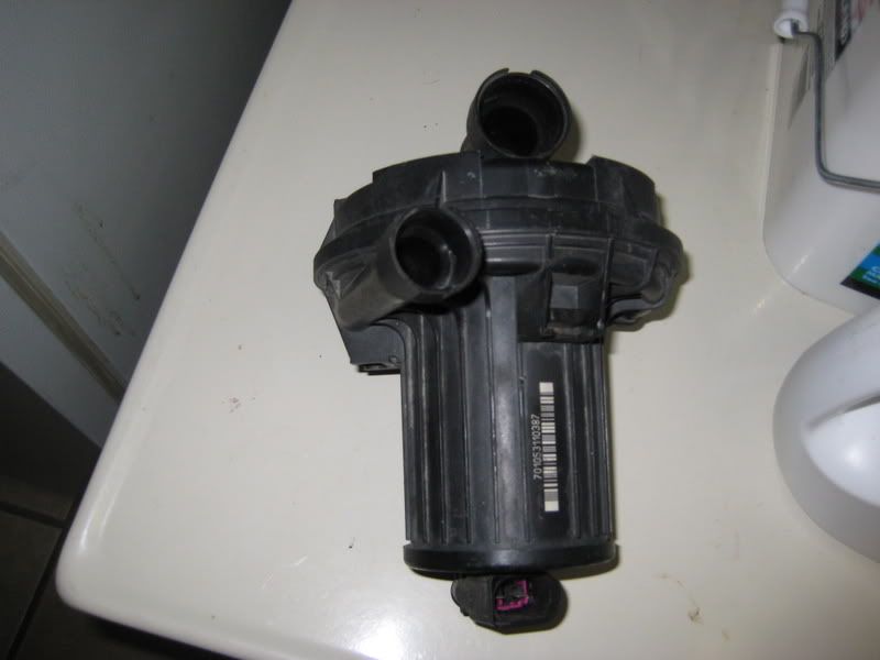

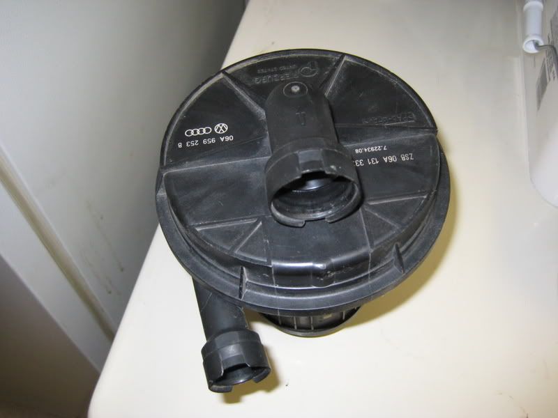

The GM ones seals don't hold up well to oil vapor from what I have heard. Here is the one I am going to use. Its the smog pump out of a 1998 VW Jetta. I have read that the seals hold up much better to oil.
This bad boy sucks some major air volume. It will pull about 7 inches of vac. which is just about perfect for a PCV system. The downside is that it also draws a ton of amperage. Startup amps are at around 45A and it continuously pulls about 17A. I will get around the large initial amp spike by building a PWM driver to ramp up the current to full 12V.
I plan on using the normal engine vacuum up until I reach positive boost, and then use a trigger off of the Maft-Pro to turn on the PWM controller.
We shall see if it works. I have not figured out the plumbing or anything yet.
