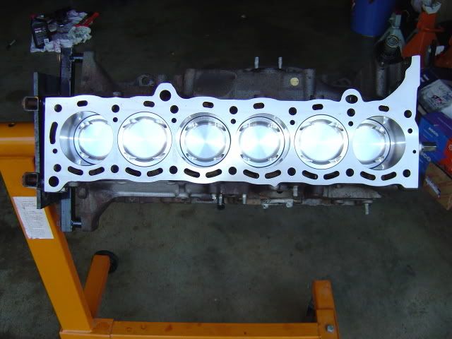

Pistons and Gasket Kit:

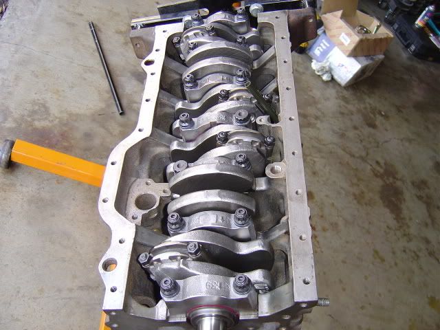

Well all the machine work is done, I needed to have the crank ground so I will be using .25mm over Kings bearings. The total for machine work came out to around 1475.00. I just paid a deposit today and will pay the rest on next friday and pick up the parts. I don't have a breakdown of exactly what every process cost but will update the price list when I get the final invoice. Pics to come...
JT87NA
171
SLC, UT

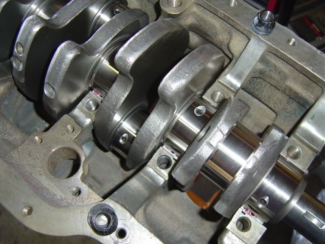

Prices are updated in the first post. I got my crank, rods, and pistons back from the machine shop today. The 7m crank I got from Malloynx was ground and polished. The small ends on the rods were resized. Everything was balanced. Here are some pics of everything.
malloynx
877
NC
looking good brotha. make sure they cleaned the oil gallies on the crank and installed fresh plugs
JT87NA
171
SLC, UT
I am almost positive he did but I will check it out. Never can be too careful. I am just waiting on my .25mm oversize Kings bearings and I can start assembling. Later.
malloynx
877
NC
yea, cleaning out the crank is a must. we have no idea what's inside the oil gallies in the crank. one blockage and your motor is toast
JT87NA
171
SLC, UT
Well if he didn't clean them out how would I go about cleaning it? I have access to a parts washer.

Well I am still waiting on my main/rod bearings and thrust washers, but today I hung my pistons on my rods. More to come soon.
