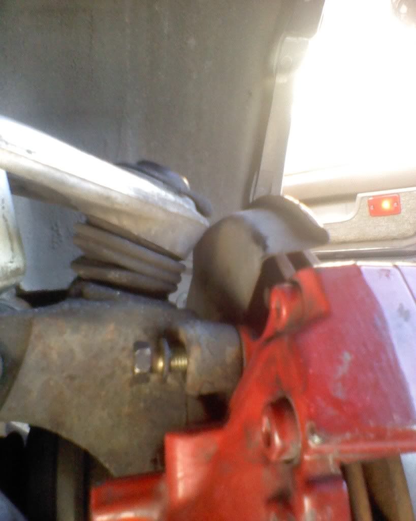

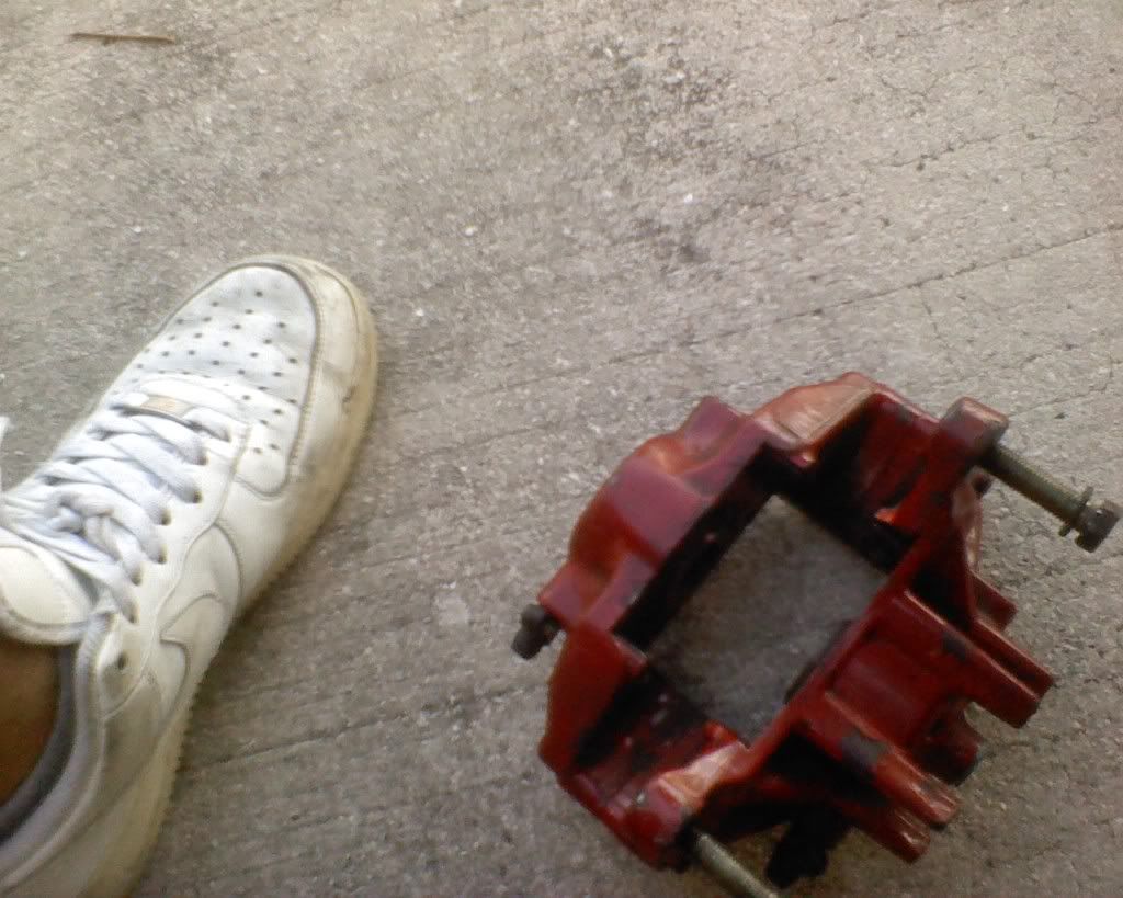

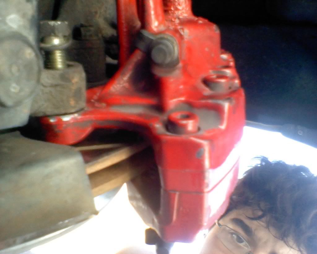

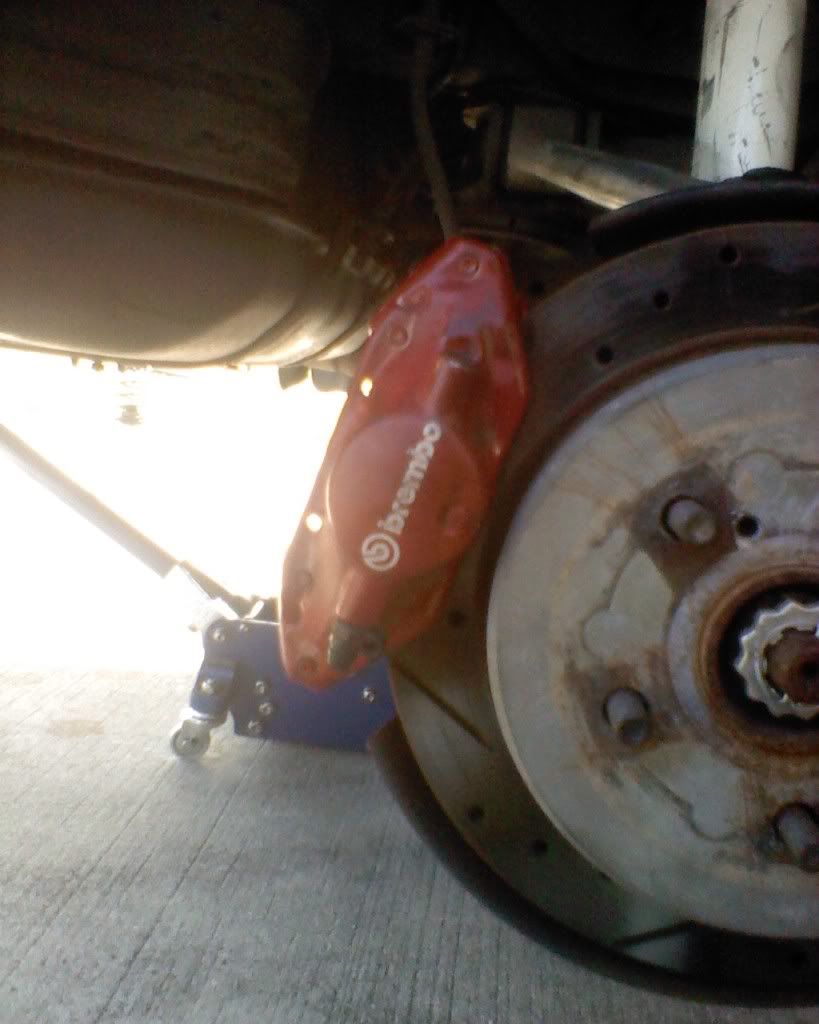

evo caliper bolts right up, only problem i ran into so far is that the supra caliper bolts are a little too big. They only screw in like 4 threads. Going to order a set of rear evo caliper bolts, and hopefully that take cares of that :) pics are coming.
xzeror
Oct 18, 2009
1,356
Miramar, FL
Pics for those who are still skeptical ;), again this is only the evo caliper bolted on.
