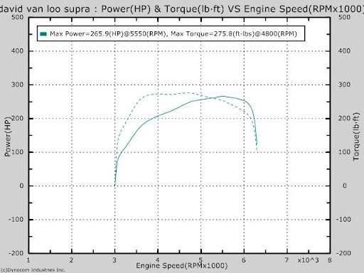

8/10/2011 Dyno Result on Stock Waste Gate Pressure
Old Dyno Result w/Unstable AF
Here is the latest news: Wryann of VIP Performance, was pleased to announce that the Supra was successfully tuned using the new JDM ECU. As I recall: the motor now consistently stays at the set AF and is making reliable power and torque. He isn't too sure how close the valves are to the piston, so he didnt play too much with the cam gears, but enough that he was able to get more power in the top end, than in stock setting. Wryann also spent time road tuning the 7M. We talked about taking the 7M to the track to do a test and tune.
Wryanns email: "The best dyno sheet from before was very similar power and TQ numbers, but I was never able to get to redline without hearing "knock" so I always had to lift!! Remember I showed you A/F log readings and you could see they were very un-stable. This time around I was able to maintain very smooth A/F under boost and I was also able to get consistency/ repeatability every run. Cruze A/F and idle is 14.7 and under full boost 10.8-11.1 A/F."
The next dyno run will be to start uping the boost to see how much the system will take, until the EGTs start climbing too high. Wryann has set the Supra up conservatively for DD. I want to know where the upper limit is so when it's time to race, I can set it to a preset boost setting that is known to be below that upper limit!

Devin LeBlanc;1747096 said:
Nice, same dyno we have at our shop.
Thanks, Devin.
Any decision on your Supra's future?
---------- Post added at 09:00 PM ---------- Previous post was at 08:56 PM ----------
I was looking closely at the dyno graph... Am I nuts?! Is the JDM ECU letting the engine rev to 6800?
