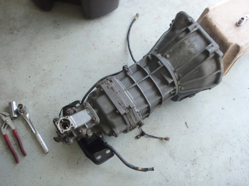

So here it is on my garage floor....
Disassemble the shifter support...

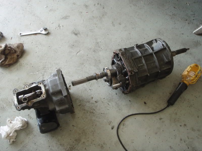

Remove the bell housing...

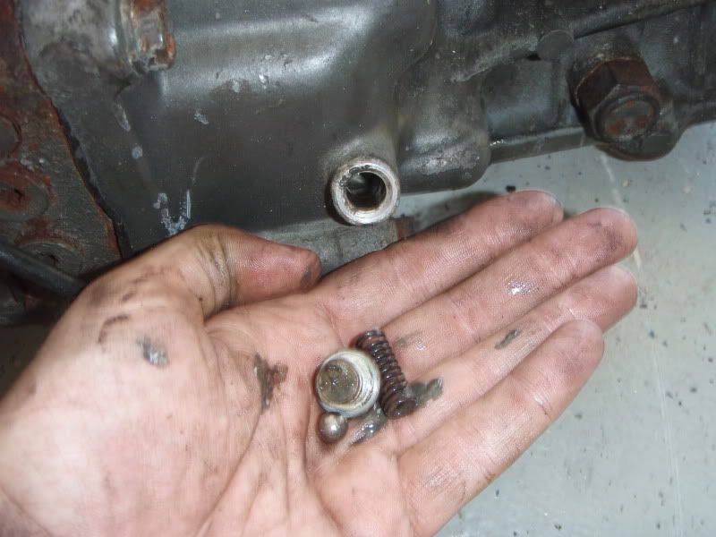

Remove all the acessories (sensors, torque nuts, springs, bearing balls, etc)...

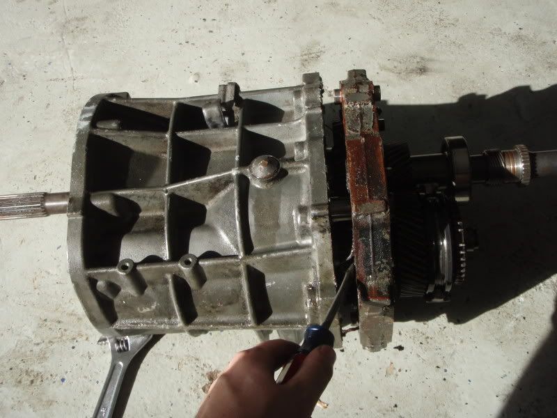

Remove the rear case...

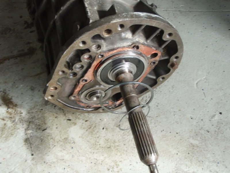

Remove snap rings...

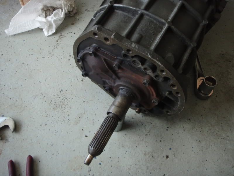

Remove the front case...

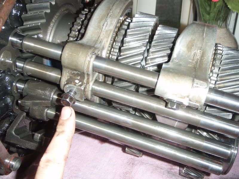

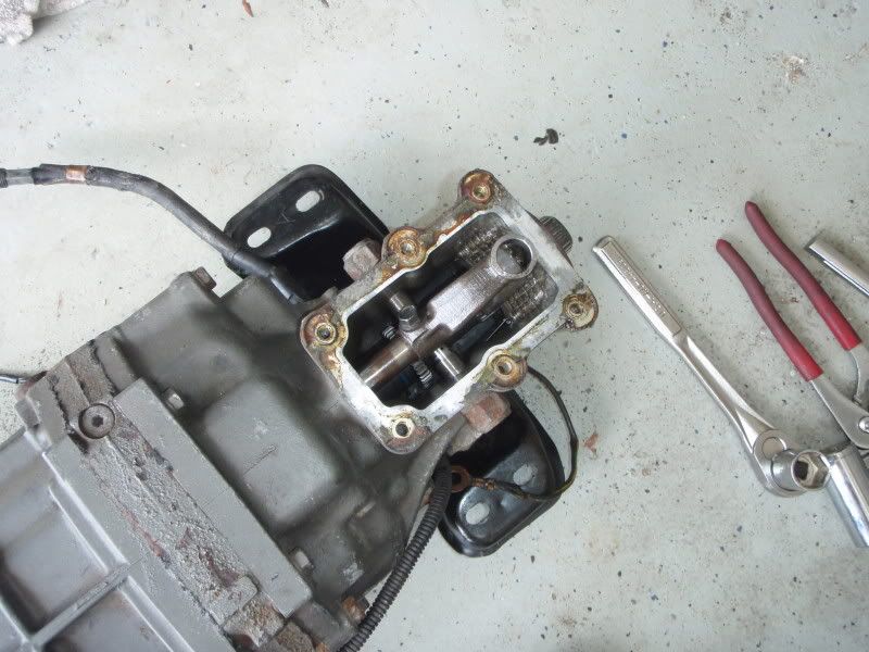

This is the first thing I notice. This bolt is completely backed out! Normal? Which fork is this? Is this my problem? Note: The threads on the fork still line up. I could reinstall the bolt in the position the fork is in.

Does anybody have anything to say about this picture? If this rod has ANYTHING to do with first gear this HAS to be my problem. When the bolt is out the rod slides freely back and forth. THe bolt was literally hanging by a thread and I could tell my the wear on the bolt it was smacked back and forth until it came loose.
I already replaced the bolt.

yes. LOL.
that is what moves the sleeve (round thing over the hub) over the little splines on the gears. as you can see when you "grind the gears" you actually grind those little splines against the sleeve. what i find weird is you didn't have a problem with second gear. it could be that second didn't have enough play in it but first did. so thats why it only popped out in first. i can't say for sure but that fork is for first and second so you should be good. as long as your first gear doesn't slop back and forth a mile...
and zum i dont mind. that was just for a pic though and if you do use one of those make sure you put a small plate of steel over the end of the shaft so you dont mangle it.
