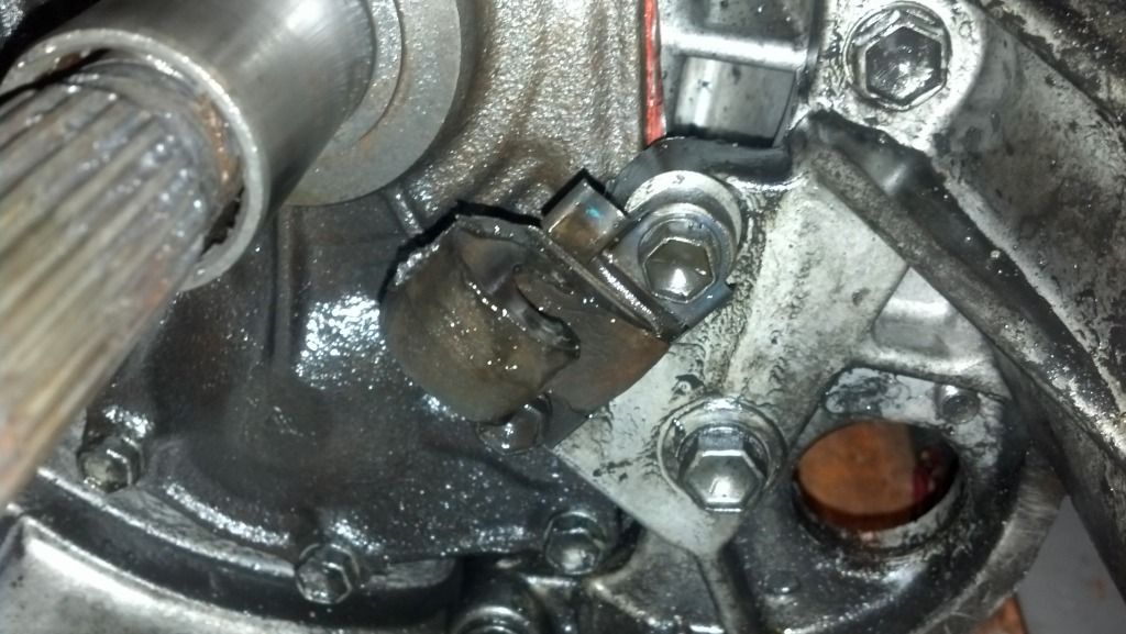

So with the clutch fork is there any sort of clip or pin that keeps it all together . This is a swap and I got the tranny and a box full of parts. The TSRM didn't show that assembly process and if it did I did not see it.
Brand new bell (JZ), so I have a small thin clip type thing that appears to be able to bolt under the bracket that has the hook for the fork. Is that the clip and does it in fact bolt under the bracket?
Yup , that's it. Thanks for taking the picture. I see that Driftmotion sells a clutch alignment tool like for every other set up. Has anyone ever tried to do this like you would on a w58? Other then the shift fork why does the TSRM suggest that you do it this way?
