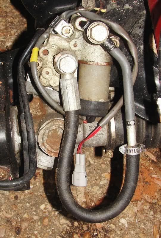

I have this power steering delete hose that was on my shell when I got it. $15 shipped, and you can have it. It's already boxed and almost sold once.
That would be cool, but that rack looks a bit different then mine. I heard that the rack changed in 89, my car is 87 what year did that come off of?
