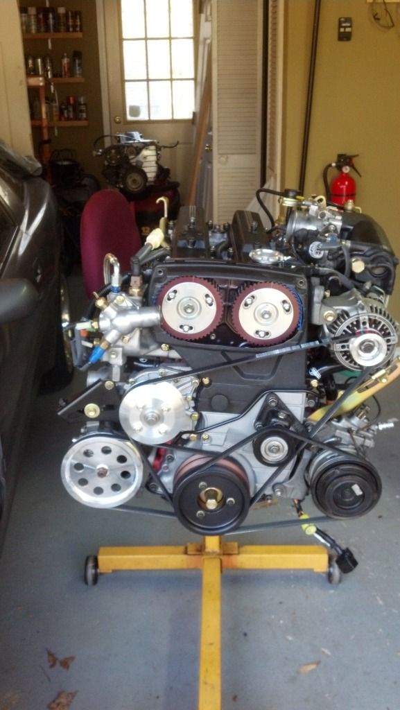

Engine is almost ready to go in:
Just need some help finding where a few hoses go.
What hose goes here?
Left side of the intake manifold. Looks to be coolant, but I don't see anything.
Where does the other end of the idle valve go to with this throttle body set-up go? I know where it goes on the throttle body that came in the car originally.

That coolant tube under the intake manifold goes to the iscv.
Then another one leaves the iscv and goes to the throttle body.
Then another one leaves the throttle body, and goes the the small pipe at the end of the wrap-around coolant pipe, under the egr valve.
ps- the motor's looking good.
Kinda looks like mine.
