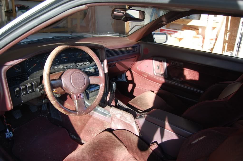

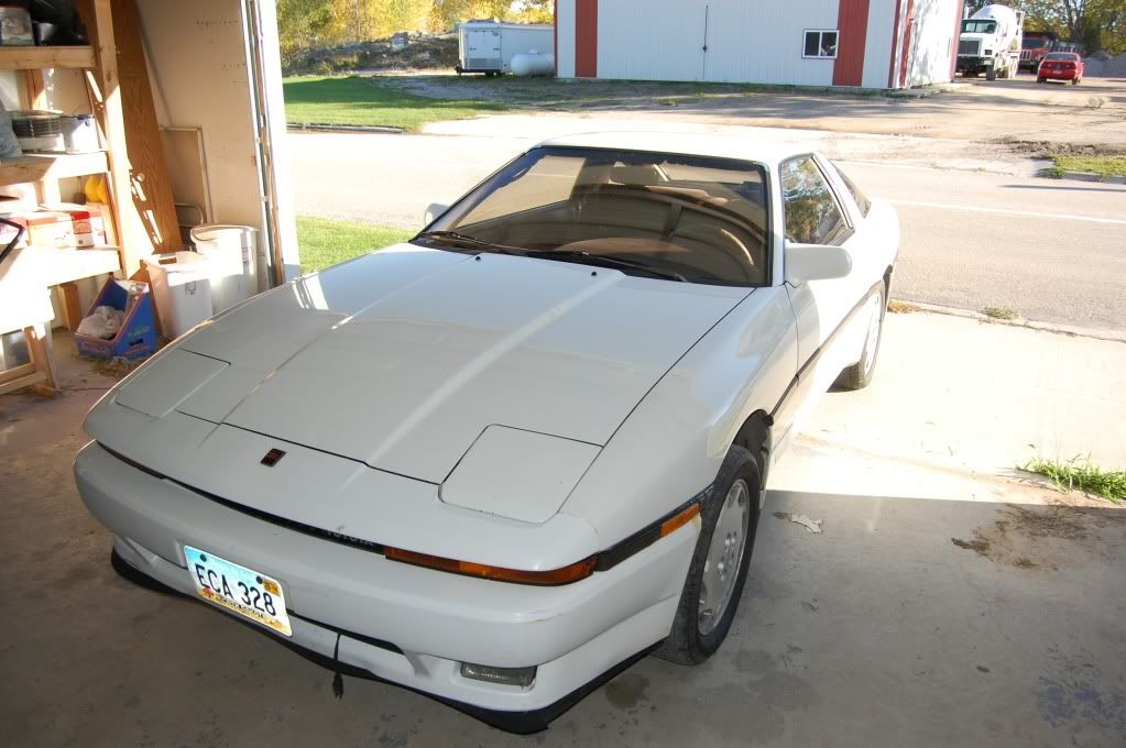

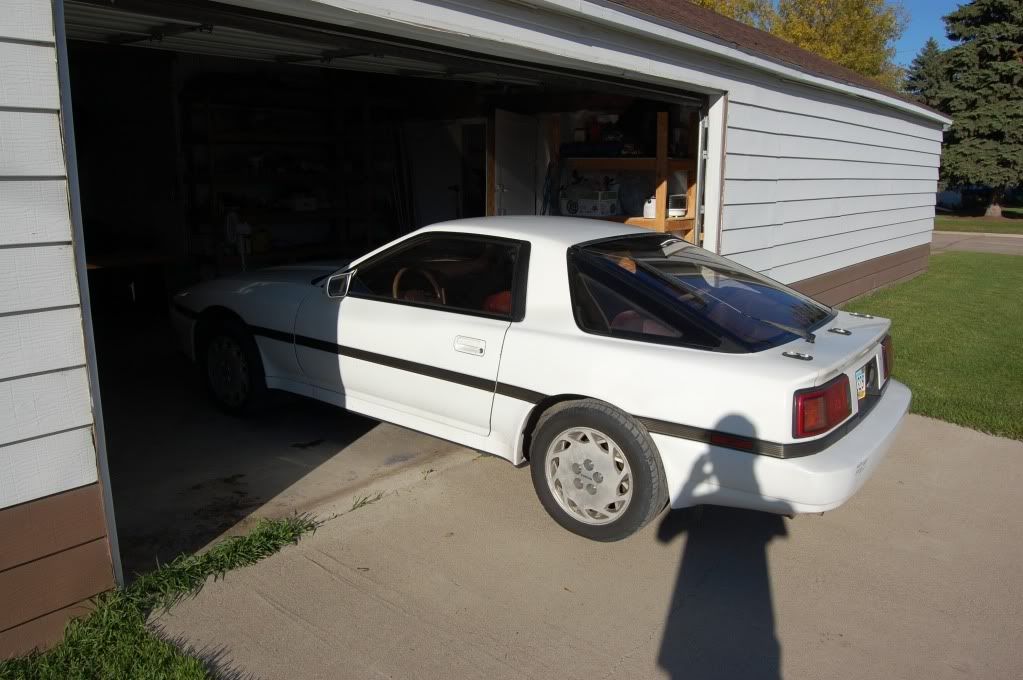

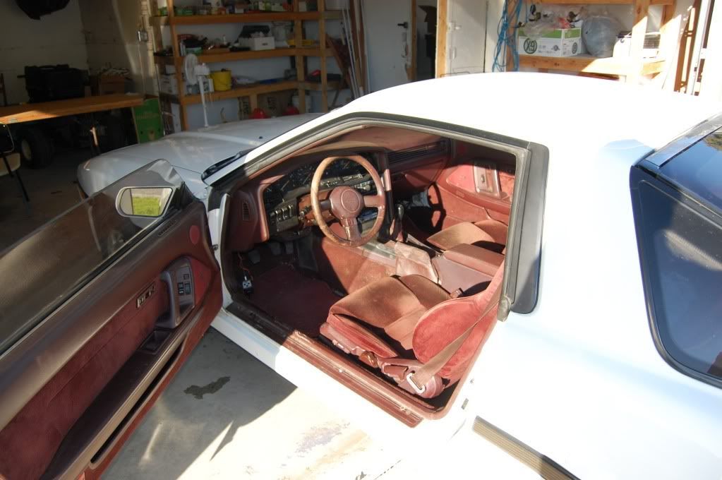

Just a few days ago I obtained a 1987 N/A 5-Speed with 159,xxx miles on it. It is in overall good condition, but has a few issues. 1. The gas tank is leaking a little bit. 2. The speedometer is not working at all. 3. Random interior bits are missing/broken.

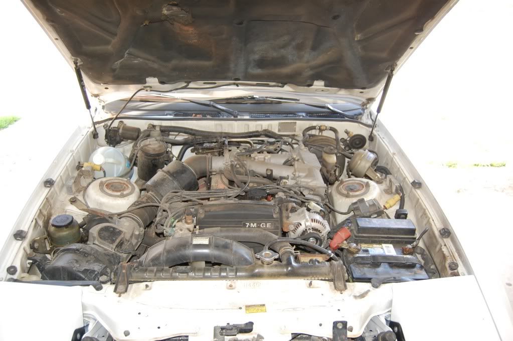

What I want to do right now is fix the above issues, clean the engine bay up (dirty as hell), put the wing on (not my choice, but the p/o put a turbo hatch on and the mounts are there), and get it licensed and insured!
Down the road, I want to throw some bolt-ons on, lower the car (rides like a truck!), and get new wheels, the sawblades are not my style. Well here are some pics, and throw out any advice on it if you have any!

I don't mean to hijack your thread but is it ok if I ask: Can that steering wheel he has be fitted with the 89+ steering wheel?
I have a tiny suggestion, when getting your interior parts, assuming you want to replace them, try to find used. I have found the fade from the burgundy is quite dramatic. If you replace with new, maybe replace symmetrically ie. both seat belt holders if only one is broken. Only if that sort of thing bothers you, just a thought.
Clean Hardtop, nice. Congrats on your purchase.

You mean- can the -89 wheel be replaced for an 89 wheel?
Yes. But to get the cruise control buttons to work, i think you need the 89 combination switches also, as well as at least one splice for on/off into
the dash switch harness.
