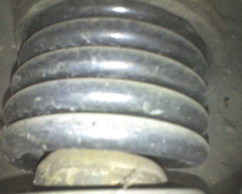

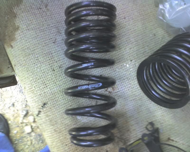

Poodles;1463910 said:
Also, progressives are worthless as there is a progressive geometery in our suspension design already (stock springs are linear).
I'd have to agree. Here's what a set of Eibach Pro's look like uninstalled.
Here they are installed on a Supra with Tokico Illuminas.
Notice the top of the spring just rests on itself pretty much defeating the purpose of a progressive setup. I guess if you go over a steep incline and the car lifts it may produce some benefits.
