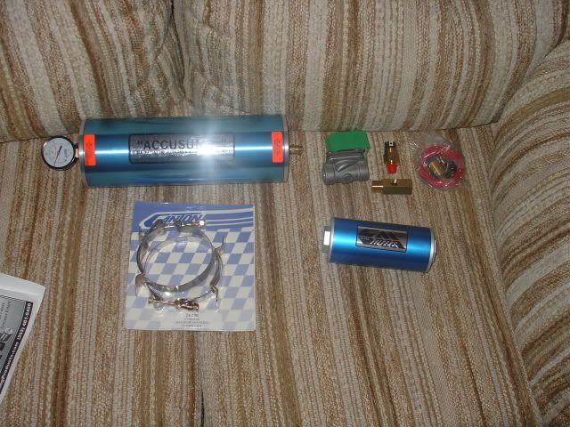

Got these in the mail today from Zumtizzle:

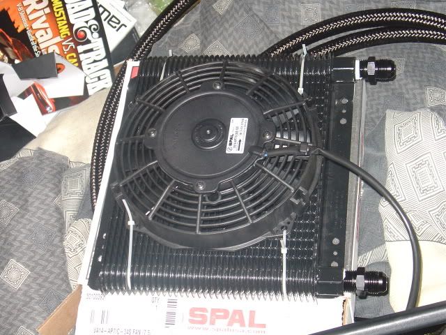

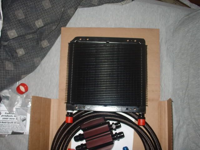

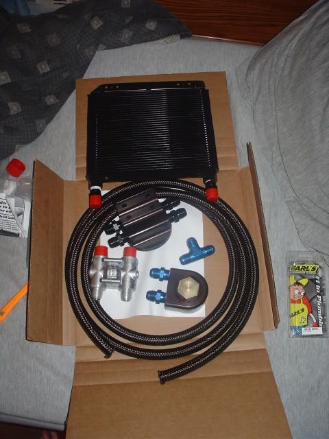

And various parts for my oil cooling system:
Closer up of the cooler:
I just need to pick up the Accusump parts, the SPAL 7.5" pusher fan (flows 440cfm), and the various Earl's Ano-Tuff hose end fittings to complete my oil system.

rtrdpenguin;1612459 said:
Dang that's a beefy cooler! Any pictures of how you mounted it?
not yet but I'll take pics next time I rig it up. It's sorta slant mounted with the top fitting going over the frame (directly over the bolt that holds the crash support beam to the frame) and the bottom fitting sitting in the little half-moon of the stock tow-hook.
I'll need to get pics. But yes, very beefy. Dimensions are 8" x 11" x 1.5" with 1/2"NPT fittings

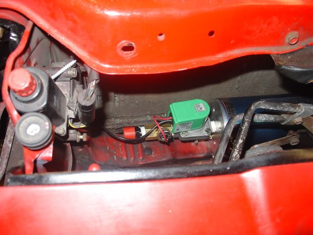

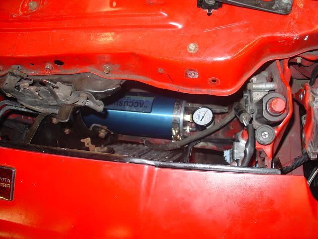

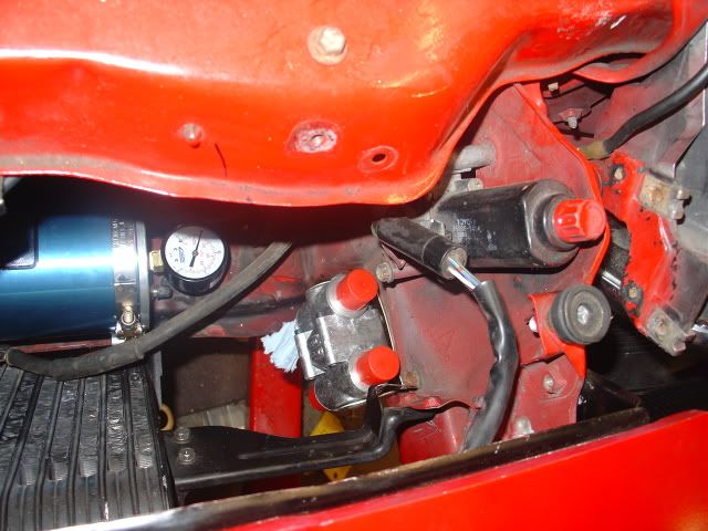

So I got the Accusump mounted and the EPC partially wired in. I just need to run a wire from the pressure switch to the toggle switch in cabin, mount the toggle switch, then run a wire from that switch to a switched 12v source on the fuse block (or tap into another wire that has power when the ignition is switched to "ON")
I also have the Mocal thermostat mounted.

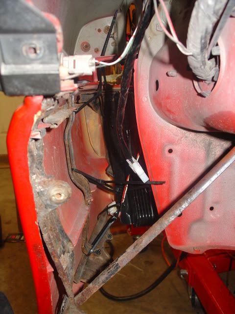

Picture update!

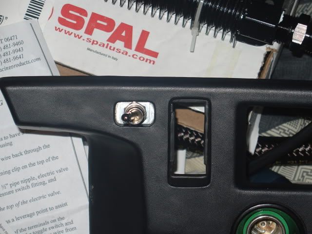

I mounted the toggle switch for the Accusump's EPC in the space where the headlight squirter button would go. I did a squirter delete, so I did a button delete too :)

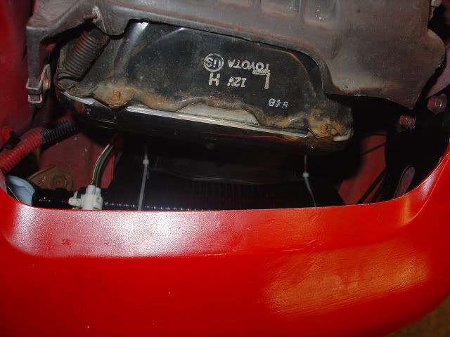

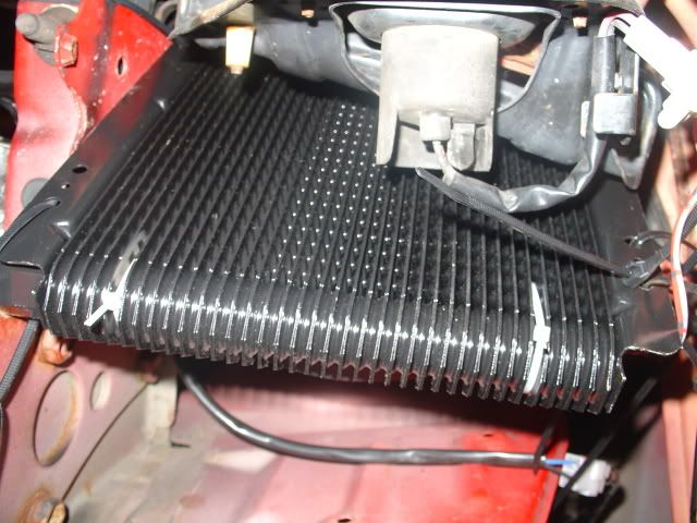

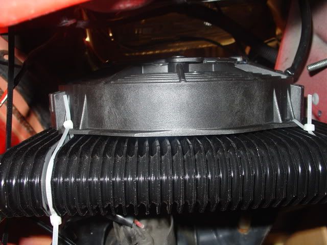

I got oil cooler and e-fan mounted. The e-fan is just about the perfect size for the cooler, and they still fit snug up under the headlight. Everything is held in place by zipties, but it's going to stay put...
Pictures that should have been in my previous update...
Mocal Thermostat:

Zumtizzle;1615197 said:
Pusher.
well err puller. ;)
too late haha. I got a pusher, primarily because there is going to be very little airflow coming from around the fog light. I decided that pushing cool air through the cooler would be better than pulling the heat away from it haha
