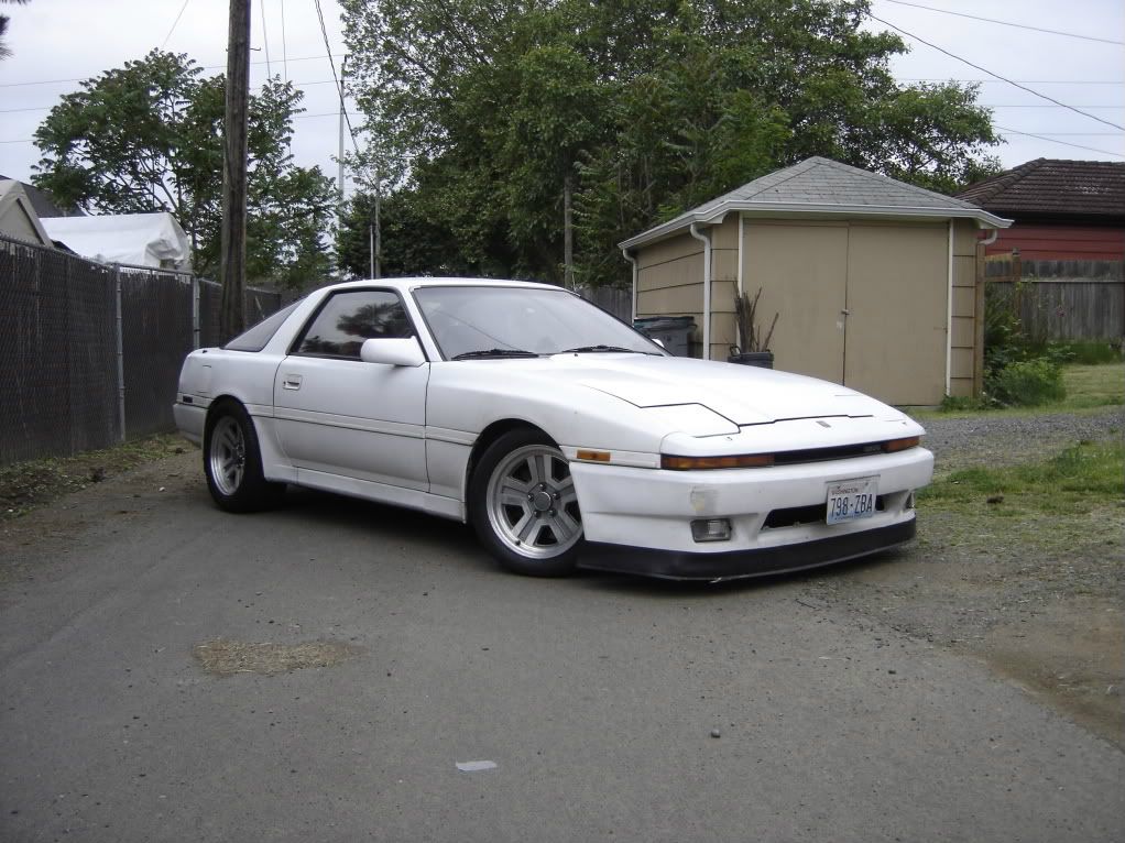

this is after about 6 months of thrashing also!

I Just took some flat metal plates not sure of the gauge but it was hard to bend right.
then I bolted them to the stock lip mounting points. next i used pre drilled steel strips
on the bottom of mounts and bolted them together. thats it for the backing. I used
cove base for flooring for the lip material and 3m double sided tape and a few hidden
zipties just for to hold on the lip. my car is really low with it and its gets pretty wrecked.
thats why i made this. so i dont feel bad every time i wreck it a little, it just bends
right back!

Have you tried it out at the track (PIR), to see how effective that air dam is at reducing air getting under the car? Has there been any noticable change with the handeling of your Supra at speed, post air dam install? Van

Not to much of a difference anymore but when i put it on i definitely noticed my
front end wanted to stay planted a little more down. and no i have yet to take
it to PIR, I want to but its quite expensive, i was going to do some of the porsche
club auto cross races but i got rod knock and ended up rebuilding so maybe soon
or next year!
