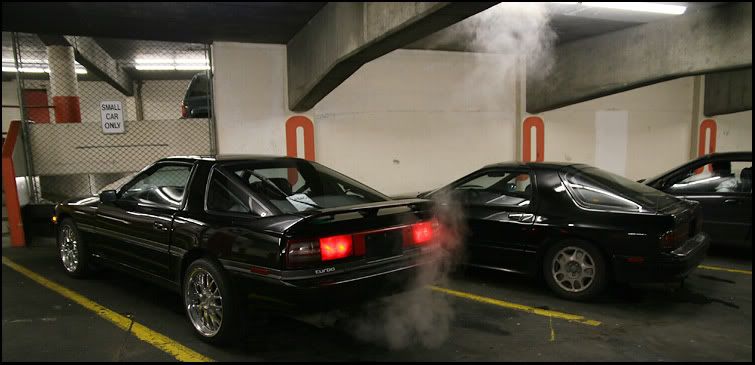

It is cold, but i can smell gas in the smoke..Actually hold on, i've got a pciture of the smoke it spews out. Almost positive it isn't from the cold.
Here:
Here:
As for idling for an hour, I locked my keys in the car.......twice.
I don't know how long the car has been running there but that seems to look like an acceptable amount of smoke for a cold day startup.
Does the smoke stay the same while driving for an extended period of time? If it's still really smokey after a long drive, look into bhg a little more.
