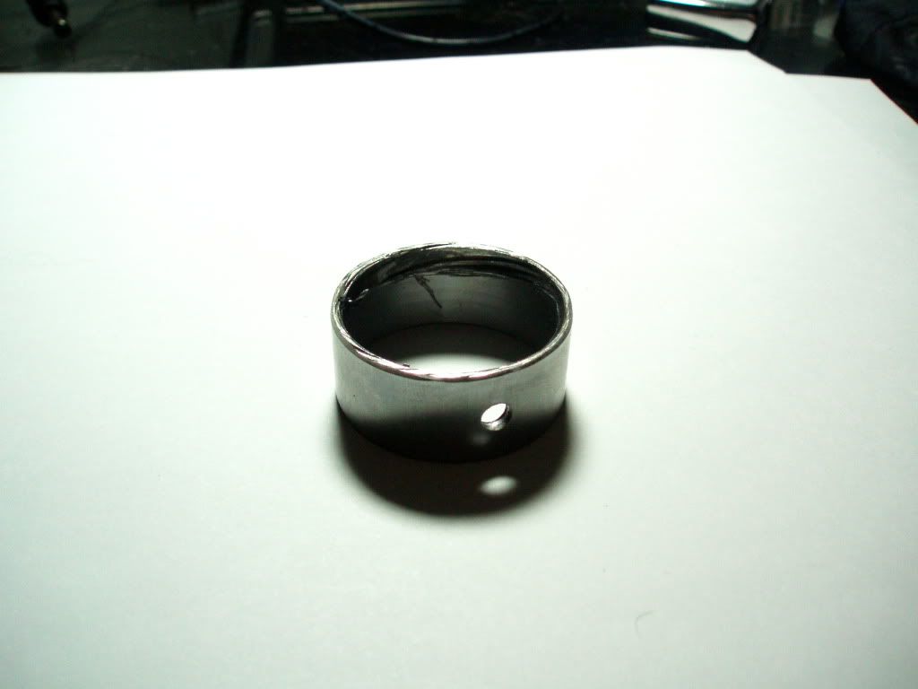

So I found out the shop hadn't removed the oil pump bearings for when they hot tanked the block, retarded, so I tried installing them myself. The socket I used to tap them in with wedged itself into the smaller inside bearing and messed it up.
I found some more at napa (tai-ho brand), and I discovered that for some reason, of the two dura-bond bearings (from SIP) that the larger one had no oil hole in it...I didn't notice this until I purchased the new bearings from napa and compared all three sets (toyota, durabond, and tai-ho).
This time I'm getting a friendly mechanic I know to install the bearings for me haha.
But this cant be right...the Toyota bearings have an oil hole for a reason...why the heck does the dura-bond not have an oil hole?
I'll post pictures later when I get home.
just wanted to point out that the dura-bond didn't have an oil hole, I would get in contact with Rich (purchased from SIP) and let him know, but I already messed up one of the bearings.
needs the oil hole, id still let rich know anyways, probably a bad batch and needs to be recalled.

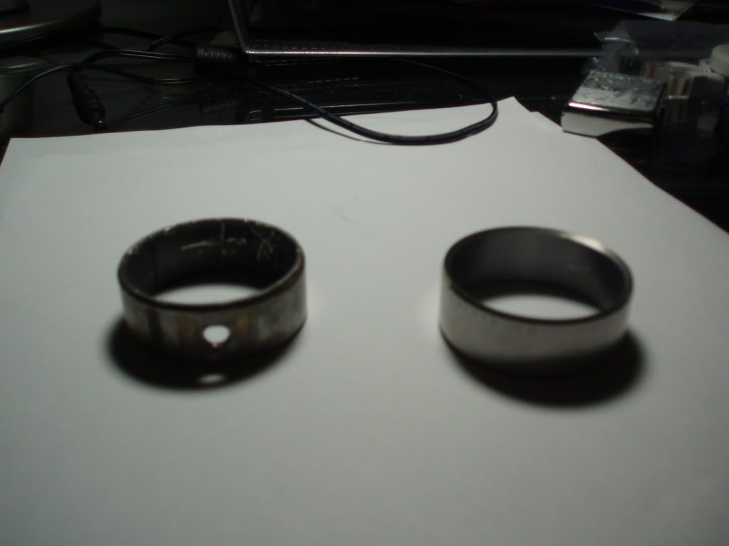

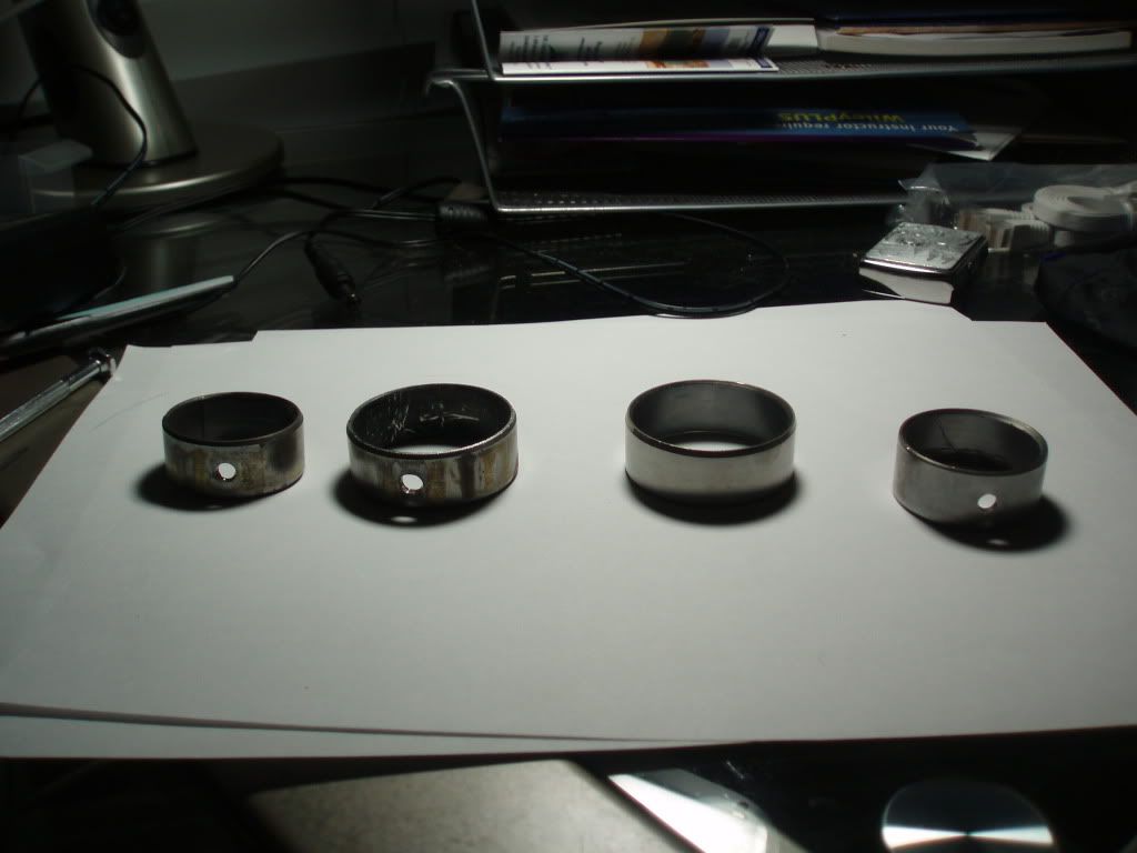

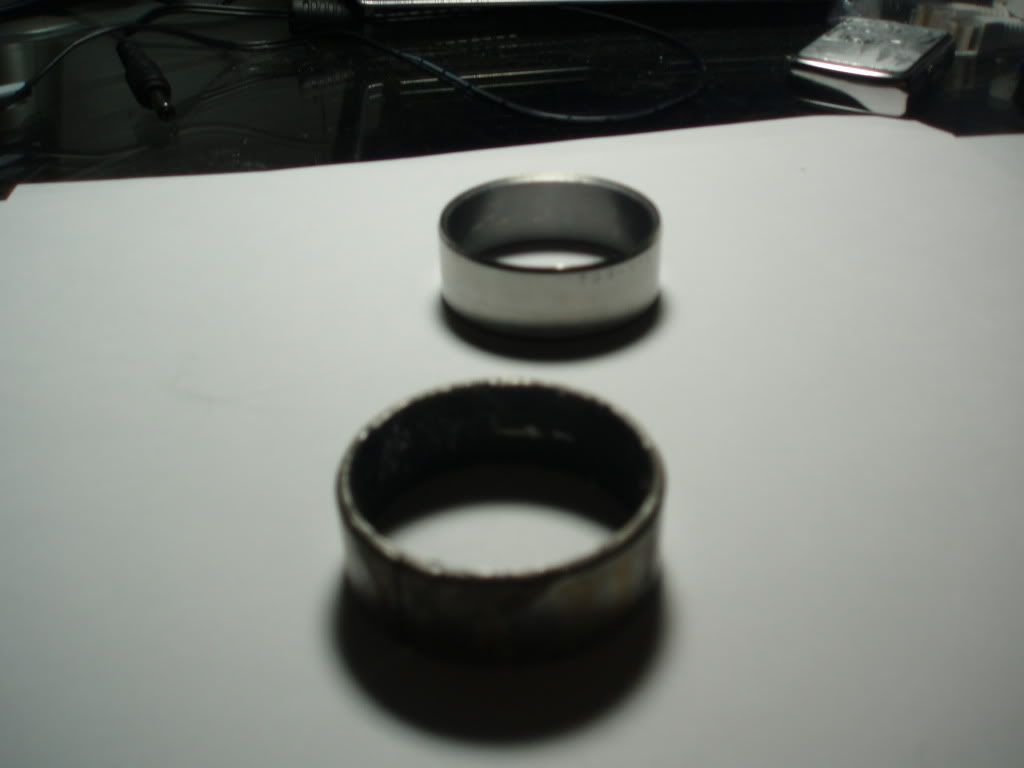

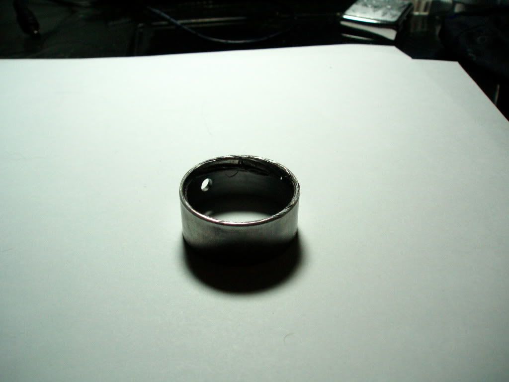

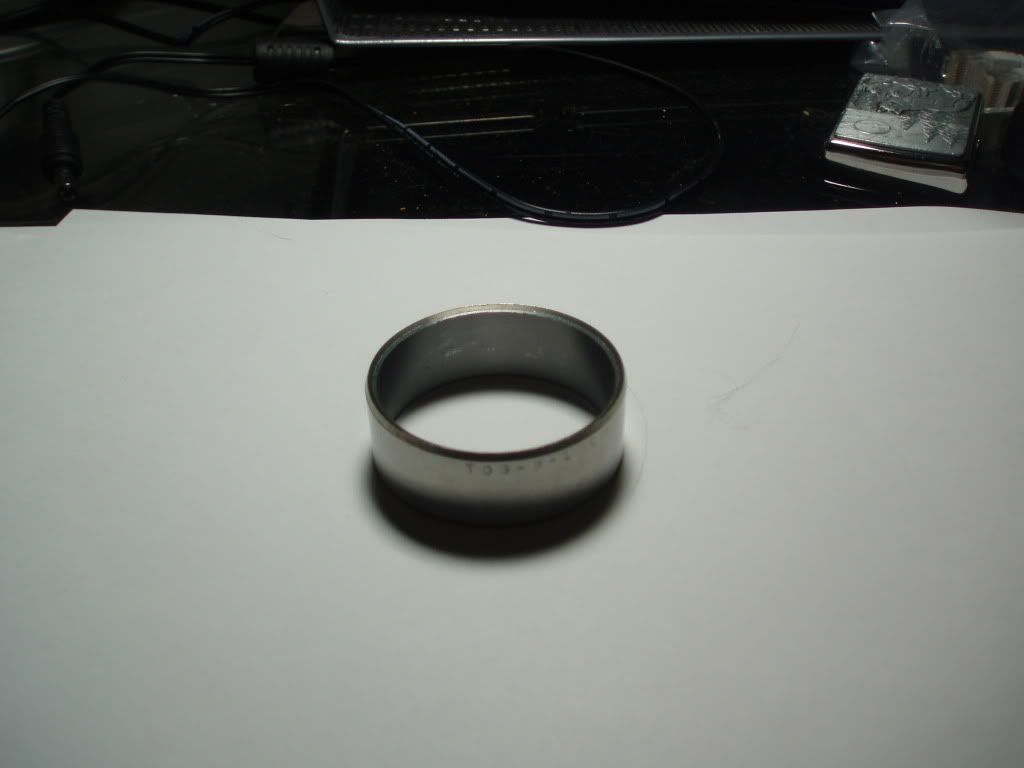

pics of the larger bearing with no oil hole:
old Toyota bearing on the left, dura-bond on the right:
Toyota on bottom:
Both Toyota bearings on left, with both dura-bond on the right.
I'll direct Rich to these pics/the thread to let him know, so no one can have any grief from this, that would totally suck if anyone's engine got a knock because of an $8 bearing...

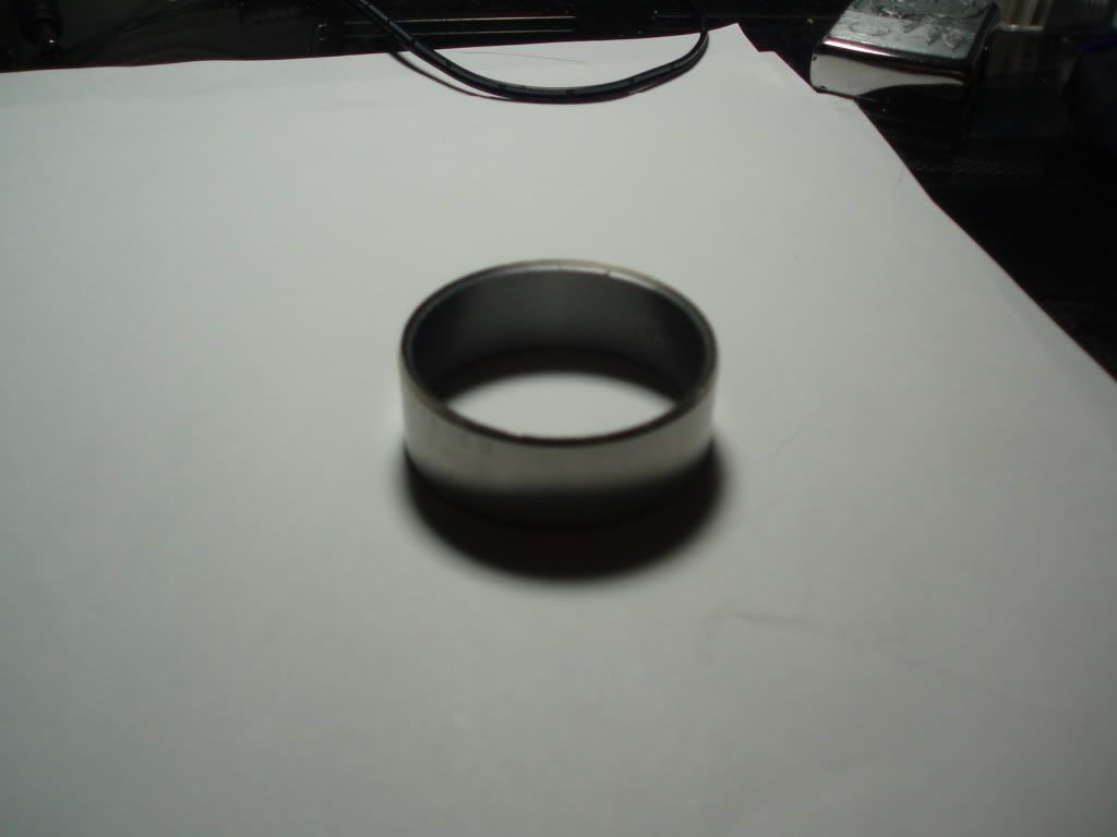

EDIT: Here's a pic of the small dura-bond bearing after I got my hands on it...and used a socket to try and whack it in:
Moral of the story? Just get your damned machinist to put these in lol....
