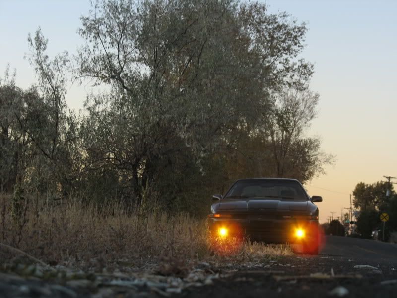

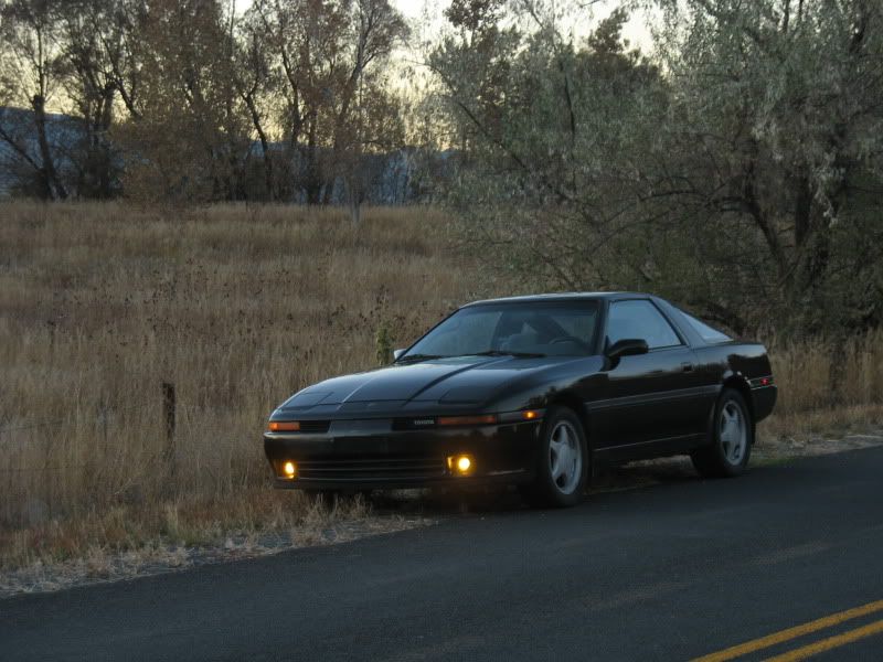

I always like the idea of more useful fogs on the mkIII. Enter projector goodness. ;)
Kit is nearly complete. I still need to source more wire connectors and add the option of a clear, custom cut piece of plastic to fit over the round Lexus lens. Anyone know if any other cars use the stock foglight connector found on the mkIII?
The kit will feature fully adjustable horizontal and vertical movement, wiring harness that plugs straight into the stock connector and projector goodness. I will post a side by side comparison, but the difference between these and the stock fogs is huge.
These are plug and play. That means NO cutting wires, NO drilling/cutting/fabricating needed. You can keep your stock fogs and wiring completely intact.
Lights on:
Lights off:
Thoughts? Suggestions? Options you'd like to see?

The output from these looks really good. I'd definitely be interested when the kit is finished.
The only problem I have is that I hate the look of the round lights in a nearly square hole...

Used these this week in the snow/rain and they help a ton more than the stock fogs. Really lights up the edges of the road in front of you.
Still waiting for a day off when it isn't raining/snowing so I can find more wiring connectors.
If anyone is interested and doesn't want to wait, I'll give a substantial discount if you can send me the foglight side connector with a few inches of wire still attached... ;) Say... $50 shipped back to you. That'd include bracket, Lexus fogs with bulbs, and wire connectors soldered, wrapped and insulated.
