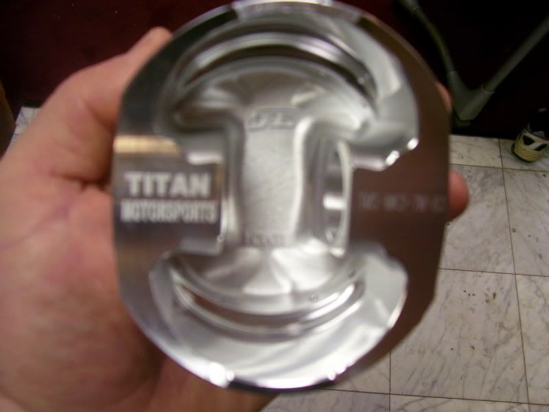

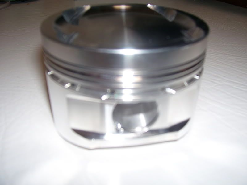

titanmotorsports_2000_23356439
titanmotorsports_2000_24293675

IJ.;1006194 said:
Very nicely finished!
Pity the 7M guys quibbled about the Coating costs.
What was the dish volume again?
(looks too deep in the pics to be 9:1)
-14cc's including the valve releifs.

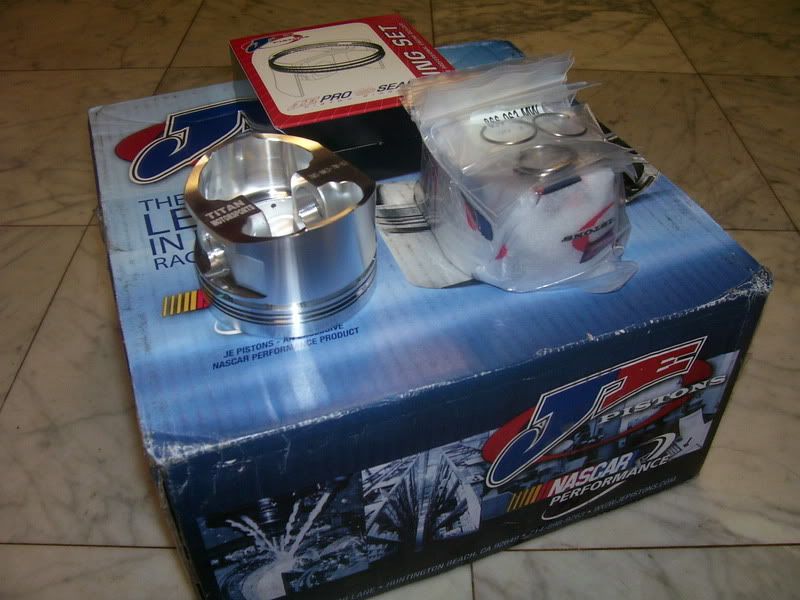

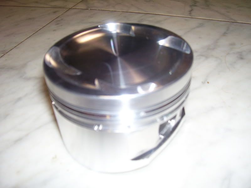

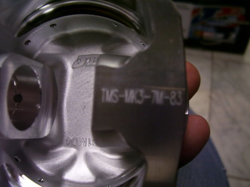

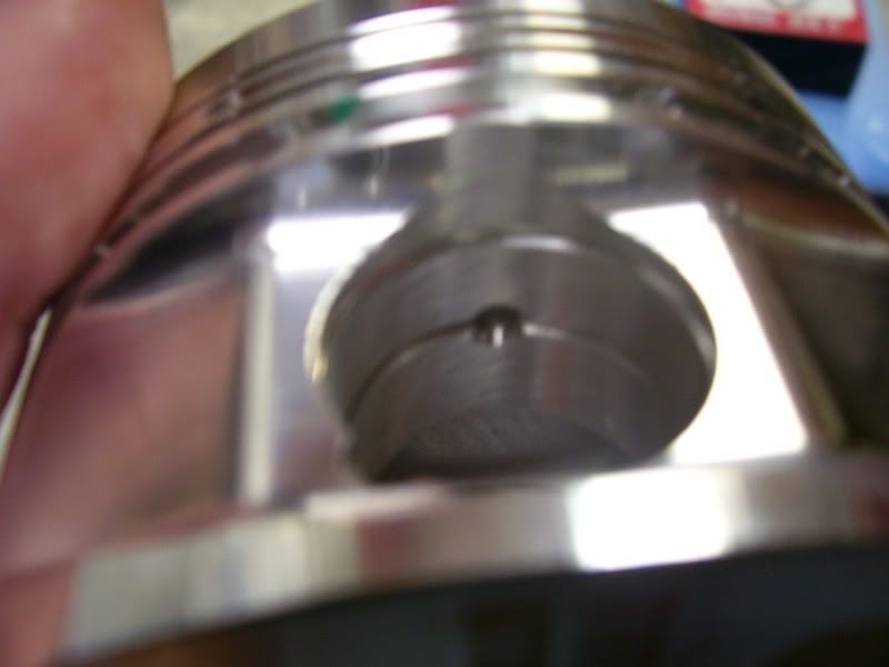

Pistons are now in stock and ready to go. I have 9 sets. Here are some more pics of the pistons.
PIN oiler
