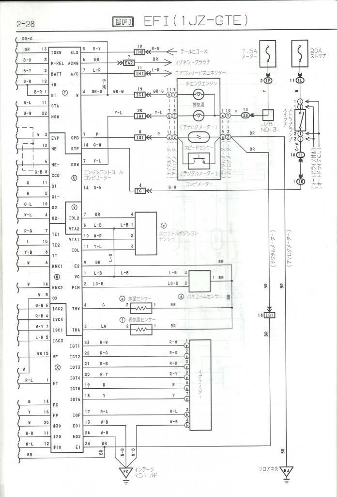

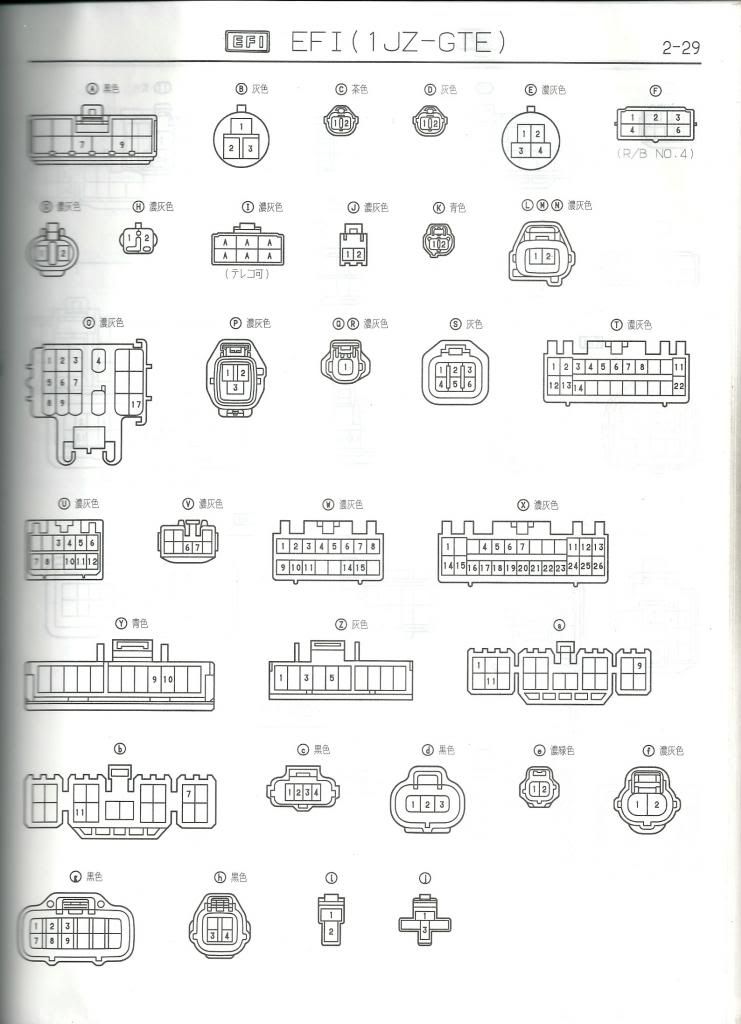

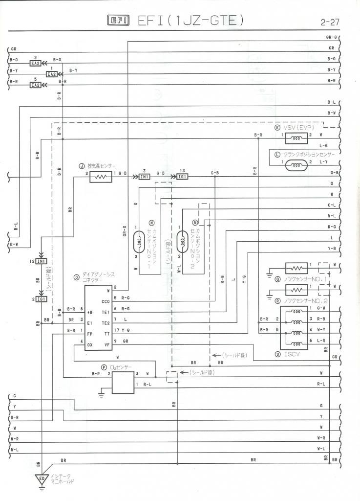

Hey everyone,
Could someone please upload a picture of the wiring to an IACV off of a 1JZ JZA70 Supra. I think I have mine wired wrong. I'll even toss $5 to the first person to send me a good picture of the plug/wiring so I can get mine wired up properly. I know I'm not the only one with a 1JZ MK3!
Thanks

Scanned in a couple pages for ya even though they're the same as ma70
jza70
ma70
