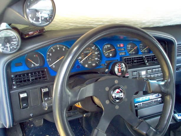

here is a pic of one of the two of mine. the one in the pic is the bride ebay one. no pic of the torino which came with the car but i like the torino one more though. i paid 40 for the bride one!!

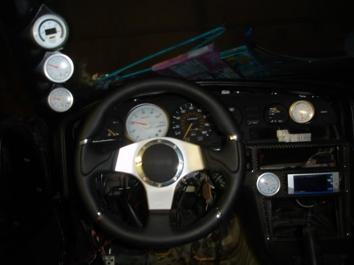

Hard to explain, but here goes: You can see in my photo that I had to use a dremel to cut a plastic ring out of the stock rear steering wheel cover, which has the 3 holes that lock on and turn the turn signal cancelling peice on the steering column. I had to trim the heck out of it and even shave it down quite thin. It had 3 small inner tabs that seemed to line up with the momo hub, but it still required hot glue to get it solid.
For the horn I used the stock black ring with the wire plug. I took it off, cut off the wire plug, and figured out which of the 3 wires was the horn. I then dremeled out a slot so that I could bend up one of 2 the wire tabs through the slot so it would contact the brass area on the momo hub. A fair amount of time and patience with a dremel was totally worth it in the end.
chedderknight said:
what did you have to do to get the horn working?I"m in the process of trying to figure it out

I posted this a couple of weeks ago. It was a bitch to get the turn signals working like stock; the horn too.
Momo Jet, 350mm - ideal size
fine ass wheel !!!!
I like it , it would match the carbon pedals, e-brake, shifter,,,,,,,
my only draw back, is that I still want a airbag !!!!!!!
