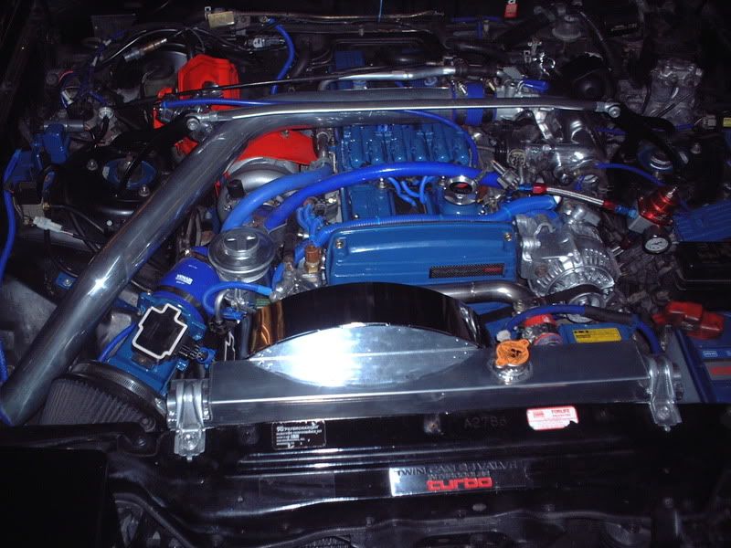

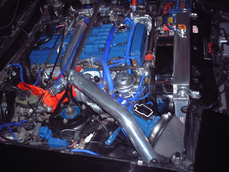

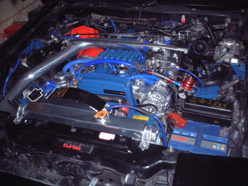

We guys, i have just had my second HG rebuild in as many years. Spent 6 months getting parts and cleaning up what i had. Lots of polishing and painting.
Still have some running problems though.
It won't idle and sounds very rough. Seems like it is drawing in air on the inlet manifold somewhere. Throwing up code 24 as well. I has swapped out the afm sensor but it made no difference.
Anyway i guess we will get it sorted out soon.
On with the pics.

found the problem. One of the egr block off plates was not fitted to the top of the inlet mainfold. Sounds sweet now. simple fix that has had me scratching my head for a couple of days.

Davismj711;1126903 said:
Great looking engine !! Could you tell me about your Fan Shroud ? Looks real good.
Curious about what type of battery that is also.
As far as the EGR, I am with the leave it be crowd ^^
As for the egr the guys that built the motor said that the UK cars had a different set up to the US cars and therefore were not affected by it being removed. Ed also said that he had yet to find a UK supra with a working egr system anyway.
We have very different emission laws over here than you do.
The fad shield only cost around £20 of a guy on ebay selling universal shrouds.
The battery is made by bosch.
