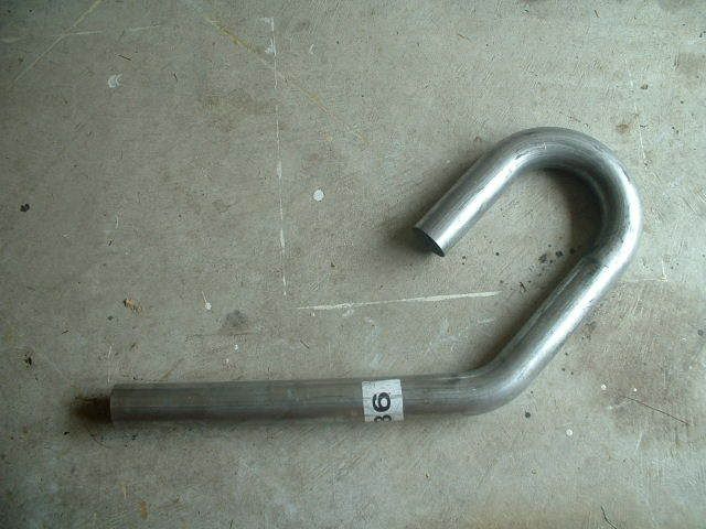

OK, more info I remembered.
The Mandrel bend was bought from ebay. The seller is performance-curve. I just put 'mandrel' in the ebay search and it comes up. They also sell stainless, mine is steel, the cost right now is $26.99 + $15 shipping. I just checked.
The Magnaflow was picked up from ebay too, I can't remember the sellers name, I did this project 8-9 months ago. I just searched ebay now and the best I found is $93 shipped. That is still a good price.
Here's a pic of the bend.
The only thing I can find for this price is aluminized steel. I come up with $240.00 for the stainless steel pieces and the magnaflow muffler. It will probably cost me fifty dollars to have it welded so it's still about $300.00 but not like the $130.00 you paid. Can the aluminized steel be welded by a normal welder or does it have to be welded by something that welds aluminum? Will it also weld up to the stainless steel pipe if I can't find the aluminized pipe?
Aluminized is a coating. its put on the pipe to keep away the rust. a normal welder welds it fine!
