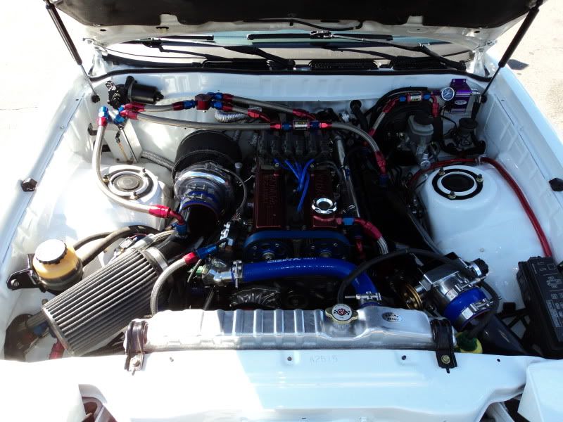

I like my setup works wounders and no boost leak
for fun back when I frist dynoed it and had it running one day I un-caped off my valve covers for fun and it lost power
I may up grade my pcv system off the vavle cover tee to catch can to -12 thou
