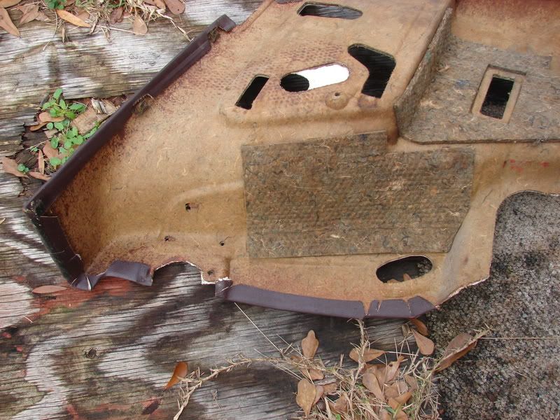

Here are 2 pictures. The first shows the entire area behind the rear panel. I took this one to show that on both the rear and the door panel, they have glued sound deadening pads over some of the clips. You will have to pull those up, and be prepared to either glue them back down or discard them. I'd try to keep them.

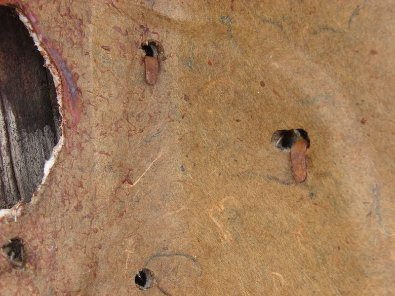

And here is a close up of the clips you can see, to give you an idea.You just bend them out straight, and the panel pushes through. Don;t force anything! If it will not come loose, there is probably a clip still hiding somewhere.
