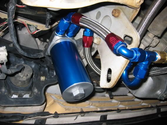

Appears the can separated at the base. Rare but it happens. While I'm also fan of PureOnes the one thing I don't like about them is the thin gauge steel used because it lowers impact protection. Anyway, send it back and see what they say. If it was their fault they'll make good on it
Fwiw never buy a filter without opening the box in store and carefully examining it for defects ie; bad threads, missing ADBV, metal chips, loose or missing center tube, ect. Don't wait until you get the thing home or let it sit on the shelf for a months.

To the OP: How is your filter mount plumbed? Which line in the photo is oil into the mount?

Ok, guess I misunderstood what you were getting at. My bad. The BPV only responds to pressure across the filter media. Otherwise it'd be in bypass much of the time. In this case the filter seems to have mechanically failed at the base plate while under normal pressure.
