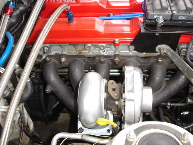

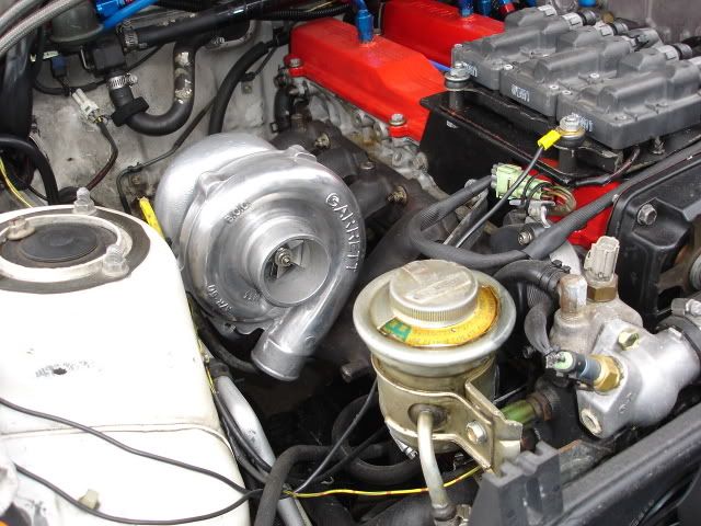

Looks good but unfortunately you wont be able to run that turbo on that manifold, at least not woth out getting a new exhaust housing. Since that turbo has an on center exhaust housing it will hit the shocktower. To remedy this you will need to get a tangental housing. I actually had the same manifold back in the day and ran into the same problem. here are some pics of a kit im putting together right now using the actual HKS turbo that came with the kit. You can see its a tangental housing and its even close to the shock tower.

Its better that he finds out now instead of when he is trying to get the motor in and it wout go because the turbo is hitting the shock tower and frame rail. I remember the frustration when i tore all my stock turbo stuff off to find out the damn turbo didnt fit on the HKS mani and then had to put it all back on in order to drive to work the next day:runaway: thats why im glad i dont DD the supras anymore.
Yeah, I put the turbo on to check the clearance before I pulled the engine, and it does hit the shock tower. But I already bought the T04 flanges and I will be making an adapter to get just enough clearance. Also, did you mean the wastegate is hitting the frame rail? Because that is one of my biggest fears. But according to my calculations it should just barely fit.
